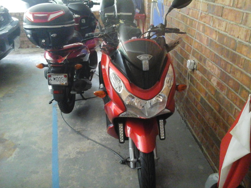

The second addition was some CREE LED driving lights.
The Forza's lights are OK, but like my GL500 the lights are fairing mounted, straight ahead and sometimes leave you guessing in sharp corners.
I mounted the LEDs on the front amber reflector base. I painted the chromed bracket flat black.
The CREE LED driving lights are also on eBay....$40 shipped.
They have both tight beam and broad beam (diffused) by shipping with a different lens/lampccover.
You don't want the tight beam style....the diffused beam still has a concentrated spot of light and is very bright.
The lights are slaved to the accessory circuit in the left box.
I angled them down and slightly out to light up the area right in front of and to either side of the front wheel.
The thing I like best is they move with the forks! :)

Re: Touring Mods
I like those lights. However, since i have a pcx, i wonder if it would draw too much current. I went with some LED lights that Dave recommended.
sendler2112
Posts: 1412
Year: 2013 PCX150
Re: Touring Mods
Post by sendler2112 »
Mel46 wrote:I like those lights. However, since i have a pcx, i wonder if it would draw too much current. I went with some LED lights that Dave recommended.
I think those are conspicuity lights for other motorists to see you. They are not for you to see the road.
There will be no problem adding 36 Watts of lighting to the PCX. The only problem I have heard of from additional current draw was from a user with over 100 watts of heated clothing that was frequently in stop and go traffic.
I think the mounting point of the reflectors on the fender is too low to get a good aim down the road for driving lights unless you are going for a fog light. Or a high beam type of application where you will shut them off at oncoming motorists. I would probably try to mount to the fairing under the turn signals.
