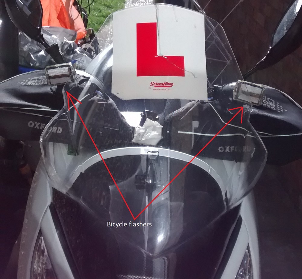

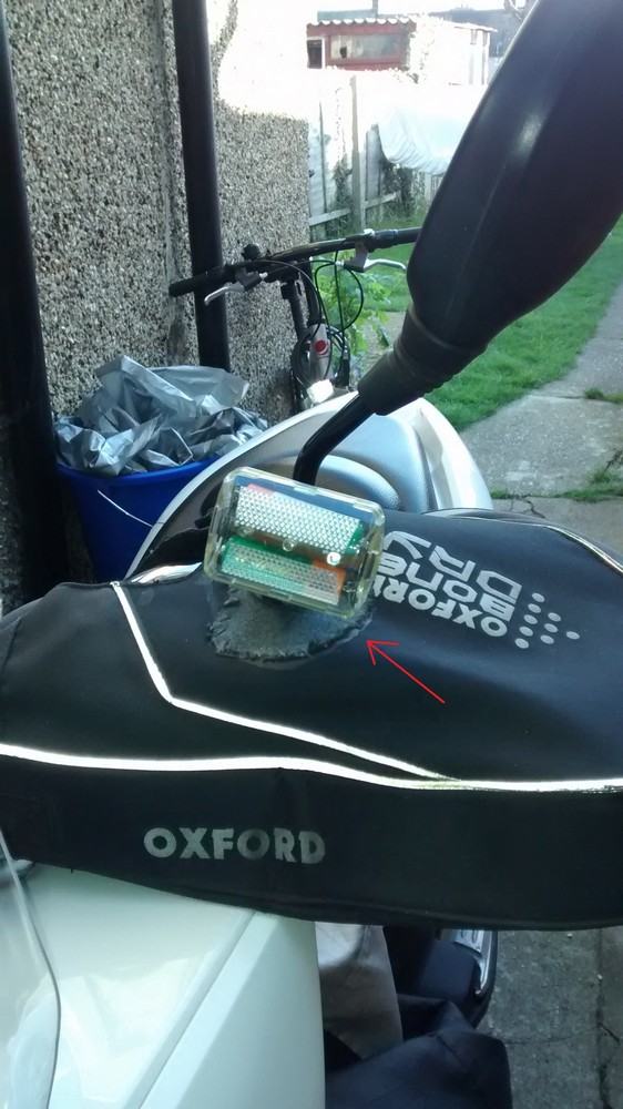

I've come up with these so that I get seen when filtering traffic during rush hour. I bought the cheap ones (£1.00) just in case they are illegal here in the UK. I really hate it having to do so many emergency braking in a 25 miles journey and with winter around it only gets worse.
Front view and side view, attached to mirrors.
2014-10-27 15.15.38.jpg (140.09 KiB) Viewed 3775 times
2014-10-27 12.20.19.jpg (184.8 KiB) Viewed 3775 times

I haven't thought about this option, but I'm sure that it will catch motorists' attention! (the problem here in Spain is that it would also catch Law Enforcement Officer's attention... :roll: :roll: :roll: )
Perhaps if they were solid, instead of flashing, they would be more "allowed" and at the same time would also be noticed by the cagers? ;)

pcxpower wrote:I haven't thought about this option, but I'm sure that it will catch motorists' attention! (the problem here in Spain is that it would also catch Law Enforcement Officer's attention... :roll: :roll: :roll: )
They actually have a flash and solid state mode. So far no near misses :o :o :o
