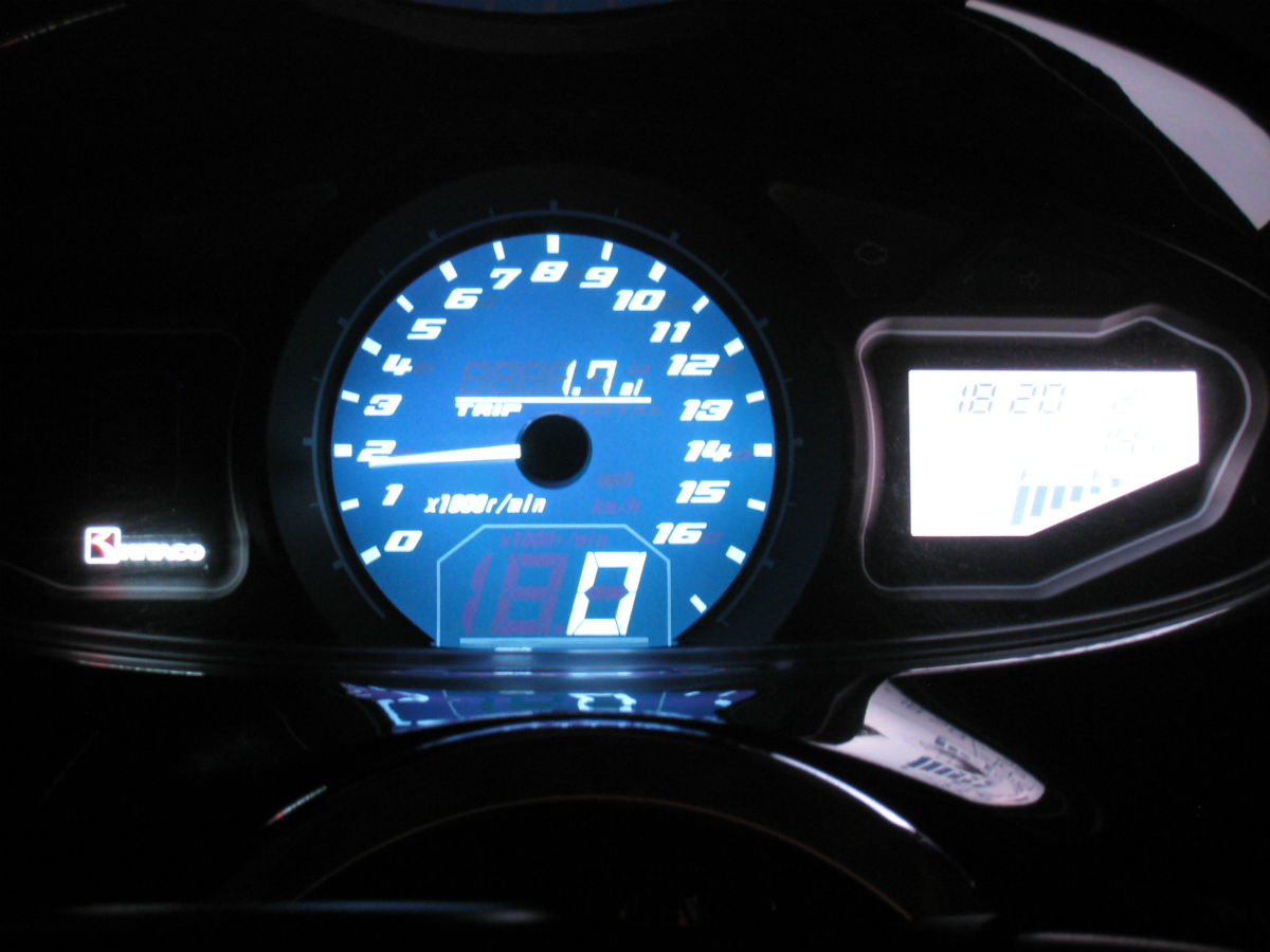

So here is what she looks like installed. Took a few hours to get everything disassembled and reassembled, but I like the results, especially the clock, tach and temp readout.

I like that speedo a lot!Branyers wrote:So here is what she looks like installed. Took a few hours to get everything disassembled and reassembled, but I like the results, especially the clock, tach and temp readout.

Were you able to figure out if the odometer could be changed to match the mileage of the existing one?
Re: Kitaco Speedometer/Tachometer
If it is possible, I have not figured out how to do it. I have English instructions but they are shoddy at best. You can set intervals for oil and belt changes, but I don't completely have that figured out yet. Another thing, it has a standby light that is not working. I am not sure it is supposed to work on US models. The yellow standby light can be seen in this thread:
http://hondapcx.org/viewtopic.php?f=7&t=3125 (Oh hey, that's your thread!!)
Also, I am monitoring ambient temperature and not coolant temperature. Monitoring coolant temp requires cutting the coolant lines and inserting a probe - something a little more involved than I cared to get in to. Perhaps I will do it down the road when I decide to install a big bore kit.
