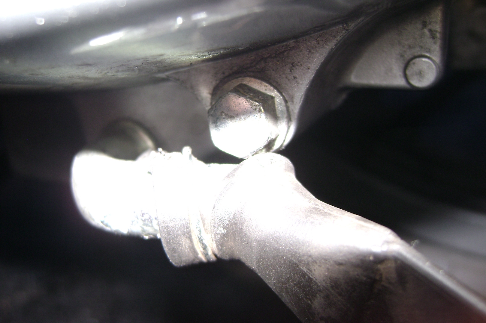

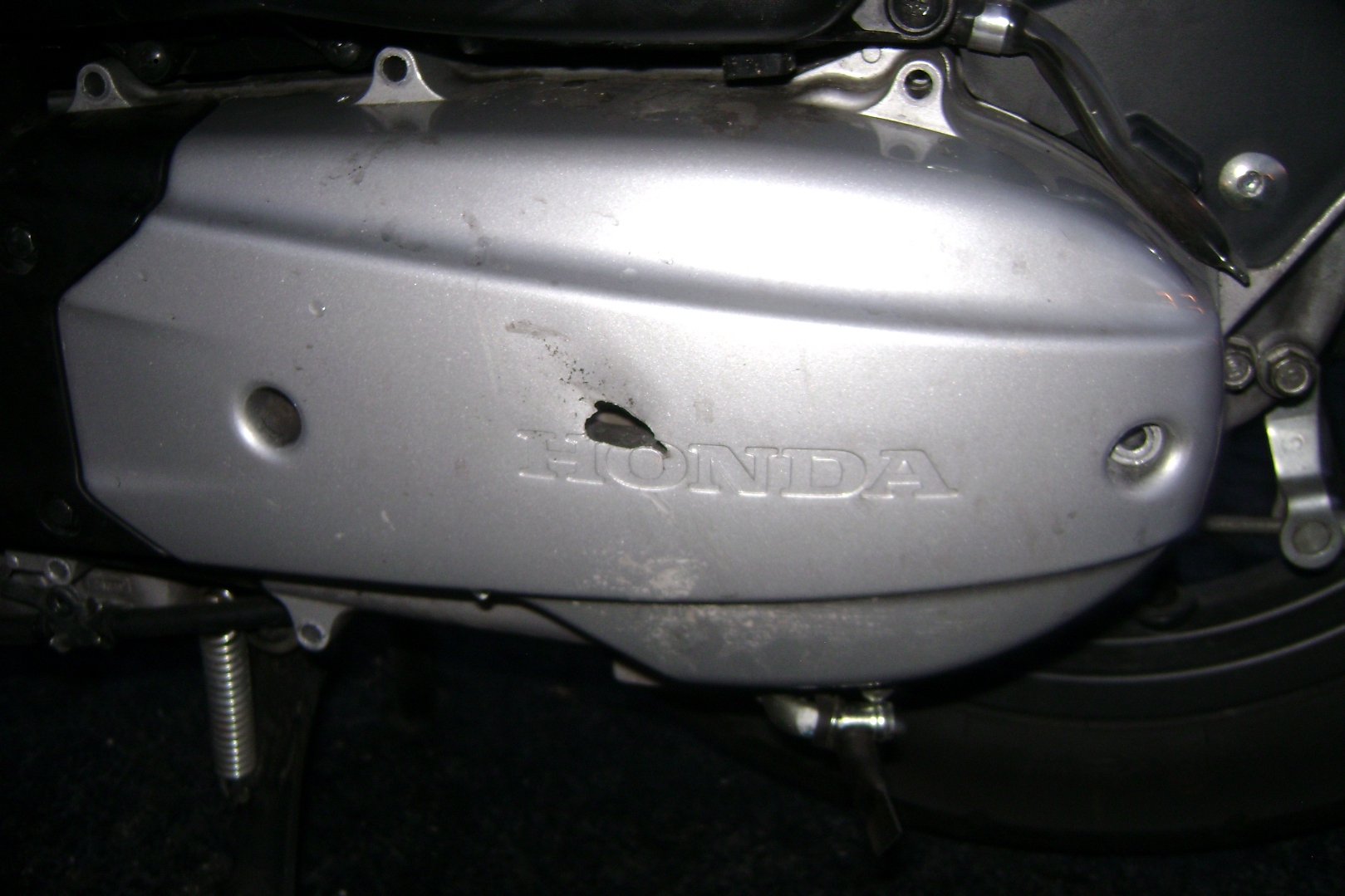

Just figured I would practice on removing panels since I have some free time this weekend. I consider this to be a new hobby of mine, as I would like to learn how to do some of my own basic service consering the Honda dealerships are incredibly slow or just very busy. As you can see, my left side cover for the variator and belt is cracked, among other panel damage from falling off my bike the other day. I belive I can handle the other side panels, but this particular one is giving me the mot trouble. So my question is...how do I remove the bolt as seen here which is the one on the right lower part of the panel (can't fit my socket piece). Also, how do I remove the center bolt (not pictured) that my extended socket wrench piece just will not reach?

The one that's pictured, take the tube off the metal pipe to give more access, if the socket still won't go on try a ring spanner, if that won't go on you need a slimmer tool.
The centre bolt you just need a slimmer tool.

Bought a smaller socket wrench with a 10 inch extender for the deep middle bolt. The lower right difficult bolt is the one I could still not remove, even with the skinniest ring spanner I could find from Lowe's.

To me the metallic part looks damged from the fall.Try taking off the rubber bit. Stick a screwdriver into the metal tube and bend it away from the bolt (downward).
It might help with getting a small 8mm socket in there. Take it slow bending it, if it breaks or cracks the replacement doesn't look like fun.
I just looked at mine and an 8mm small socket fits in there. Good luck

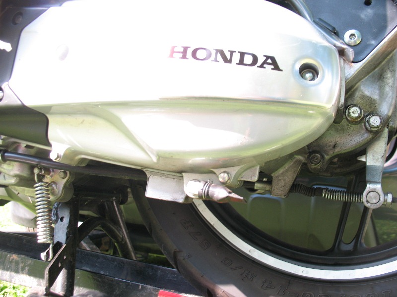

^ My conclusion is the same as Urban PCX's. (by the way, welcome to the forum, Urban PCX.)

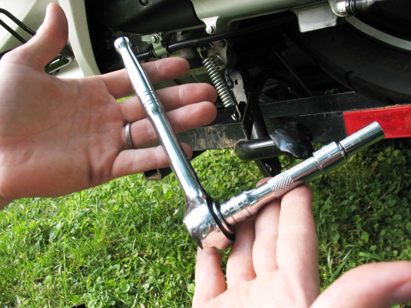

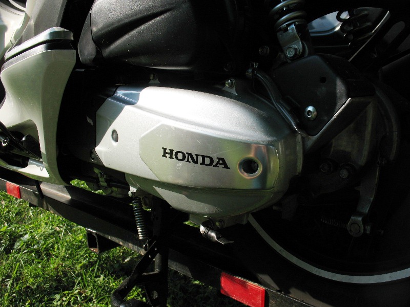

My cover:
From the bottom:

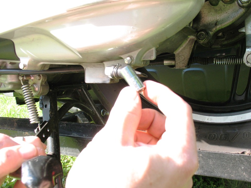

Size 8 Metric socket:

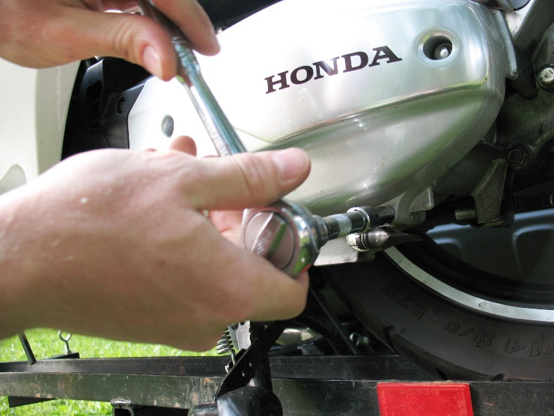

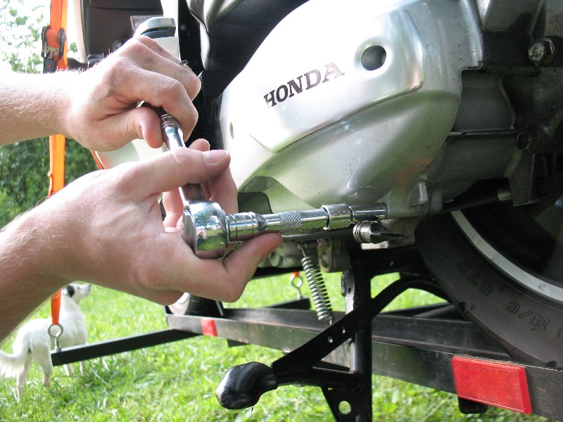

Stick that on a 1/4 to 3/8 ratchet, followed by an extender to give me more room to work:
Making it look easy:
Another angle:
I think the drain tube was bent in your spill, as Urban PCX suggested. Carefully bend it back and use a standard socket to remove.
My cover:
From the bottom:

Success! I bent the pipe back with the screwdriver in the hole, but not too much to damage the pipe or the screwdriver. I was able to move it clockwise a few centimeters, enough to be able to fit my socket or ring spanner. Thanks for all of your help! The support on this forum is amazing, and it makes me happy to be an owner of a great scooter, and in good company with fellow PCX owners on this forum.
