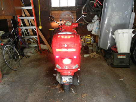

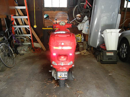

The Bestem top box has a single row of LEDs which are lit as running lights with the key on.
When you apply the brakes a second row joins the above, plus a square on the lid lights up.
No flashing....just a group of running lights and more that come on when braking.

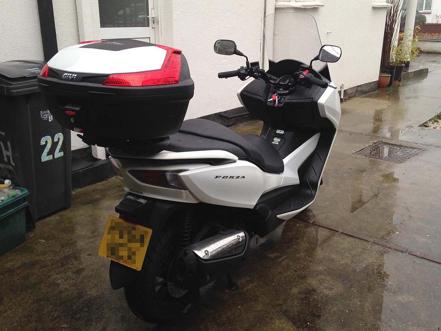

I have just installed a Givi Monokey rack and a Givi B47 Blade on my Forza300. I also bought the optional brake light kit (LED) for Givi Blade and have installed that into the box and the reciprocating connector shoe onto the Monokey rack. That's where I ran out of knowledge and confidence to finish the job. I have the loose wire ends from the connecting shoe in the rack and I have a pair of cable splices that came with the Brake Light kit which I am supposed to splice with the brake light wires.
... So here's my question: How the heck do I get a good clear view at the those brake light wires? What panel/piece of fairing do I have to remove in order to be able to see them?

Not a rude question at all - that's why we're here, isn't it? To share information and experience.
I did a fair bit of shopping around on the internet. Amazon and ebay are usually my first port of call, but the cheapest place I found by far was http://www.fc-moto.de in Germany. Most places were quoting £180 for the basic B47 Blade (just in matt black all over without the colour coded panel) and an extra £40+ for the colour coded panel, and £99+ for the Forza specific rack to mount it.
The Givi B47 Topbox was 175.50 Euros (about £138) which included the white panel to match my bike, and the specific rack for the Forza was 73.90 Euros (about £58). These prices were a head and shoulders cheaper than the next cheapest I could find. Also, the white panel is a perfect match for the Forza white.. it has a kind of pearlescent quality to it in daylight. There is an alternative version of the Givi B47, the "tech" which also comes in white, but the whole lid is made of a matt white plastic which doesn't match the bodywork of the bike so well. Shipping for each was about £6 - £7 which I felt was very reasonable for UPS.
The optional brake light kit itself consistently cost £40 everywhere I could find it, so I just ordered it from Ghostbikes in the UK, because the postage was free. There were a couple of places that were a £2 or £3 difference, but the photos on the website looked like a generic LED kit, rather than the specific one for the Givi Blade. (The proper B47 light kit completely replaces the chromed plastic inserts underneath the clear red outer plastic panel, including the "reflector" bits and the LEDs come already installed into these replacement inserts).
So all in, about £249. I absolutely needed the box for storage, and I travel some dark, unlit forest roads with crumbling tarmac, which are prone to fog in the winter, so when I get the additional brake lights wired in, I'll be a happy bunny. Also considering replacing the stock headlight bulbs for some HID ones. As you can see from the photos, the UK is a grim and murky place in the winter, these photos were taken at about 11am and I had to tweak up the brightness a bit!
I saved a fair bit of money installing it myself, but it took about 4 hours because I was approaching it cautiously, and as mentioned.. I have yet to connect the brake lights of the box to the bike's brake lights, but the wiring is all in place. I noticed that Roman on his website http://www.myhondaforza.com/ got the dealer to install his Givi rack and topbox and they charged him for 3hrs labour. Sounds about right.

- This is my new Givi B47 Blade Topbox with colour matched panel and brake light kit (as yet not fully wired in).
- IMG_3300a.jpg (147.16 KiB) Viewed 8722 times

Hesitating to put a box on my Forza for 2 reasons: I like the look of it without the box; and not sure I could get off the scoot with that box back there without knocking it over!
My other scooter is a step through Kymco, so I added this Bestem for the lights mainly - as the scoot came with a smaller OEM box.
Here it is with the key on....as a running light.
And with the brakes applied. Very bright at night.
