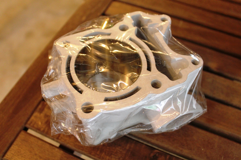

A close-up of the cylinder. This is a Takegawa kit, and seems higher quality than the stock Honda components. Again, note that this kit is DIFFERENT than the one for the 150s and 125 eSP, because the cylinder and head is different for those revisions. This kit will ONLY work on the original 2011 Honda PCX revision 1.

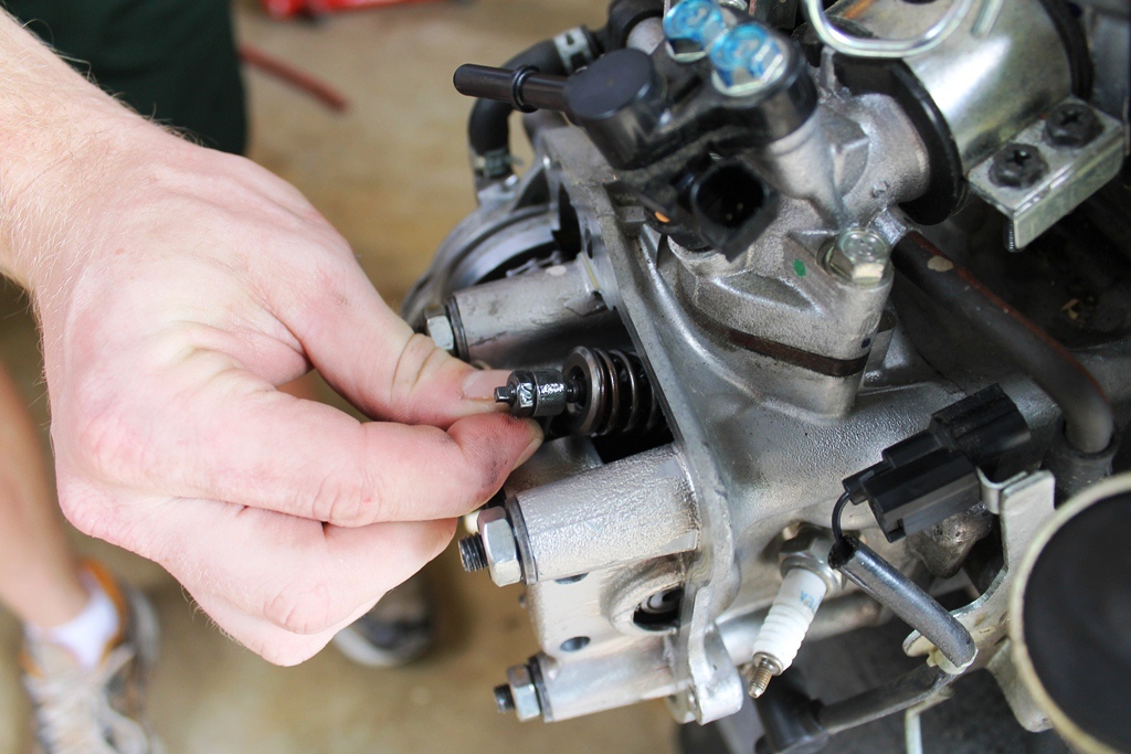

At this point, the piston is in top dead center, but you need to make sure the valves are fully closed. To check that, remove the valve cover. Start by popping off the hose on the top, then remove the 3 bolts.
Wiggle the rocker arms on top of the valve springs. If they are solid and don't move, you must rotate the fan another 360 degrees because the engine is on the wrong part of the stroke. Rotate the fan around and check again. The rocker arms should have a bit of wiggle. Again, YOU MUST HAVE SOME WIGGLE. Seriously, double-check. If you don't get this step right, your engine may meet your piston during disassembly, which would basically be like setting off a small grenade in there.
When you're triple sure your engine is at top dead center (did you check again? WIGGLE THAT ARM!), remove the water pump and the hose with it (5 or 6 bolts total for the assembly):

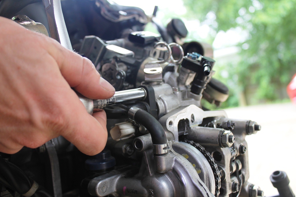

We need to get the FI system off of the cylinder next. Unbolt the two bolts on either side of the injector and pull the whole intake system (injection, throttle body, and air filtering system) back up and away from the cylinder:
On my PCX, there was a spacer with an o-ring, and an o-ring. Make sure you don't lose either.
The spacer goes o-ring side down towards the cylinder:
And the o-ring stayed attached to the intake setup, as shown below:

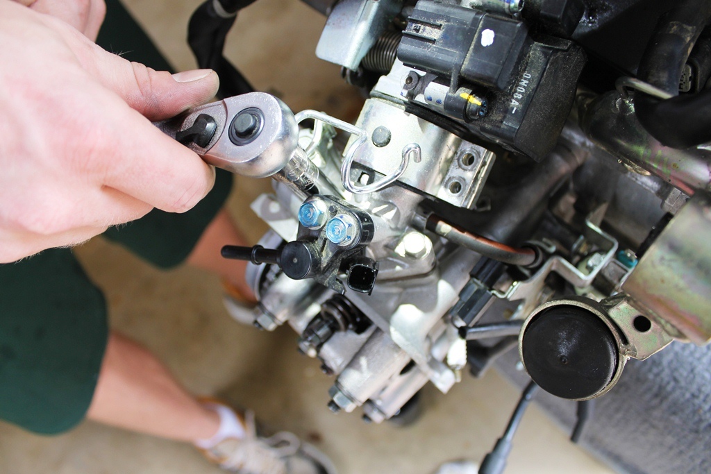

Speaking of the intake system, it's time to change the injector. When you upgrade to a big bore kit, the FI system can only compensate so much with the stock injector. Upgrading to one with bigger jets allows more fuel in, allowing the engine to use that extra displacement for more power, and preventing a lean condition from having too little fuel combusting in the chamber.
The injector is held on by the two blue bolts. Remove them.
The bottom side of the injector, removed.
Pull the injector out of its mount, click the new one in, and reinstall. Make sure the new one has the same thick sealing o-ring as the original. Reinstall the injector in the intake system, but leave the intake detached.

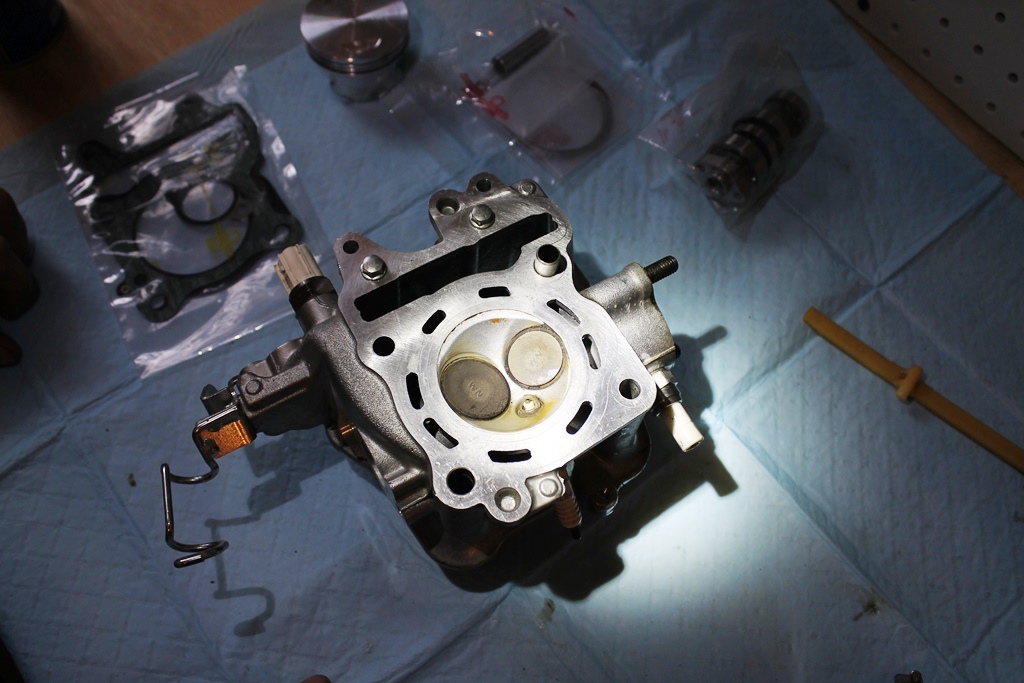

Take the head and cylinder over to your lab bench, where you have a nice clean pad to work on. Gently separate the head from the cylinder. There are a couple of little connection studs, make sure they stay with the head.
Below is the head, with the cylinder removed. For this kit, the cylinder gets replaced, but the head gets reused. Some kits replace the head too, and I kinda wish this one did as well. More on that later. You can see the valves closer up in this picture. The big slot at the top left is where the cam chain goes. In case I haven't mentioned it yet, the cam chain drives the camshaft, which opens and closes the valves at the right timings to get a good explosion contained to propel the bike forwards. The 8 oval-shaped channels around the cylinder area are the channels for coolant to flow. Everything here is dirty, and you can see there's coolant and bits of gasket on the head. ALL that needs to be clean and smooth to get good compression with the new gasket, so it all gets cleaned up.
Polish that head! Getting cleaner...
Shiny enough.
Check the new gasket for fitment. Mine blocks some coolant passages partly. This was my concern, and the reason I said I wished the kit came with a new head. :? It's fine 3k miles later at this point, so I'm confident this is good enough. Note the two connection stud thingies in the top right and bottom left. These sometimes come off with the cylinder, so make sure they end up with the head.

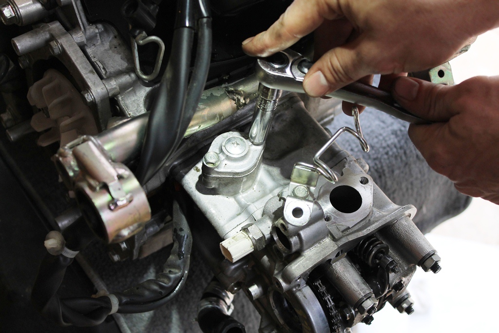

Flip that head over again, and remove the two retaining bolts for the water pump collar:
Remove the bolt securing the camshaft. You can see the two cams and cam rollers at the top of this pic. The two rollers should look perfectly smooth, with no grooves. The cam chain rotates the cam shaft. The lobes on the camshaft roll, with the elevation changes opening and closing the valves in the engine at appropriate times so that air gets in, compresses, stays in to go boom, goes out, and then new air comes in. An aftermarket cam increases the time the valves stay open, sometimes having the exhaust and intake valve open for just a bit of time so that more air gets sucked in. More air = more boom! The caveat here is, engines like the PCX's are interference engines. They have 4 strokes (hence the name), which correspond to the 4 appropriate aforementioned times. If the valves stay open too long, they will actually hit the piston, turning your engine into an expensive paperweight. Anyways, I'm rambling...
You'll also have to detach the rocker arms that go to the valves, so loosen these two bolts too.
And remove the two bolts the arms pivot on:
Wiggle that camshaft out!

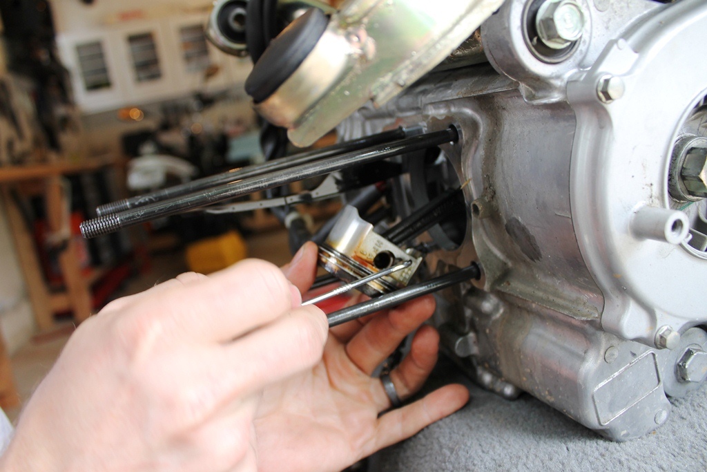

Go back over to your engine, and get a pick in the hole on the side of the cylinder to pry out the circlips. You have to remove the circlips to get the piston's pin out to get the piston off the conrod. The circlips are a bitch to remove, good luck!
Yup, still picking away. Get a beer or two and walk away if you get frustrated.
ALMOST!!!
Now, GENTLY push out the piston pin:
The old piston, removed:

Ok, so time to rant on this... The cam chain tensioner is just that -- it tensions the cam chain. Behind that hole on the top of the cylinder is the upper cam chain guide. The cam chain tensioner is a fancy wound spring that puts constant outwards pressure through the springs, but is unable to retract, ensuring consistent tension on the chain. That means your tensioner right now is locked fully outwards. If you press on the part to the left, nothing happens! Madness! The stock Honda tensioner tool, which is a $100 screw and nut, are designed to hold the tensioner in exactly the position it was in when removed to allow easy reassembly. Well, $100 is ludicrous for a tool that you'll use once. Remember this picture?
In it, you can see the cap over the tensioning screw. It will be factory overtightened. Remove the cap in the middle of the top of the cam chain tensioner. You may have to use an impact gun (I'm not kidding).
At this point, you can see the middle of the tensioner, including a tiny little winding screw in the middle. The tensioner uses a helical spring, which you can rewind to retract the tensioner! WOO! Ok, I'm getting too excited (but seriously, I figured this crap out and it saved me $100 on the stupid Honda tool, and might save you that too). Stick your tiny screwdriver in there, and tighten it. The tensioner will wind, and the rod holding the tension on the cam chain guide will retract, as you can see below:
Now, the only problem is, the SECOND you remove that screwdriver, the tensioner fully extends, ruining all your hard work. So either grow two extra arms, or find a friend. Whilst holding the tensioner in full tension, bring it over to the cylinder. Have your friend install the new gasket for the cam chain tensioner, and, still holding the tension, place it in place. KEEP HOLDING THE TENSION FULLY while your friend tightens the tensioner into place. The only thing the Honda tool is for is allowing you to solo this part. Tis silly.
Here's what it looks like, me holding tension like a boss and installing it in the PCX:
Once it's fully seated and tightened, slowly let the screwdriver unscrew as the tensioner seats. It shouldn't unscrew too far, it should only unscrew a bit. If it unscrews as much as it took to screw to retension, something is very wrong with your cam chain or tensioner.
Put the valve cover on, putting a dab of sealant at the corners of the water pump (the valve cover is prone to leaking there). Make sure you don't overtighten. The post-2011 PCXes have 4 valve cover screws, but this one only has 3, so if you mess one up, you're going to have a bad time. (as an aside, I accidentally broke one of the valve cover bolts on Mel's wife's PCX. It doesn't leak at all, so the 4th is important, but not needed, on the post-2011 PCXes).
Start connecting everything. Connect the electronics, throttle, and fill up coolant. Somewhere in there I also hooked up the radiator hoses to the new cylinder and everything else. Just reverse the reassembly. Make sure no connector goes unconnected.
Make sure you hook up the throttle cable right. I didn't, and nearly went for an involuntary ride around the neighborhood when it ROARED to life the first time.
