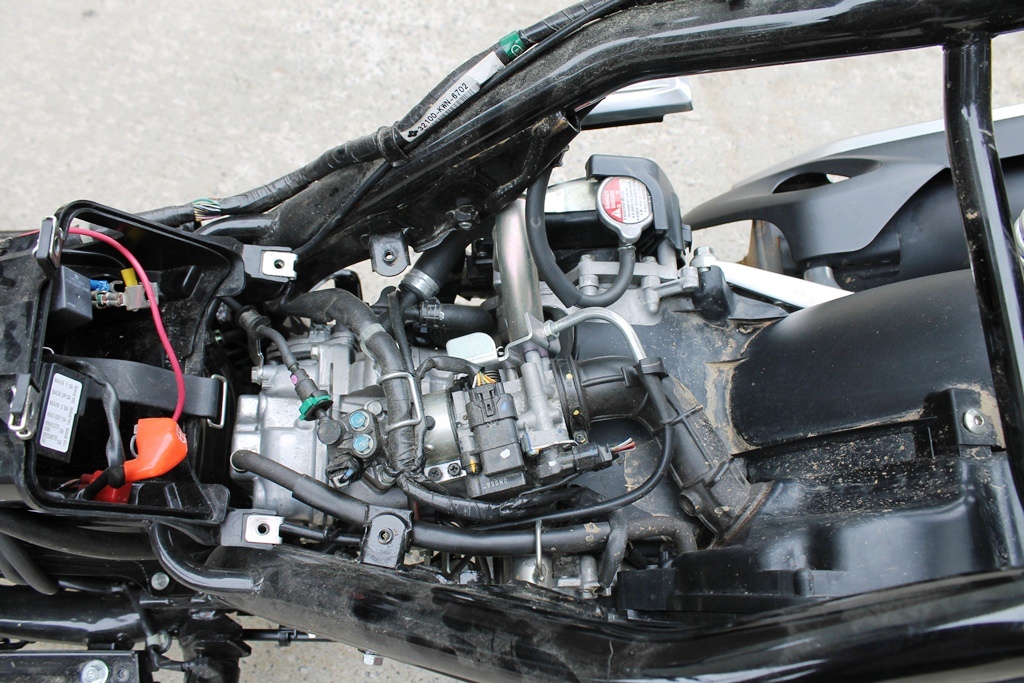

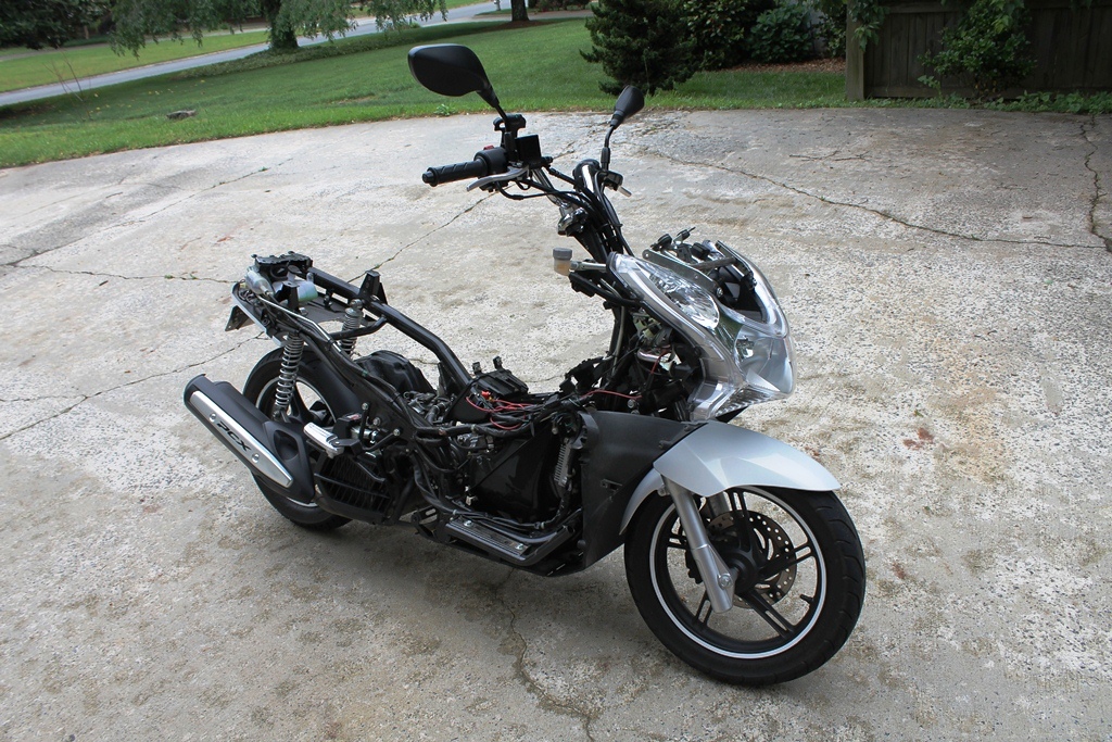

Here's my PCX, completely naked:
Some close-ups on the engine area, for reference (in case they're needed for reassembly):

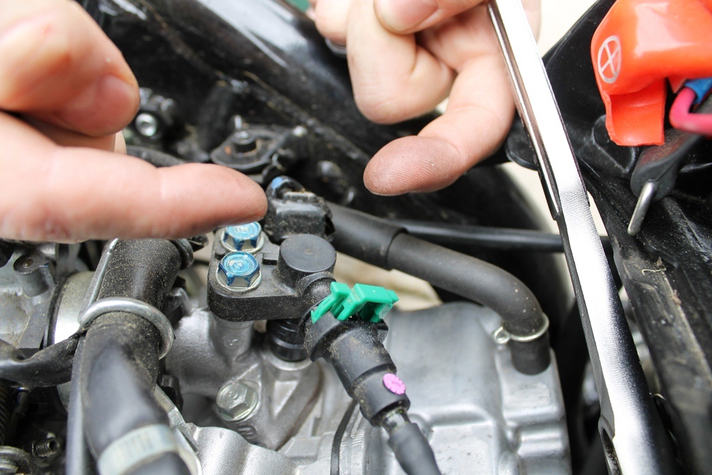

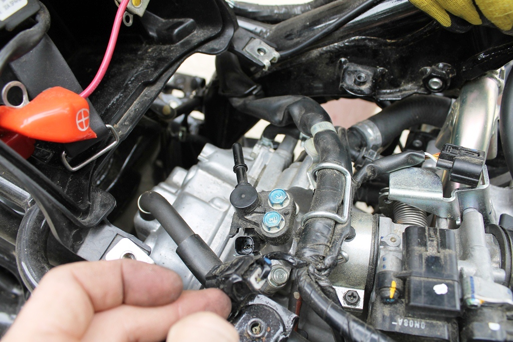

The injector sits at the front of the engine, and has a tube from the fuel tank running to it. Push the clip in, pry up, then pull off.
Disconnect the fuel line at the bottom:

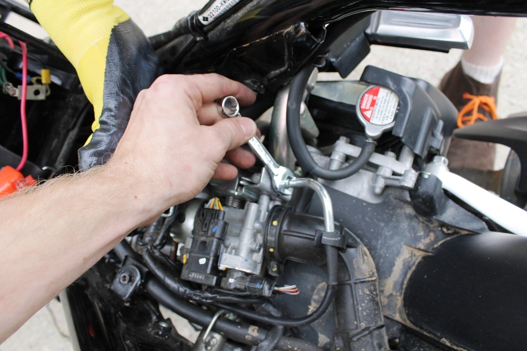

Disconnect the throttle cable, on top of the engine. You'll have to unbolt it from the retention clip, then rotate the cable out of the circular armature on the throttle body.

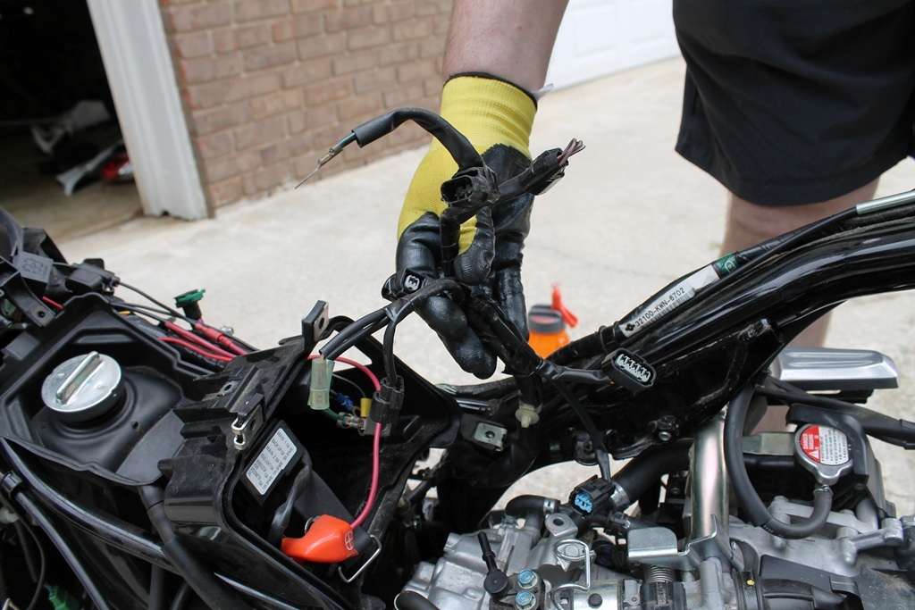

Remove the main wiring harness from the FI system:
Unplug the speedometer sensor cable (behind the airbox):

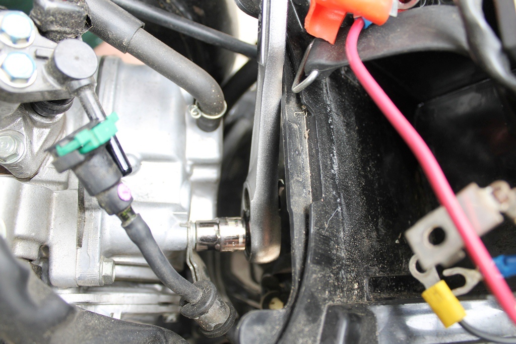

Unbolt the ground wire in front of the airbox (I'm pointing to it):

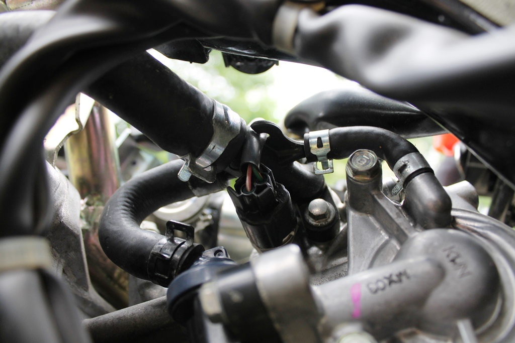

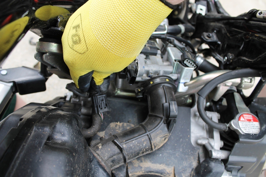

Unplug the injector:
Unplug the plug near the water pump for the thermostat. The wire here is REALLY tight, so be careful. The water pump is on the right side of the bike, and this picture was taken from the ground looking upwards.
Unplug the harness from the ECU. This is all the way up at the front of the bike, between the gas tank and the front wheel. You'll have to unclip this wire from its retainer clips that go back to the engine too.

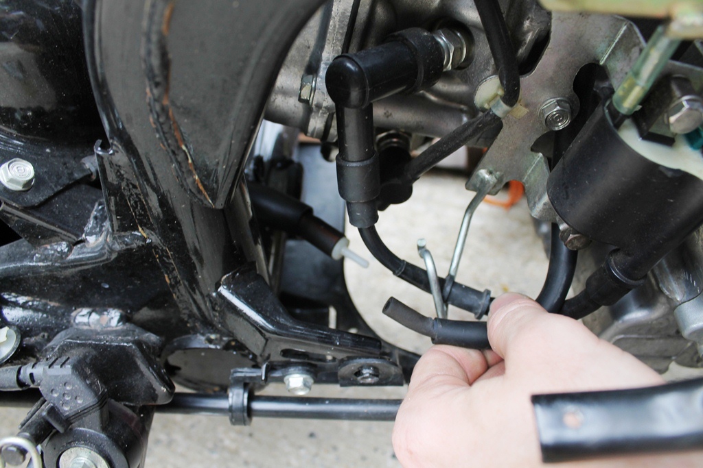

Unplug the ignition coil and the plug on the top of it (this is on the left hand side of the bike, note there are 3 connections being unplugged in this pic):
At this point, you should have this nice wire spaghetti of a harness detached from the engine itself:

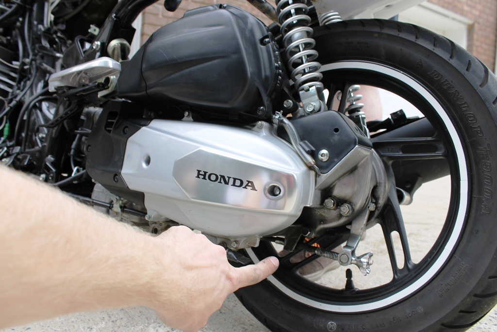

Unbolt the rear brake, and undo the bolt holding the cable on up at the front of the drive cover:

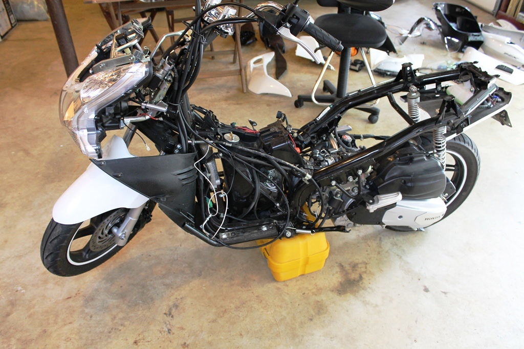

If you have a centerstand, put the bike on its centerstand. My steed doesn't have a centerstand (removed due to grinding in turns and the defective crankcase issue with the 2011s), so I propped mine up on a box:

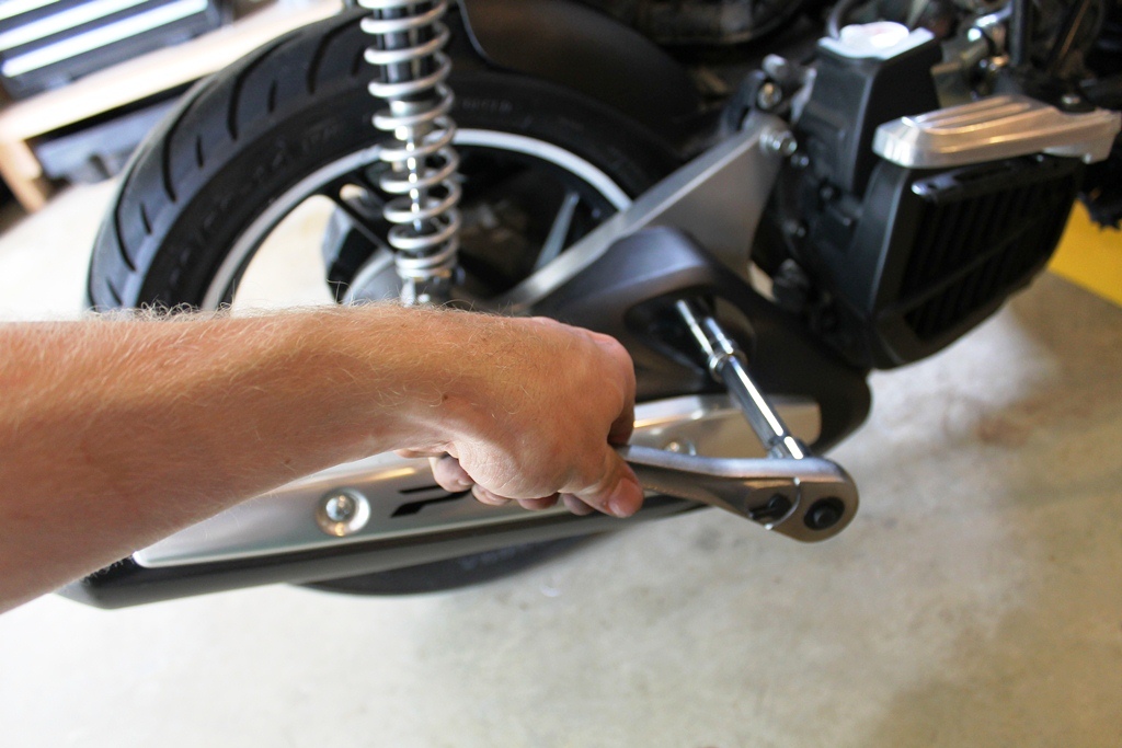

Start removing the exhaust. There's two bolts holding it on at the bottom, you can see one in the below pic (big silver with round head):
And remove the 3 nuts holding the exhaust itself to the right swingarm, then pull the exhaust off:

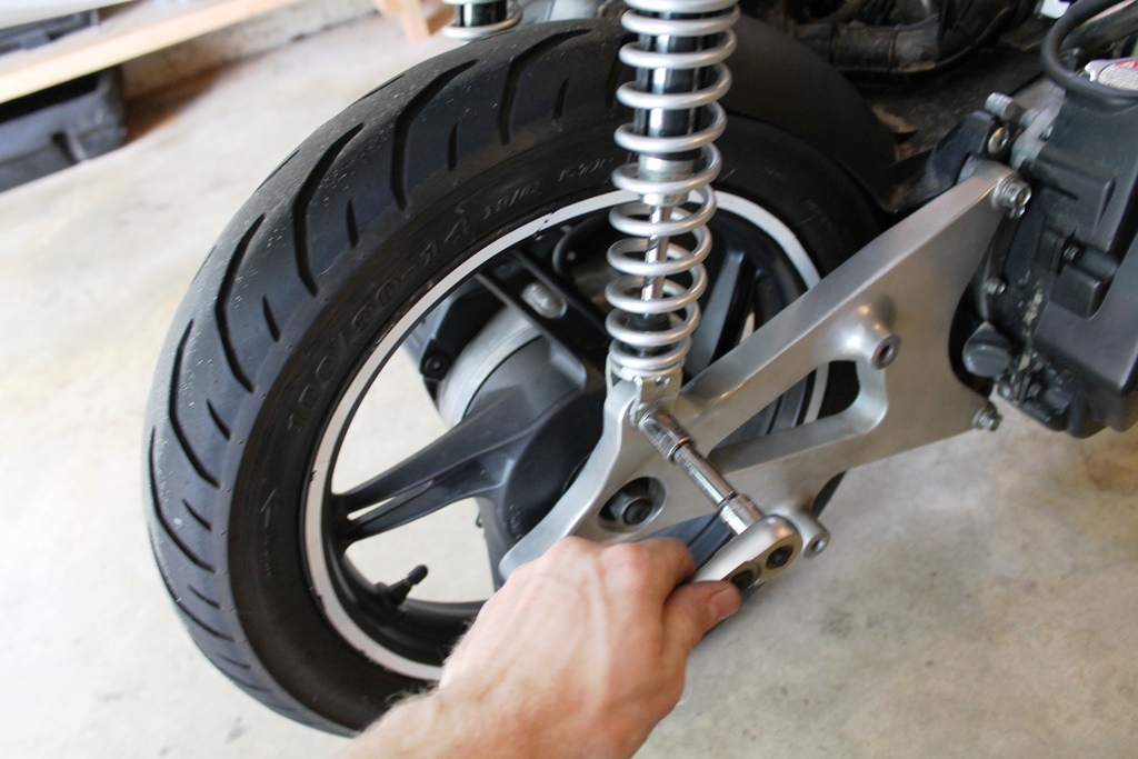

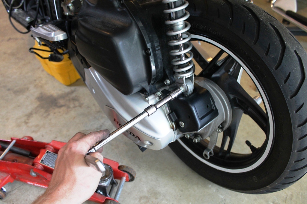

Remove your suspension next. You may want to hang the rear of your bike from the ceiling at this point, or just be ready for the rear end to flop down when released. There's a bolt on the left and a bolt on the right.
Right side:
Left side:
Swingarm dropped, bike hanging from ceiling. I have an aftermarket undertray, I just left it on. Your bike will have the mudflap already removed from earlier disassembly:

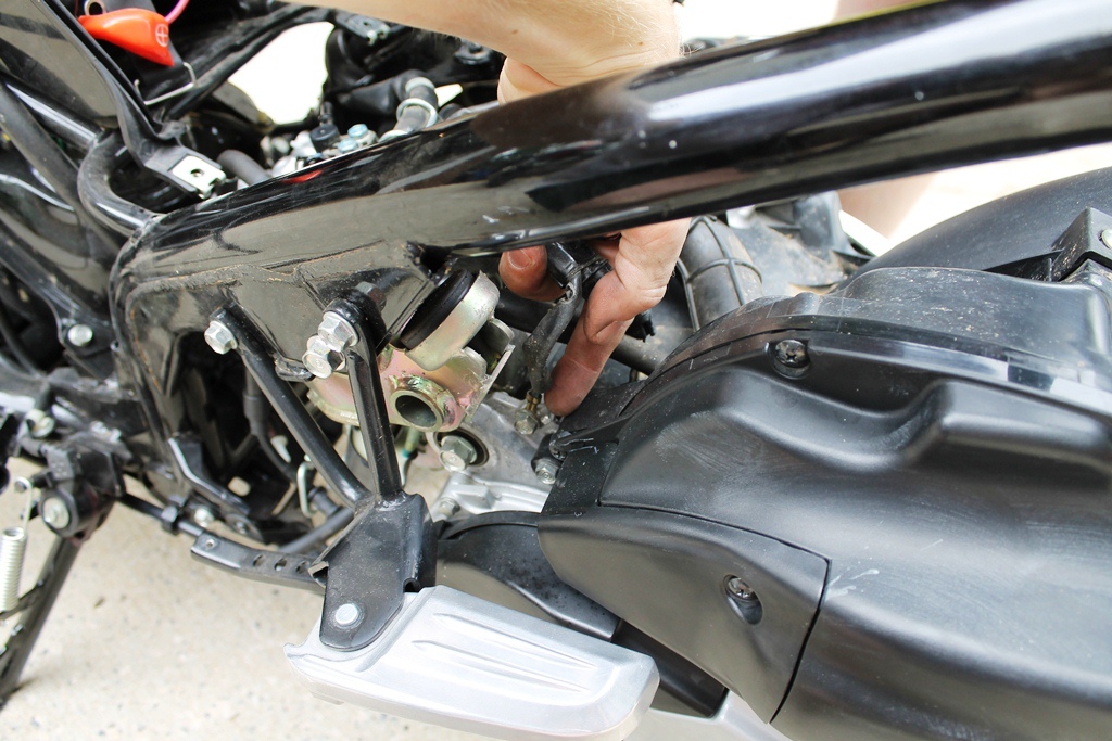

At this point, the PCX is ready for the engine to come out. All that's holding it in place are the two main mounting bolts. Put your floorjack under the engine (on a flat part, don't mess up anything) and get it supporting a bit of weight. If you don't have a jack, that's fine, you can just chock it underneath.
The engine mounting bolts are between the passenger footpeg supports; one on each side. Loosen both, then remove both while keeping engine and frame supported.

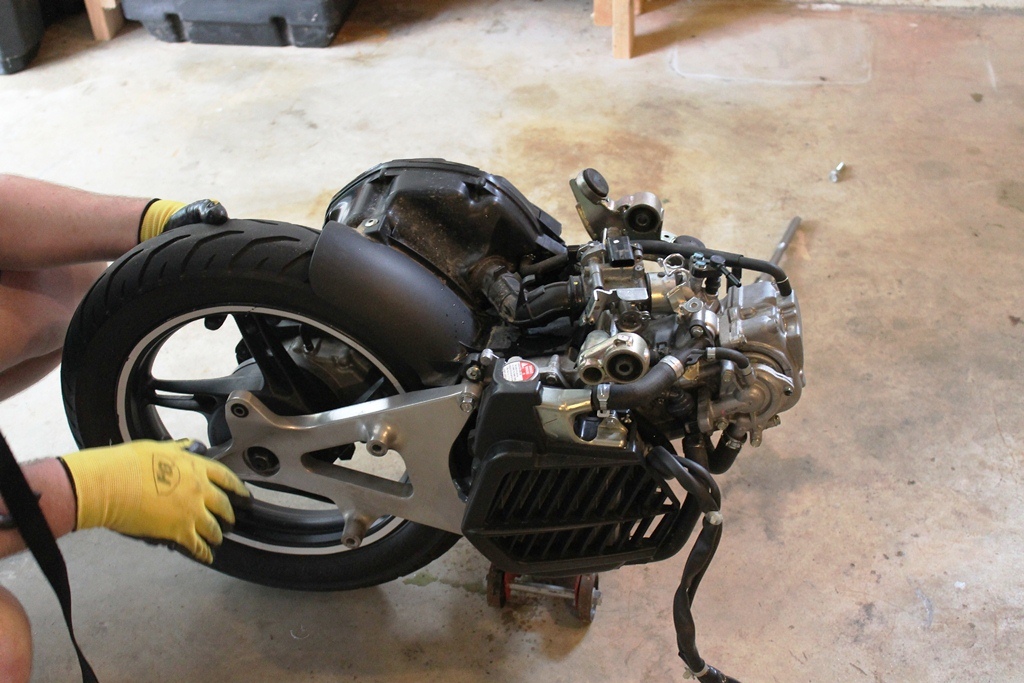

Here's where having two people makes a HUGE difference. I lifted the frame of the bike, and Freedog dropped the jack and brought the engine back and clear of the frame.
The engine assembly, completely removed:
