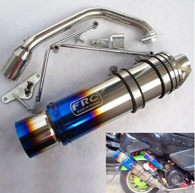

Yeah i'm about show rather than go, i've been offered this for £60 inc shipping.

by dasshreddar
Yeah that will work... gy6 150 headpipes are a bigger diameter than the pcx 125/150.
So you will have to just weld the two headpipes together. 8)

To sound stupid... What's s headpipe? Can i just cut the two pipes (say jusy by the reducer bit and weld them together?

by dasshreddar
headpipe aka header is the pipe that goes from the muffler to the engine head.
so you would need to use your stock headpipe(most of it anyway) and attach the new exhaust(with a little bit of the new headpipe) together.
here is mine with almost all of the stock headpipe welded to the new exhaust(which only had about a inch of headpipe on it).
your just connecting pipes together... where exactly ? I don't know? what ever looks best.

by dasshreddar
you would most likely have to cut the new pipe around this area.
hope that makes sense.

by Urbanfreestyle
Ah ok i see now! so i can do as you did and cut at the bulge in the end of the header pipe as you did. Do you know the dia of the standard pipe?
I think i may also have to make some kind of bracket up too?

by dasshreddar
yeah mount the exhaust first wherever you like, then figure out how you're going to join the two pipes together.
the new headpipe should be slightly bigger diameter than the stock one so you may not need a reducer.
the bulge on the new one is definitely bigger than the stock headpipe so that should work also.
yeah do it like mine, that may end up being the best way???
