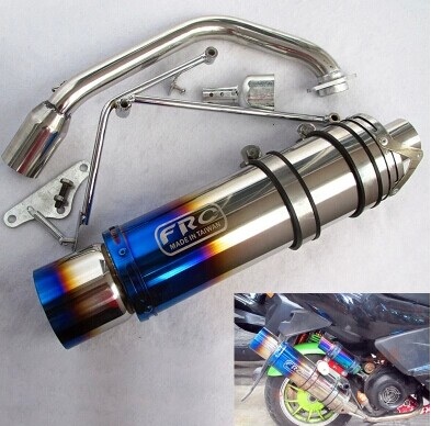

engine codes?Urbanfreestyle wrote:So i know the ruckus is a gy6 or at least often has a gy6 engine put in it, would any if these parts fit the pcx?
I'm specifically looking for cheap exhausts,
any gy6 exhaust(or any other exhaust for that matter) can fit on a pcx, I have an atv exhaust on mine
but it will need to be welded on and some sort of bracket/hanger should be figured out.
I know you're all about the bling... many of the gy6 exhausts (ebay etc.) are plenty blingy and cheap
here is one. $80 ebay...
- gy6x.jpg (7.97 KiB) Viewed 6154 times

Yeah i'm about show rather than go, i've been offered this for £60 inc shipping.

Yeah that will work... gy6 150 headpipes are a bigger diameter than the pcx 125/150.
So you will have to just weld the two headpipes together.

To sound stupid... What's s headpipe? Can i just cut the two pipes (say jusy by the reducer bit and weld them together?

headpipe aka header is the pipe that goes from the muffler to the engine head.
so you would need to use your stock headpipe(most of it anyway) and attach the new exhaust(with a little bit of the new headpipe) together.
here is mine with almost all of the stock headpipe welded to the new exhaust(which only had about a inch of headpipe on it).
your just connecting pipes together... where exactly ? I don't know? what ever looks best.

you would most likely have to cut the new pipe around this area.
hope that makes sense.

Ah ok i see now! so i can do as you did and cut at the bulge in the end of the header pipe as you did. Do you know the dia of the standard pipe?
I think i may also have to make some kind of bracket up too?
Nice Rukus / PCX hybrid there!

yeah mount the exhaust first wherever you like, then figure out how you're going to join the two pipes together.
the new headpipe should be slightly bigger diameter than the stock one so you may not need a reducer.
the bulge on the new one is definitely bigger than the stock headpipe so that should work also.
yeah do it like mine, that may end up being the best way???

Thanks! i think on pay day i'll get a pipe ordered (may be a different one) i'm conserned i want more bassy note and silly to look at haha! may have to steal the 3 inch one off the back of my wife's subaru!

There is no way I would order a new pipe ($) that doesn't fit the PCX and cobble it together on a brand new bike.
IF you insist on swapping out the muffler, order one that is made for it.

You're right i don't know it by that name, i'm more used to cars where you have a manifold, downpipe, centre section and backbox. I would be having someone do it for me with my direction as i don't know how to weld. I will consider saving for a full system though, that way i know it wont (shouldn't) break
