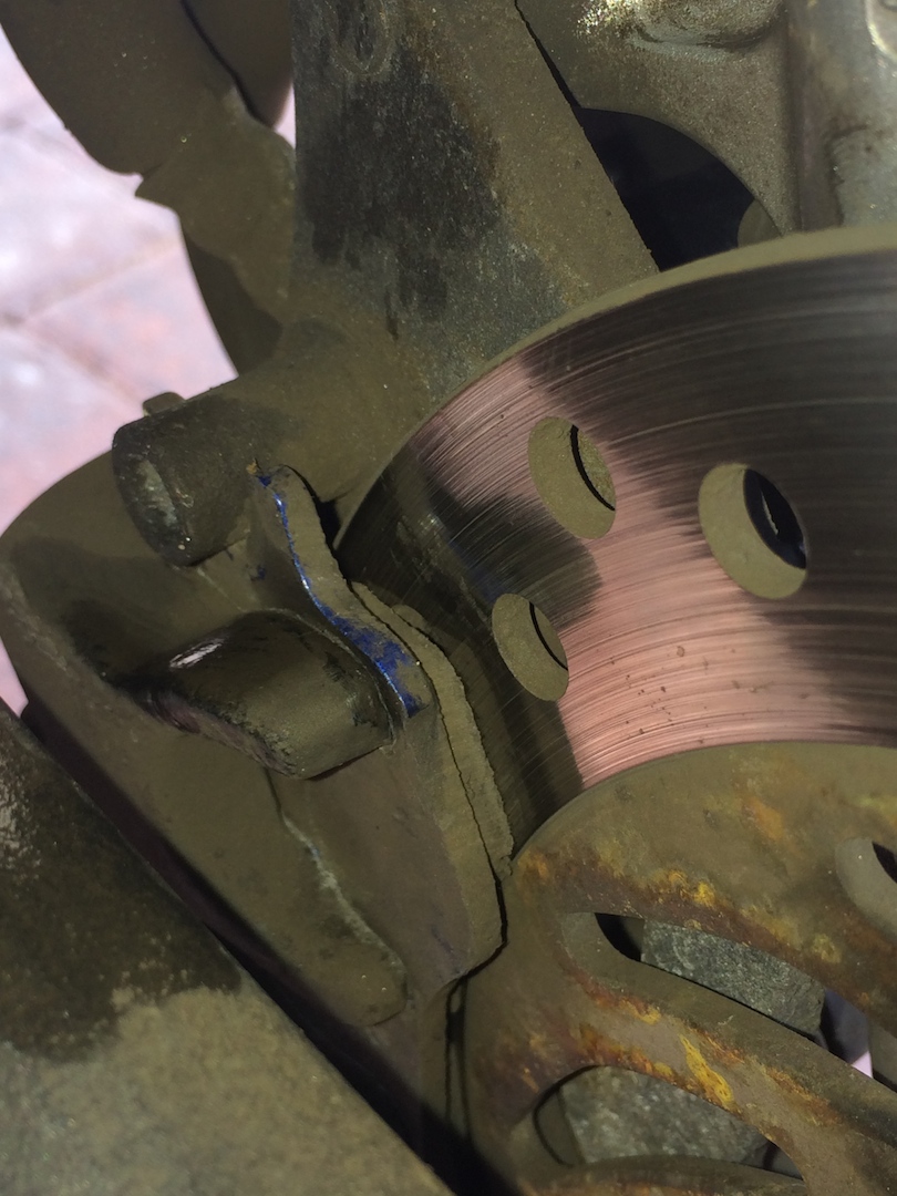

Hey,
Only had this Bike just under a week now,
just wondering whether these Brake Pads are ok or need replacing?
I know on my previous Bikes there's been a little more meat on them,
looking on these they look abit thin to me,
but im not sure what they're like originally.
Shall I replace them now? or wait a few more miles, or......?

You should be able to go down to 1/2 of that material thickness, as long as you don't go down to the metal backing plates.
Why are you wanting to replace these pads so soon?

They look ok for a while yet. It doesn't do any harm to strip and clean them occasionally to stop them seizing.

They appear less than half worn to me. You have a lot of miles left.

There are wear indicators for both front and rear brakes; the front ones have a line drawn on the pad, and the rear ones have a mark on the actuating lever at the rear (check it with the brake engaged). Both are mentioned in the user manual.
My bike is at 32,200km and still on original pads with plenty of wear to go.

Still okay, but maybe a bit of cleaning will do.
