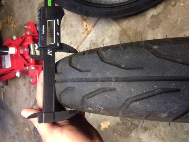

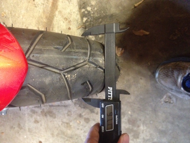

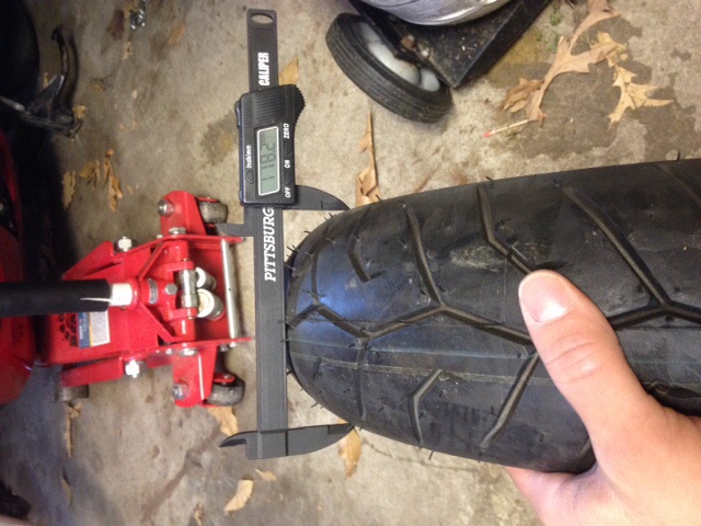

Mgalutia88
- Posts: 783
- Year: 2013 PCX 150
Re: Pcx Max tire size front and rear?
Here are the pics I promised.
- New front installed
- image.jpg (98.76 KiB) Viewed 18269 times
- New front
- image.jpg (111.99 KiB) Viewed 18269 times
- Origional front installed.
- image.jpg (102.67 KiB) Viewed 18269 times
Tribpreper
- Banned User
- Posts: 115
- Joined: Sun Jun 08, 2014 8:02 pm
At slight lean angles the bike will feel 'tippy' but as lean angle increases the effect will not worsen. Oversteer will be a serious problem so be careful. On the Interstate, with the contact patch now shorter relative to the width, the bike will feel like you are riding on square tires and side wind effects will be dramatic.
Increased rolling weight will lengthen stopping time and distance.
Increased wind resistance will likely increase fuel consumption. On a Triumph Rocket III the effect would not be measurable. On a bike with 13HP it will be.
The narrowest wheel a 140 profiles for is 2.75. On the PCX150 the 1.85 front wheel pinches the profile sufficiently as to make a blowout....uh...imminent.
You must have mounted the tire yourself; it's hard to believe any shop would have done it.
Still, an interesting experiment. I'll wager you'll have that 140 off in a week - by choice or not.
Mgalutia88
- Posts: 783
The 140/70-14 will go on the rear. Multiple members have mounted them. I put a 120/70-14 on the front an had it mounted by my local Honda dealer. You misunderstood.
Mgalutia88
- Posts: 783
Hey everyone, the GAP seen in the first picture is actually lined up wih the outter profile of the tire. It's just not visible wih my cell phone camera.
