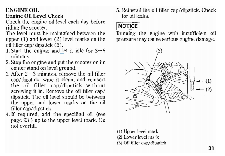

Ed
just a quick note you need to check the oil cold and on the level,straight after a ride will not give you a reading......

trigg123 wrote:Ed
Manual says complete opposite, at least 3 minutes idle running with scooter on main stand and then wait another few minutes and then check. This (and this time I mean it!) is the last vehicle I buy with such a BS convoluted way of checking the oil. If I can't check it with in the morning, cold, just by reading off the dipstick or checking a glass, I'm not fucking buying it!

Re: Loosing oil.
Post by trigg123 »
fiah, i didnt know that,but seems ridiculous,as that cant be a correct level if the oil is around the engine,ive never checked oil in any other way in my life....

Re: Loosing oil.
Post by Fiah »
trigg123 wrote:fiah, i didnt know that,but seems ridiculous,as that cant be a correct level if the oil is around the engine,ive never checked oil in any other way in my life....
My motorcycle has a dry sump (separate oil tank), with the dipstick in the oil tank (not the sump). The only way to check the oil with any accuracy is with a warm engine, leaving it idle for 3 minutes then immediately checking the oil. If you think that sounds like a hassle, imagine my disdain when I found out that the procedure for the PCX is even worse! And to think that Honda says that you ought to check the oil before every ride..
