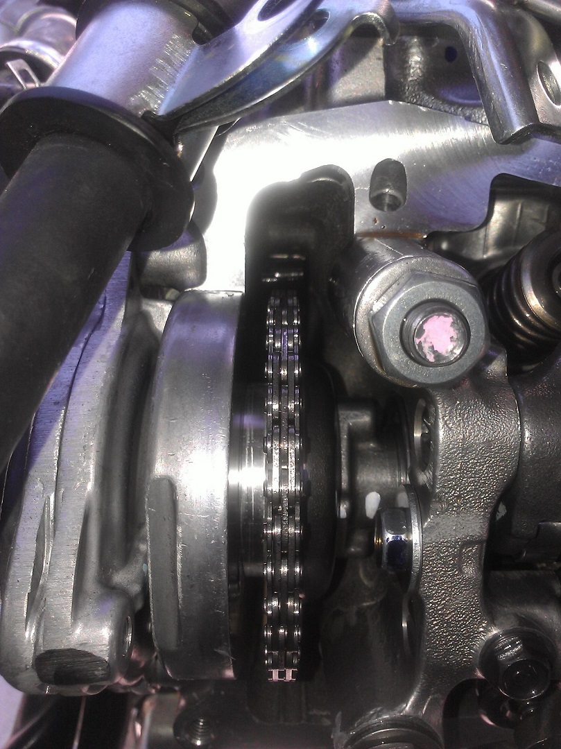

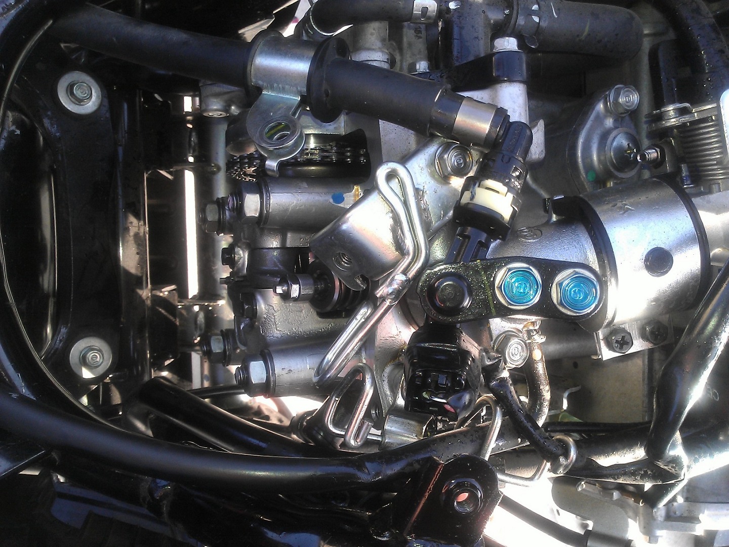

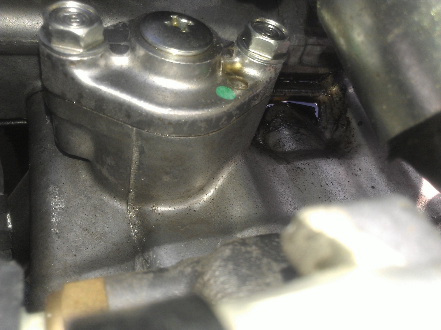

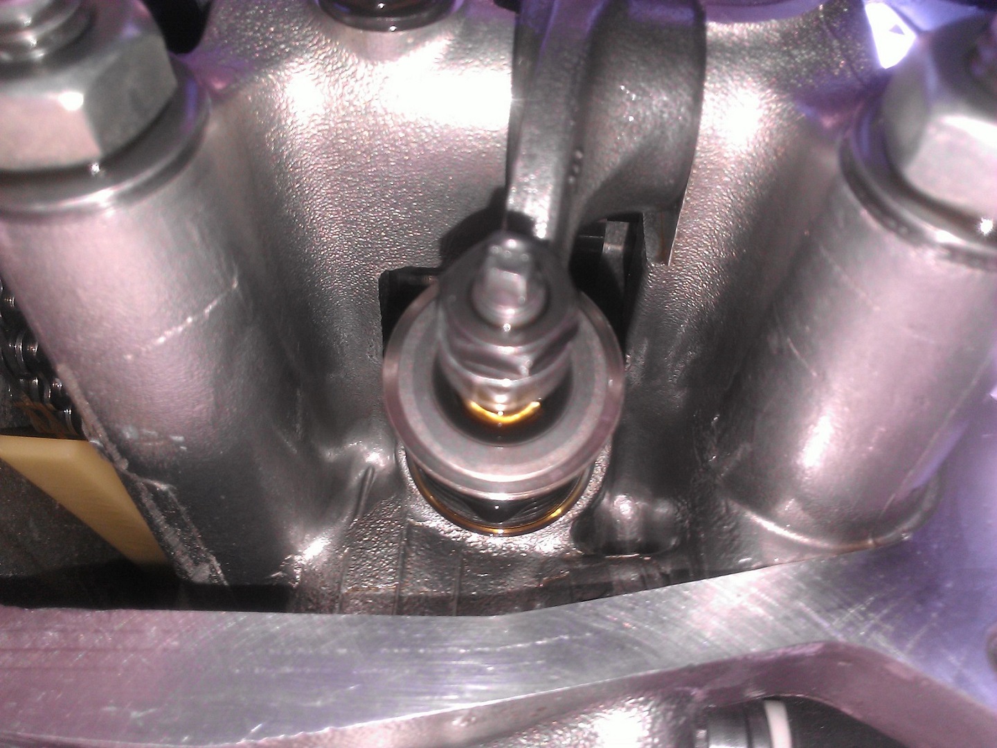

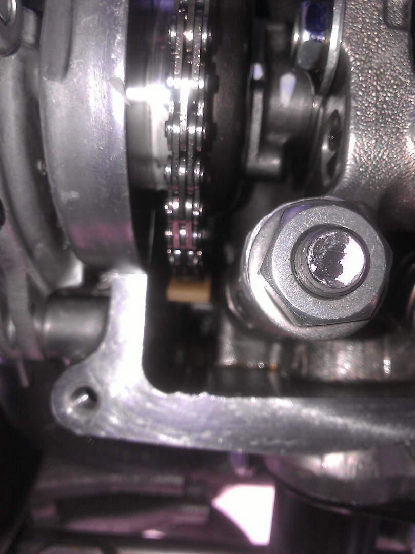

OK guys. I opened it up again. I found out why oil leaked. Well, all 4 of the bolts on the cover were loose. :| They were so loose that I could undo them with my hand. :o
I thought I torqued them properly, but I didn't have a torque wrench. I tightened them what I would consider to be pretty good. Eh. Is there a reason they would be loose? Did I not tighten them enough? I also rechecked the valves, and they are completely correct and within spec.

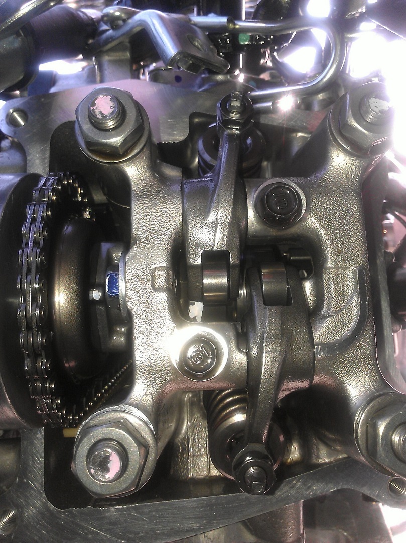

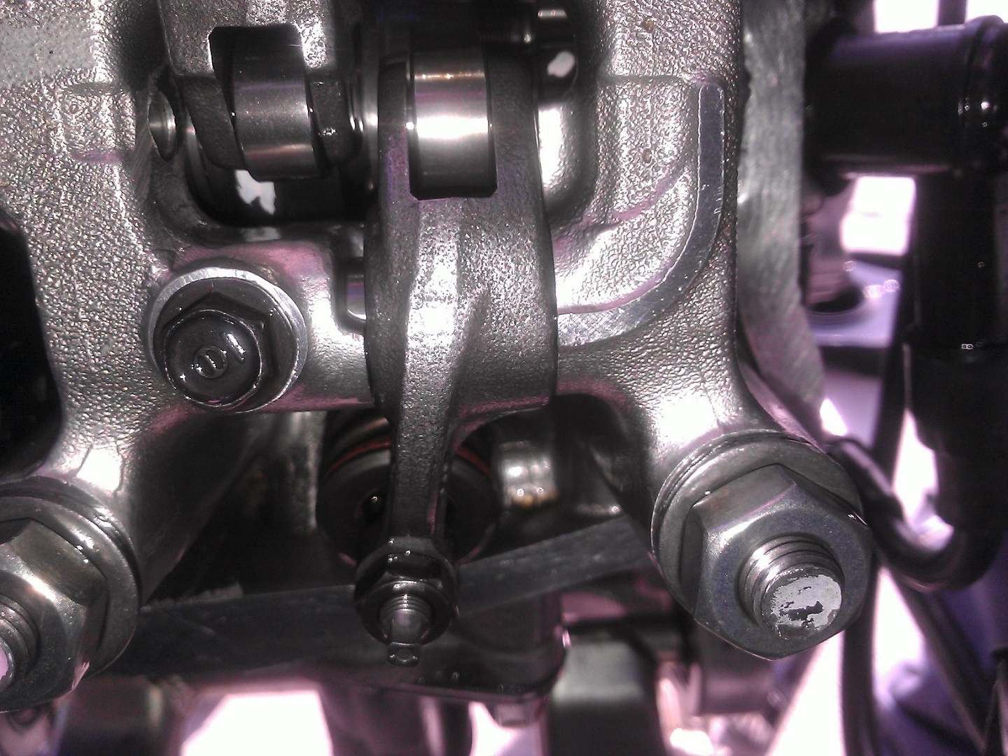

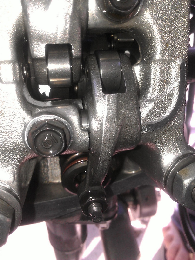

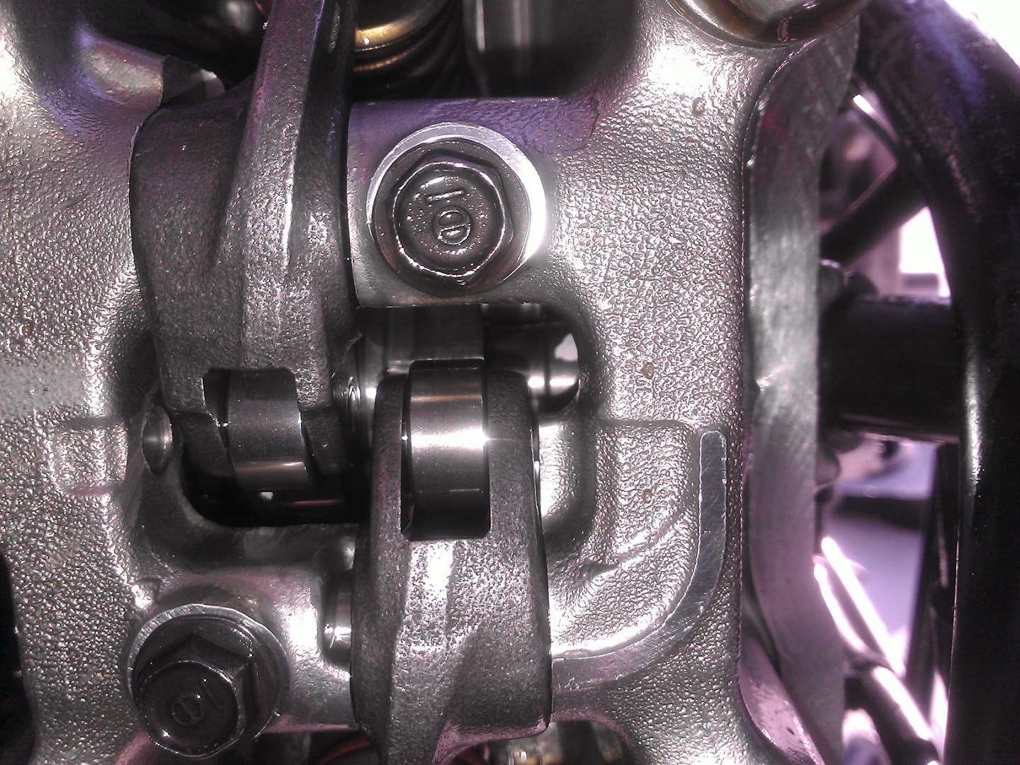

Just to be completely sure, this is TDC, right? (The rocker arm moved, and when the other mark is lined up, the rocker arm can't move. I only adjusted the valves when they were in this position, which I'm still 99.99999% sure is TDC)
So, here are other pictures I've taken. I don't see any visible cracks in anything. I also didn't see any cracks in the cover, and the gasket looked perfect.
Under the valves is where some of the oil was leaking. I'm not sure if it's coming from a few different places. Given how loose the cover bolts were, I think all of the oil sprayed out from there.
So, does anyone have any ideas about why the bolts came loose? Did I torque too much, too little, etc? The sealant worked fine, by the way. The noise was also more like a tapping than a thud. I questioned my husband more. He said it sounded like some sort of clicking or tapping. *sigh* If all of this is because I didn't torque my bolts correctly, all I can say is...I can't believe I did that. LOL
Also, I would like to fix this myself if possible. I mean, out in SoCal, I'm pretty sure a valve adjustment would be a few hundred. It still has the warranty, but would it be void because I messed this up? Also, does anyone know how to clean all of the oil off of everything? Just wipe it down, or do I need some sort of cleaner?

Yeah that appears to be TDC (is your fan notch lined up also?)
try a drop of blue thread locker on the 4 bolts and tighten to 7ft lbs.
Make sure you can see the gasket stick out all around the cover and
I would just take the time and wipe all the oil off by hand.
don't put all the plastics on until you know you solved the oil leak issue. ;)

Being a 4 stroke engine, there will be 2 TDC for each cycle. One is where the combustion takes place and the other where the gases are forced out. It is important to get the correct TDC.

Thanks, DAB. I did see two different marks on the camshaft. The one I showed is the position where (sorry, I have a lack of terminology) there is slack on the rocker arms and the place where I put my feeler gauge is open for me to measure. I'm assuming this is the TDC on the compression stroke, correct? Thanks for that link, by the way. Very informative.
