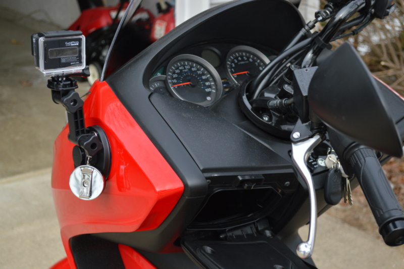

Here's an easy way to outfit your bike with a good FOV for the video. This mount method attaches/detaches in a couple of seconds, and pops under the seat for safety. GoPro sells a vacuum attachment that has about a 3" footprint. Turns out there is a 3" flat spot just to the side of the screen...

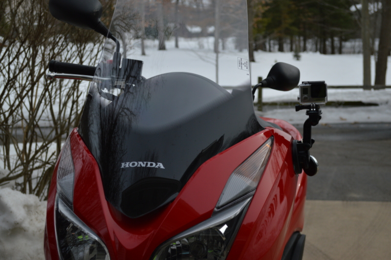

Placed here, a good view to the front is achieved with minimal cropping of the image, and the camera is centered near the center line.

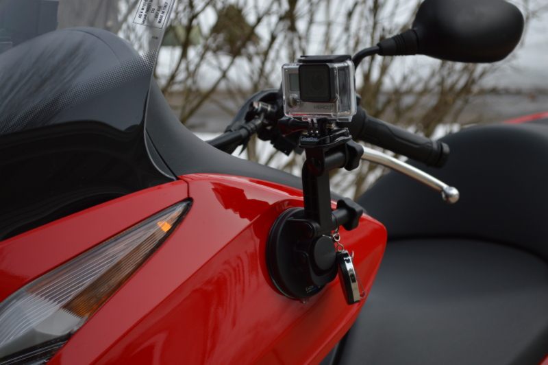

One thing that sold me on this method was covered in the YouTube video. This mount allows a 'key chain' retractable attachment that can be threaded through the mount...

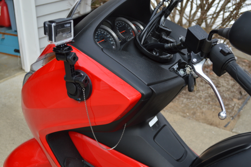

...and the whole thing attached to the inside of the left box. If the vacuum fails, the camera stays with the ride.

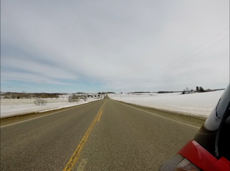

The resulting image from this has very good viewing placement...

Oh, and by the way, regarding jitter: the frame-rate is so high on the Hero3 that jitter, even in that high of a location, is not bad. The frame above was NOT captured sitting still; it was in the middle of a long straight, and I had cranked the bike up to somewhere between 55 and '35' mph. (One Burgman owner remarked that these only go '35', so it must have been that :D )
