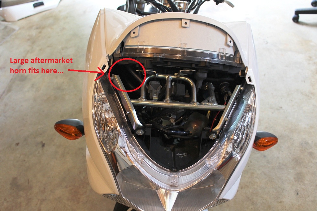

Now that your hellraisingly loud horn is blaring at max capacity, cram that motherfucker gently into here:
You'll have to GENTLY bend the fairings to wedge it in there, but it'll fit. In case you're a fool and can't see where the horn is, this'll help (note that the forum isn't wide enough to fully display the image, so right-click and click view image for maximal viewage):
And here's what it looks like from underneath, looking up behind the front wheel:
You can barely see it to the right of the forks, just the top peeks out.

I figured I should add an update, since I referenced this from another thread. First off, you can probably snake the wires to the battery box and just take off the fuel flap cover and seat. That should save a LOT of time.
Also, I moved my horn to the front, underneath the meter cover. It is way louder there:

Note to anybody else trying this - I have a 2013 PCX 150 and the insides of my scooter look a little bit different.
I ended up putting the horn inside the front fairing, above the headlight, but even there it was a tight squeeze.

I installed a Bad Boy Horn on my 2013. It wouldn't fit where Dave said the larger after market horns should fit. I ended up stuffing it in the very front opening and pushing it down into that area far enough to put the black cover over it. Dave and I worked on it for quite awhile. I then used tie wraps to make sure it wouldn't slip while riding. I tapped into the horn wires to connect the relay. I ran the inline fuse along the frame and tie wrapped the wires. Since I have multiple things going to the battery, I had to come up with a way to connect so many wires to a single battery contact. Three is its maximum. I tried four and they wouldn't stay connected. So I merged two of the wires together into one larger one (two 18s into a single 16 gauge). I did the same with the ground wires. I wanted to hook up a junction box of some sort, but I have to determine where the safest place is to put it. Meanwhile, merging the wires is the best solution I can think of.
