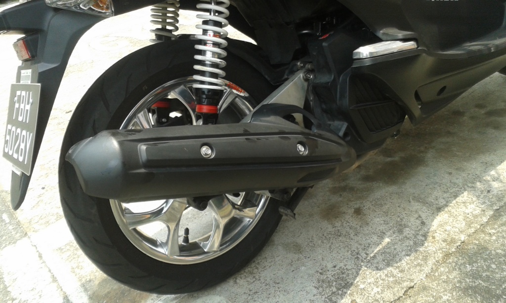

The image shows a 110/80 -14 mounted on a PCX 150. There're <5mm remaining to each side.
pneu_paralama Lat..jpg (125.72 KiB) Viewed 13980 times
.No problem, mine is fitted with 100 70 14 front and 120 70 14 rear.without modification.
