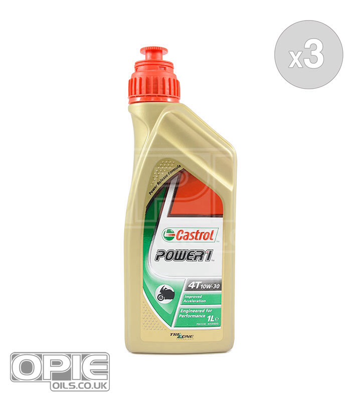

Re: Motor Oil Question
Hope this helps.
For four-stroke gasoline engines, the JASO T904 standard is used, and is particularly relevant to motorcycle engines. The JASO T904-MA and MA2 standards are designed to distinguish oils that are approved for wet clutch use, and the JASO T904-MB standard is not suitable for wet clutch use.
I use castrol 10w30 and it's MA
The local honda dealer sells it and it's widely available.
- ImageUploadedByTapatalkHD1394052058.997854.jpg (55.05 KiB) Viewed 18184 times
