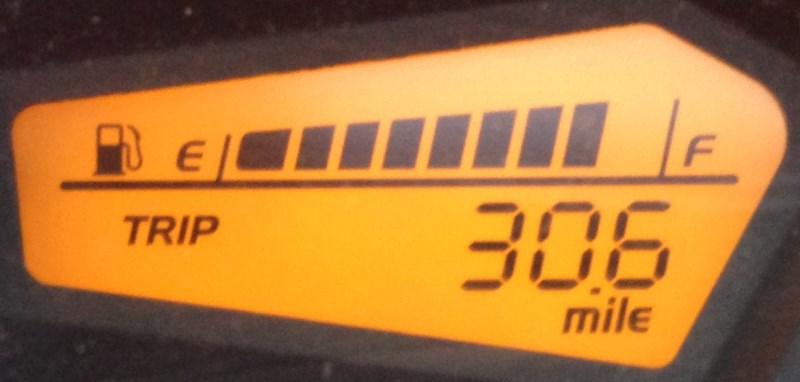

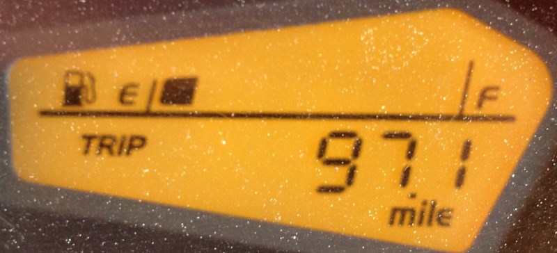

Okay is it just me who has a fuel gauge that doesn't measure right?
After 30 miles the first notch is gone.
Okay why when I get to 97 miles the last notch starts to blink.
If we were to use the first measurement as a guide there are 9 notches.
9 x 30 = 270
So why don't I get 270 miles to a tank?
Rob

Re: Digital Fuel Gage
Posted: Fri Feb 28, 2014 4:25 am
by illegal
Almost every fuel gauge does this. I don;t know why exactly, but most possibly it is due to shape of fuel tank (in attachment) where the gauge measures only level of fuel, not the actual amount. I read there are some more advanced gauges which use transistors/microchips to convert this and they show the actual amount of fuel in a tank.
In the attachment you can see, that tank is much wider in the upper part, it means there is more fuel, but as the level goes down, the amount of fuel is decreasing is non-linear.
I recommend you to check how much you can do on one tank (I personally can safely ride for 210-220 kilometers) and take trip meter as the main indicator for refueling :)

Every fuel gauge on every conveyance I've owned seems to hang in there more when full than when nearly empty. Knowing that your PCX should get around 100 mpg (+/-), you will want to start looking for a gas station at around 100 miles on the trip odometer. Most motorcycles I've owned did not have a fuel gauge - you went by the odometer, then had a reserve setting on the fuel petcock when the bike sputtered. By comparison, the PCX gauge is pretty slick.

cfrobw wrote:Okay is it just me who has a fuel gauge that doesn't measure right?
Completely normal. The first notch is good for about 30-40 miles as is the last notch. The ones in between however are a different matter.
Posted: Fri Feb 28, 2014 1:51 pm
by cfrobw
Ah, so if the tank was square and level the gauge would be pretty close to accurate. My Elite 110's gage was pretty accurate. it had the flat floor board and the tank was a flat box under the floorboard. I drove my PCX till it was empty and I ran out of fuel at about 129 miles.
