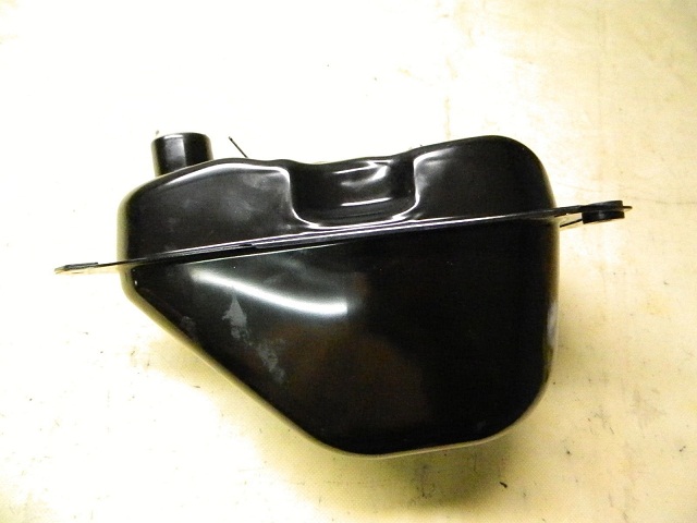

Almost every fuel gauge does this. I don;t know why exactly, but most possibly it is due to shape of fuel tank (in attachment) where the gauge measures only level of fuel, not the actual amount. I read there are some more advanced gauges which use transistors/microchips to convert this and they show the actual amount of fuel in a tank.
In the attachment you can see, that tank is much wider in the upper part, it means there is more fuel, but as the level goes down, the amount of fuel is decreasing is non-linear.
I recommend you to check how much you can do on one tank (I personally can safely ride for 210-220 kilometers) and take trip meter as the main indicator for refueling

Good explanation illegal.
The shape of the gauge (right to left) matches the shape of the tank (top to bottom).
Makes sense to me!
Makes sense to me!

Ah, so if the tank was square and level the gauge would be pretty close to accurate. My Elite 110's gage was pretty accurate. it had the flat floor board and the tank was a flat box under the floorboard. I drove my PCX till it was empty and I ran out of fuel at about 129 miles.
