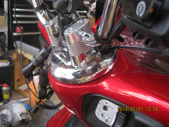

Bar risers and mirror extenders
kept seeing my elbows in rear view mirrors and little else.
So,
added a set of bar risers - approximately 1 inch lift.
No cable or line problems.

- 2014 02 07 PCX150 6 bar risers 900k.jpg (278.57 KiB) Viewed 9524 times

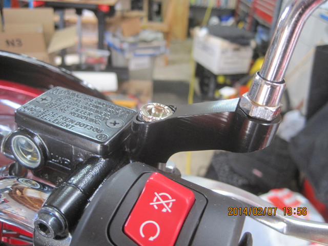

Re: Bar risers and mirror extenders
Not good enough.
Added a set of mirror extenders.
much better.
Also playing around with some old mirrors I had in my save pile.

- 2014 02 07 PCX150 8 mirror extenders closeup right 900k.jpg (254.84 KiB) Viewed 9524 times

.pcx125 wrote:Hi , I like your bar risers, where do you get it ? Please send me links
hay pcx125
the bars on the pcx are 7/8 ths. Any standard bar riser should work.
The bar risers come in varies heights. The ones in the picture are about 30 mm or just over an inch.
They come taller, shorter, and whats called 1 up - 1 back which is an offset riser that goes up an inch and back an inch. Very handy for those with shorter arms.
If you stick with no more than an inch and a half up, or 1 up 1 back, you should not have to reroute cables or brake lines.

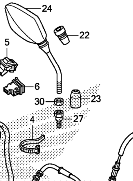

Nines - you do know that both stock mirrors are left hand thread along with the locking nut ???Nines wrote:Thanks! I'm going to try the teflon tape.Nines wrote:Speaking of mirrors/mirror extenders (have some extenders on my bike), I find that one of my mirrors is constantly working loose, even before installing my extenders. I'm reluctant to use thread locker on it, does anyone have a suggestion? Lock washers, maybe? Vodoo? Swearing and spousal intervention haven't worked, either
The adapters between the handle bars and mirror stem convert the left hand tread to 10mm right hand tread.
So to tighten the mirrors with the locking nut you turn the nut lefty NOT righty to lock it down.
My original mirrors were both loose and it never occured to me that they would both have left hand thread.
So, I proceeded to gorilla tighten and or loosen and managed to shear off the mirror stem.
Then still not realizing what was afoot, I did the same thing to the other side - I mean sheared the mirror stem right off.
So, that is how I came to add the extenders and other mirrors.
So the whole mirror and adapter will unscrew from the handle bar as normal.
Then to separate mirror from adapter, turn it the wrong way - Right to loosen.
If that makes any sense

If my picture comes out,
the mirror, item 24, and the opposite side mirror are both 10mm left hand threads.
Item 30, the locking nut, is left hand thread.
The adapter, item 27, is left hand thread on top, and right hand thread on bottom.
I have a 2013 PCX150 bought in US. I have no idea if this silliness runs in all PCXs or just some.
Yes, sometimes a picture is worth a thousand words.
