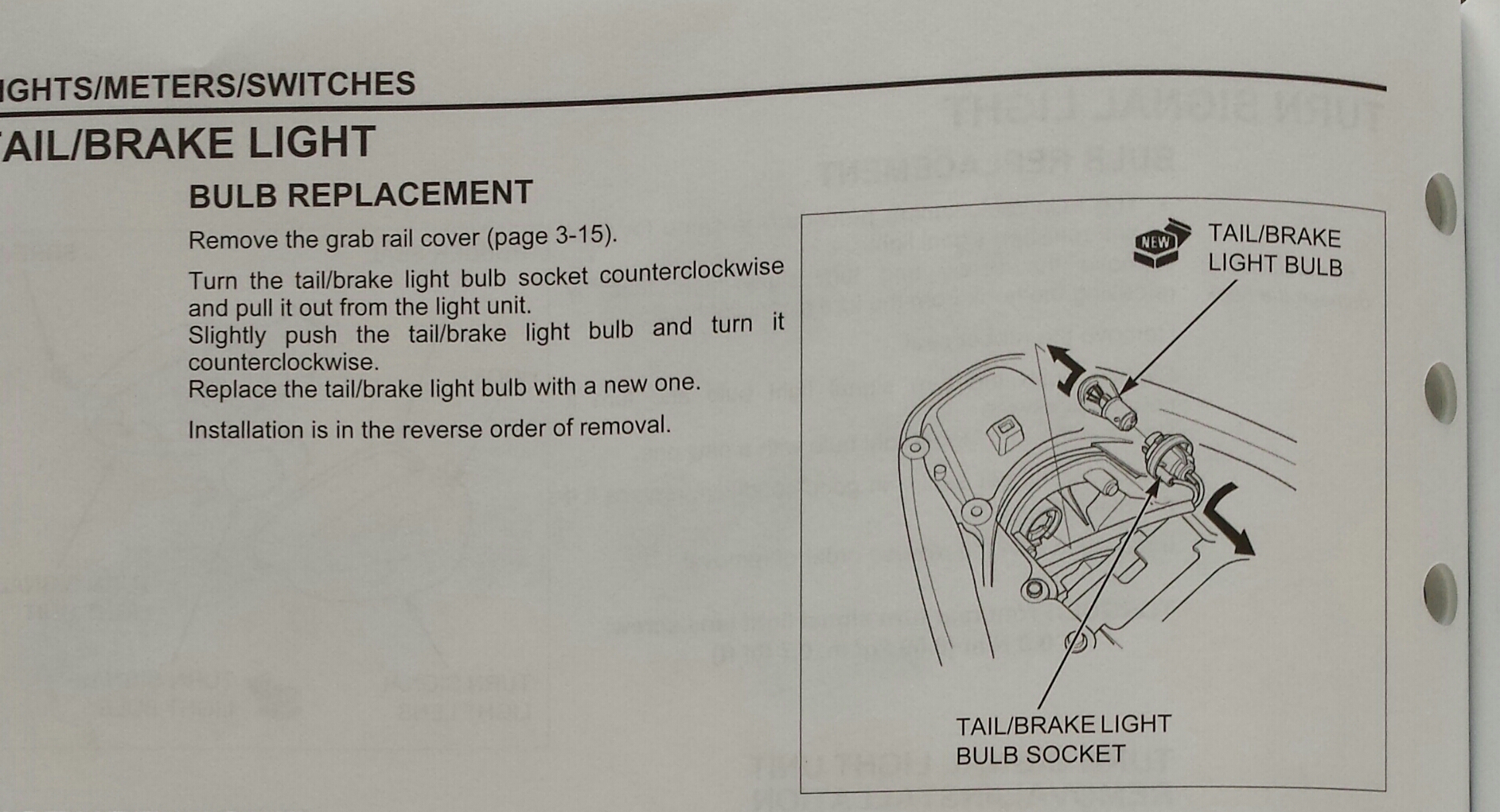

These svc. manual pics should help ya. Just go slowly removing the grabrail cover...Do as shown. You kin doit! Cheers!
(Be back with one more)

Re: LED Tail Light bulb
Two more. Sorry they are out of order.

Update-I installed the 1157 bulb yesterday. Works perfectly. Thanks all for the input.
And whitenoise - thanks for the manual pics.

Sure, no prob, glad it helped. I changed mine already too. Check/Done.
