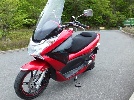

Hello guys, I am looking for some solution of leg protection. I have Tucan urbano pants, but I would like to have some deflectors on bike itself.
I found something on japanese sites, but I don't understand how to order it from there (or if it is even possible) and I would like to ask you if you haven't seen it somewhere.
Links are here: http://minkara.carview.co.jp/en/userid/ ... parts.aspx
http://blogs.yahoo.co.jp/willyamabuu/31495131.html
With google translate I found it should be called "wide side visor" but I didn't find anything about it on non-japanese sites.

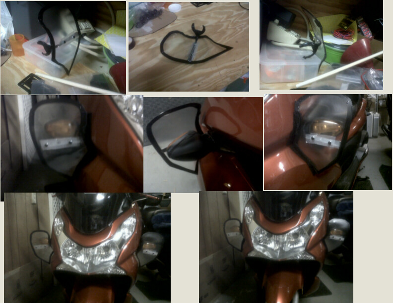

Until such time as when we find a way to even order those, which are beautiful, and yes I can modify them, here is my latest invention. They are easy to install and easy to take off. I call the Bat Wings, and yes, I invented them. Enjoy!

I think I found it!
First I went to this site: http://japan.webike.net/products/20286382.html
The name is similar to what we are looking for, but it doesn't seem to be it on the photo.
So I looked for part Comestock PCC1001 and found some eshops with correct photo and price matching the price mentioned on one of the sites I posted earlier: http://item.rakuten.co.jp/moto-jam/2802127001/
http://mmall.jp/item/169853918
It looks like the webike shop used just first photo from "before and after" pair.
With shipping to Slovakia it should cost 93 € which seems to be a very good price!

Well, I have started on version 2. I installed the left side this evening and took a picture or two. I need to make the right side next. Then, when spring arrives I will test it out, but I think it will work. I shouldn't have seen that picture. It gave me ideas. B-)

OK, Version 2 is complete. Here are the pictures of my invention. Keep in mind that they are held on with industrial strength Velcro. I haven't tested them, but I am betting that they will hold. When you want something done right, just invent it! :-)

Looks effective. You'll have to let us know how it works when it gets warmer.
Re: Leg wind deflectors - where/how to order?
Version 2 looks great
I would make them a bit longer, but I like this solution much more than version 1.

Home made is great. I can make things the way I want, without worrying about whether I have messed up installing it. Also, the total cost was less than $20. ;-). Of course, time is not part of that cost.

Mel, is that Plexiglas?Mel46 wrote:OK, Version 2 is complete. Here are the pictures of my invention. Keep in mind that they are held on with industrial strength Velcro. I haven't tested them, but I am betting that they will hold. When you want something done right, just invent it! :-)

Of course it is plexiglas. I went to Home Depot and selected the size and thickness I wanted. I made a template using an old file folder. Then I cut the plexiglas using my Dremel. Great tool. I love mine. There is actually a bit for cutting plastic. Then I used my heat gun to bend the front pieces to where I wanted them. After that, I took the piece of plexiglas that I had cut out for the hole for the turn signals, bent it to the angle I needed for the front areas, and used industrial velcro to attach everything. It only took me a few days from concept to finished product. Each side is a reverse of the other, so I had to custom bend each piece to make sure they fit correctly.
