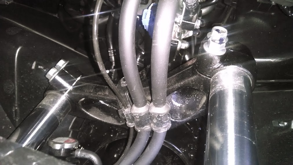

You should be able to drop the forks through the yolks by half an inch or so. Makes a surprising difference
Re: Lowering the Forza
That's exactly what I was thinking. Do you have any idea what the torque settings should be on the forks yolks?you you wrote:You should be able to drop the forks through the yolks by half an inch or so. Makes a surprising difference
I've attached a picture of her yolks and from the dust on the shocks it looks like there's a good inch that they could be adjusted. Probably only do a 1/2 inch to test though.
Any reason why this wouldn't work?
It'll work perfectly. It's the second thing I almost always have to do to my wife's bikes after lowering the rear
So it's not "easily" possible to lower the front forks. At the top of the fork tube is a bevel that the bolt goes through as an added safety feature since there is only a single yolk. You could try cutting a groove lower down but this isn't an option we were willing to try. As a result I think we'll end up selling the bike and buying a Vespa or some other scoot that my wife's inseam is more properly suited to.
That slot doesn't locate the bolt, you can slide the tube out the yoke with the two bolts still in place.sgoyette wrote:So it's not "easily" possible to lower the front forks. At the top of the fork tube is a bevel that the bolt goes through as an added safety feature since there is only a single yolk. You could try cutting a groove lower down but this isn't an option we were willing to try. As a result I think we'll end up selling the bike and buying a Vespa or some other scoot that my wife's inseam is more properly suited to.
Hmmm...that's not the experience I had. With the top bolt in the yolk there was no way to remove the shock. Once you remove the bolt completely it slid right out. I even tried threading a bolt through with the shock in a lower position in the yolk but the bolt would not go through...in fact it ended up destroying the threads on the bolt and I had to go get a new one. There might be other models of shock that are somewhat different but at least on this one you would need to modify the shock tube to make it work.gn2 wrote:That slot doesn't locate the bolt, you can slide the tube out the yoke with the two bolts still in place.sgoyette wrote:So it's not "easily" possible to lower the front forks. At the top of the fork tube is a bevel that the bolt goes through as an added safety feature since there is only a single yolk. You could try cutting a groove lower down but this isn't an option we were willing to try. As a result I think we'll end up selling the bike and buying a Vespa or some other scoot that my wife's inseam is more properly suited to.
