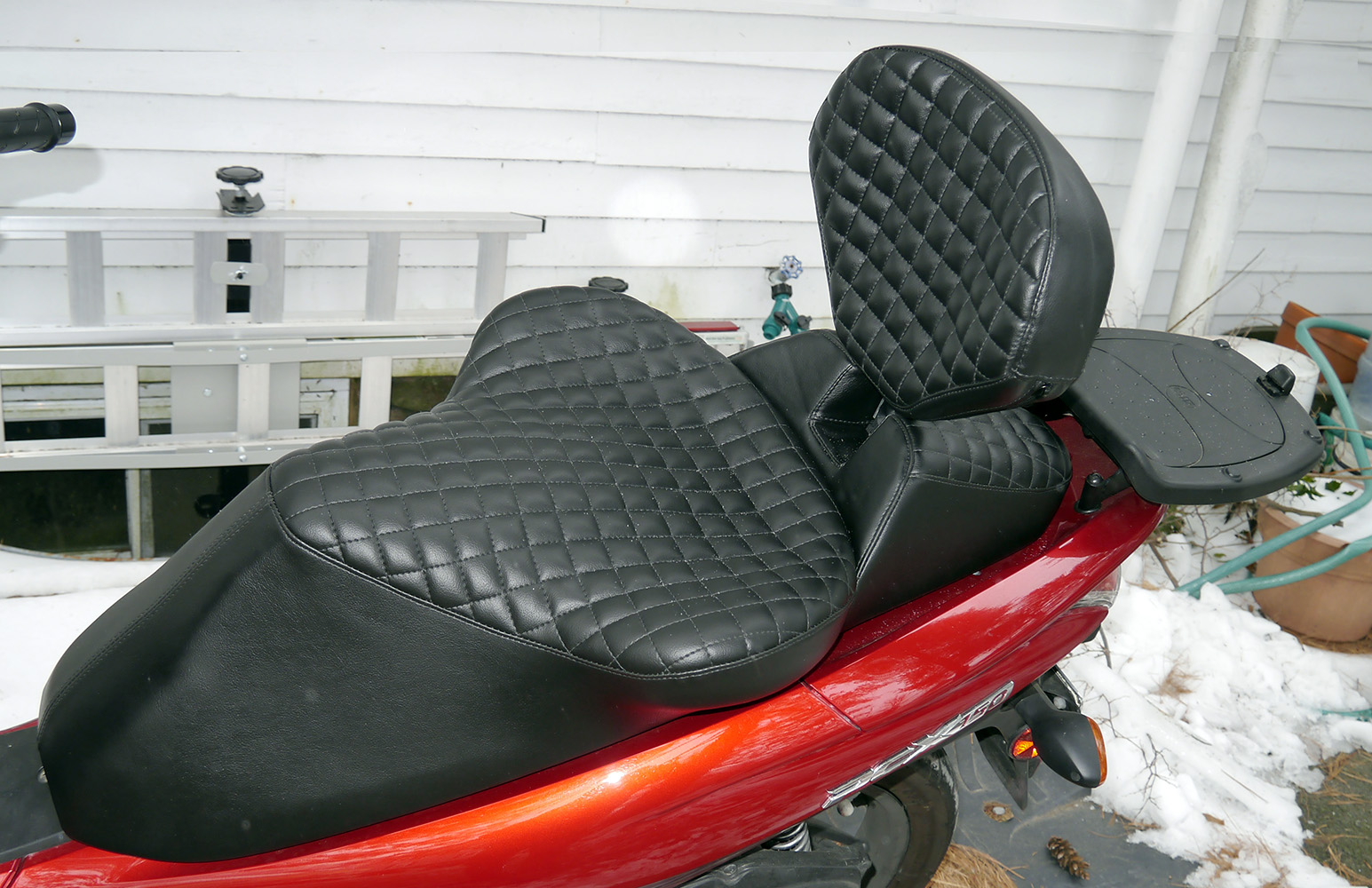

Got an amazing new seat, but I'm so far back in the pocket I can just reach the handlebars!
Is it fairly simple to swap out for a bar that's got a longer "pullback"?
New seat from RUSSELLS
new seat A sm.jpg (415.96 KiB) Viewed 3450 times

its not too hard to swap handlebars, only issues are cable lengths and the locator tabs on the back of the switchgear. its easy to grind off the tabs and then glue the switchgear to the bars. the stock cables have a bit of length to play with so shouldnt be much of an issue unless you get some harley style ape hanger bars o_O

Yes, it's a RUSSELL Day Long. There wasn't much choice on where the backrest could go!
Just tugging on the cables feels like there's really not much play, but they must be tied down under the faring.
Still winter so I've not gone far, but it should be a major upgrade seat wise (if I can reach the handlebars comfortably!).
thanks!

So a friend says that it would be better/easier to put in a set of risers like this http://tinyurl.com/l5ztzf2
Still don't know about cable length... I'm thinking of the 3.5" risers.

BTW, I found that the original stock seat was difficult to lock down... with the new seat upholstery I had to remove the rubber "feet" to get the seat to lock down. Anyone else find those feet make a very tight fit?

depthman wrote:BTW, I found that the original stock seat was difficult to lock down... with the new seat upholstery I had to remove the rubber "feet" to get the seat to lock down. Anyone else find those feet make a very tight fit?
Yes -- I had to trim them to get the seat to lock for both the stock seat AND the aftermarket seat I have.
