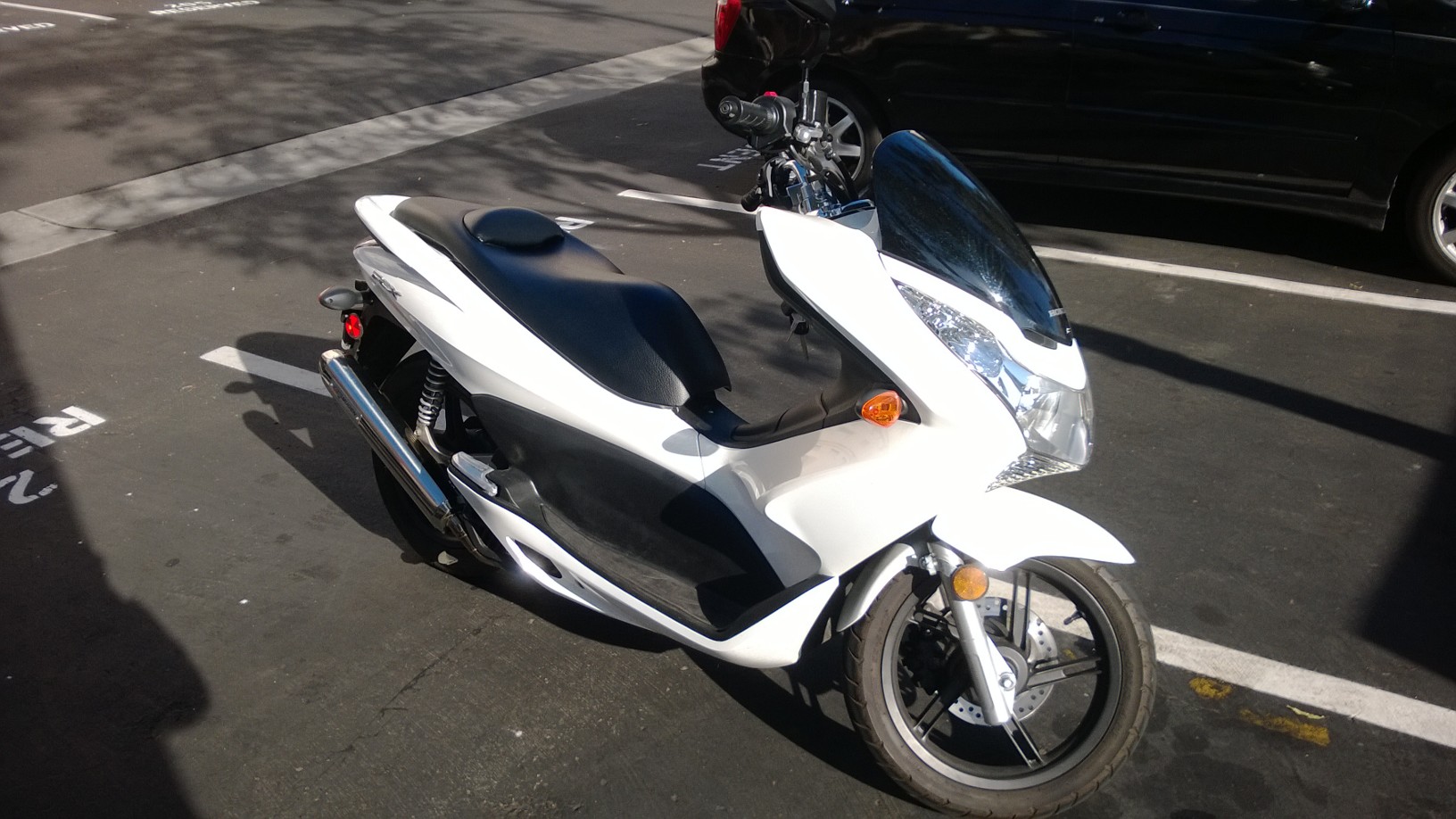

- My PCX!
- WP_20131213_13_50_49_Pro.jpg (329.81 KiB) Viewed 9679 times

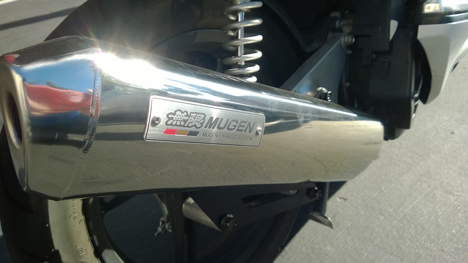

- Mugen Exhaust!!
- WP_20131213_13_50_32_Pro.jpg (282.97 KiB) Viewed 9679 times

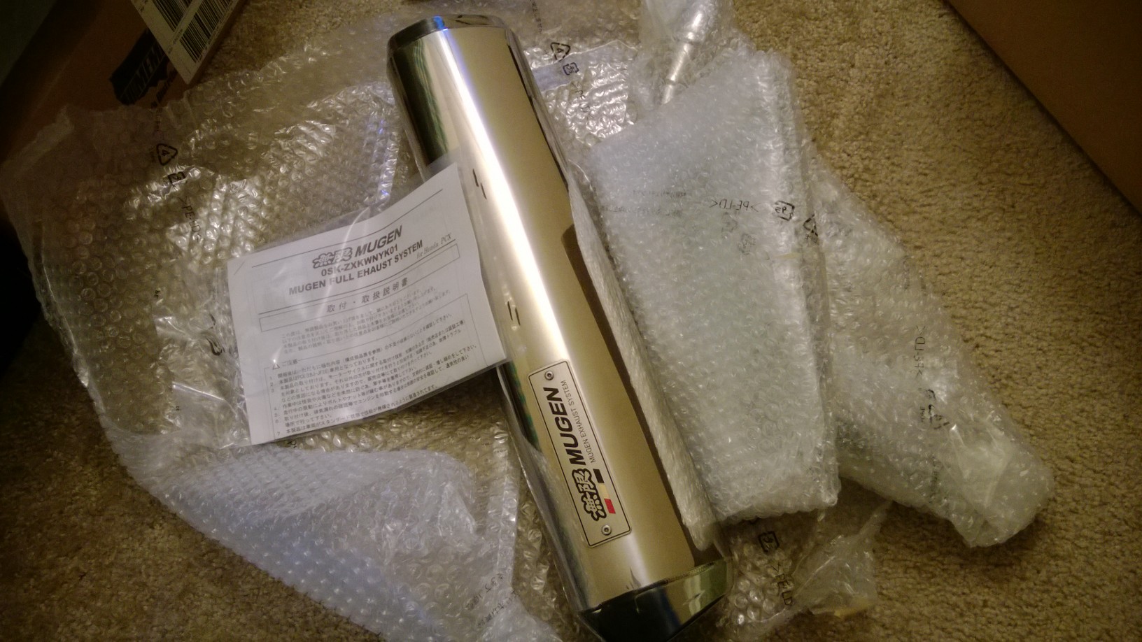

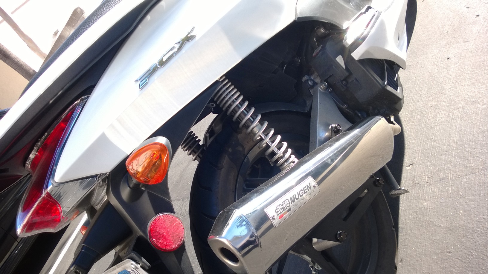

- Mugen Exhaust!!!
- WP_20131213_13_50_27_Pro.jpg (371.19 KiB) Viewed 9679 times

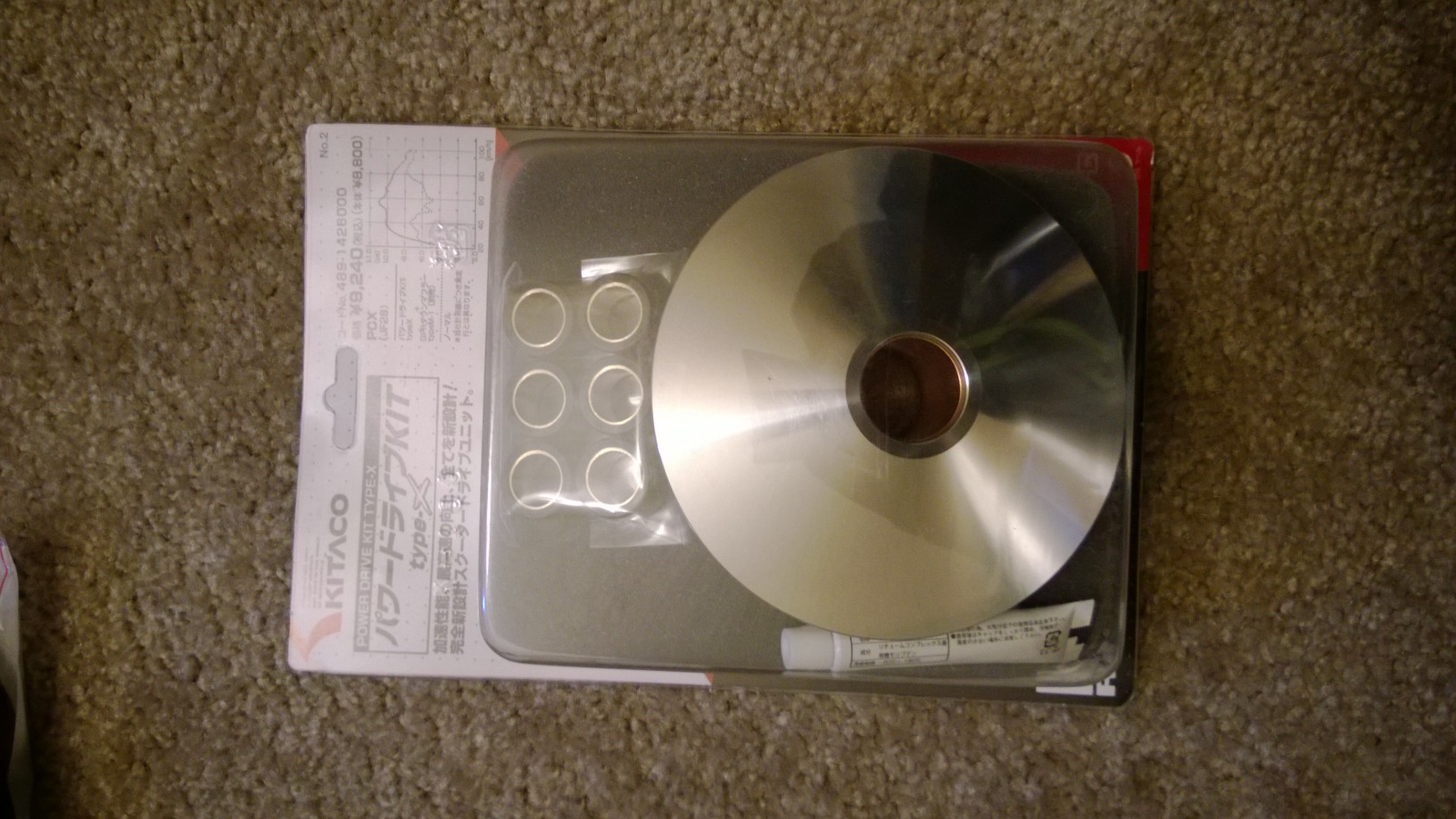

- Kitaco Pulley Set
- WP_20131207_09_40_36_Pro.jpg (333.95 KiB) Viewed 9679 times

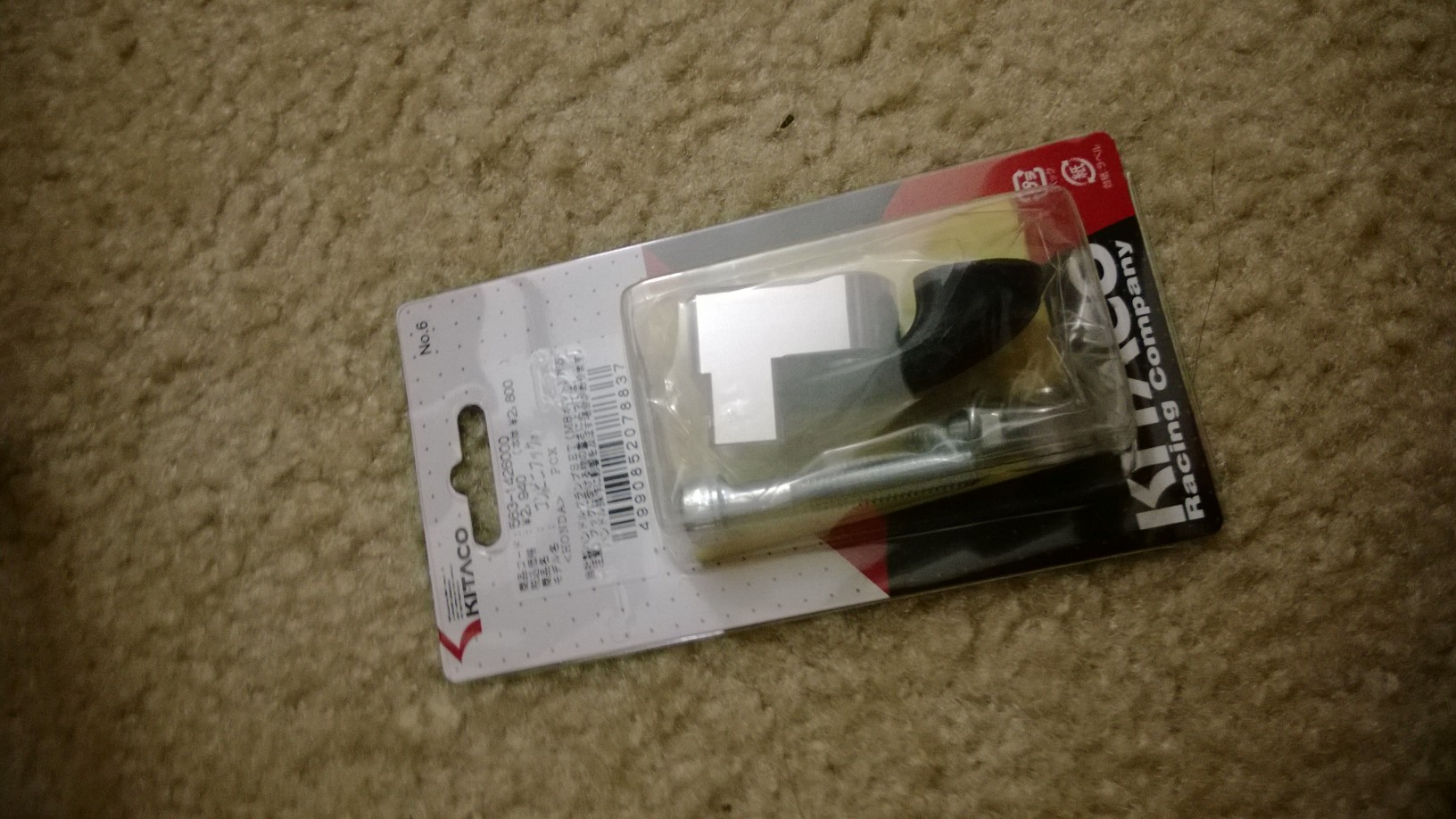

- Kitaco hook for helmet
- WP_20131119_16_04_23_Pro.jpg (343.53 KiB) Viewed 9679 times

Switch to a yuminashi variator to boost your speed up over 70mph.

+1 or alternatively Takegawa,Daytona,Kn Planning or Malossi. All of these will give you much better top end with same acceleration as Kitaco vario. Also Kitaco belt is only good with Kitaco vario,if used on any other varios will decrease top end even further...Mgalutia88 wrote:Switch to a yuminashi variator to boost your speed up over 70mph.
