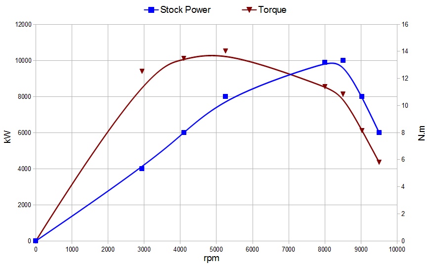

Disclaimer: I pulled this graph out of my imagination and do not guarantee its accuracy.
It is however based on calculations and not guesswork so I don't think it is far from reality.
est power curve.jpg (64.06 KiB) Viewed 7102 times
Torque curve is irrelevant - I used it to verify the power curve.
What is quite important is the steep drop in power above 8500rpm.
You can even see this on the stock curves (power vs speed) where the variator is maxed out (above 100km/h)
Cruising at 107km/h (GPS), I estimate I only have about 8kW available.
This is why I believe the PCX150 can go quite a bit faster if one can bring down the rpm above 100km/h.

How did you calculate that? I think your power peak may be a little high in rpm and the torque peak is showing too broad and too soon.
There are dyno programs for Android phones that might actually work ok with a slow vehicle like the PCX.
Needless to say, you are right about longer gearing giving a better top speed because the power is definitely falling away well before redline. A top speed at 8,400 rpm would be about right which needs 10% longer gearing.

Oops, I forgot to divide by 1000 on the kW axis.
I started with Honda's quoted figures (10kW @ 8500rpm and 14Nm @ 5250 rpm).
From there I analysed a power vs speed curve of a stock PCX150 from one of the aftermarket suppliers.
Then coupled the above with knowledge of rpm at various speeds.
I am quite confident regarding the steepness of the drop in power above 8500rpm.
