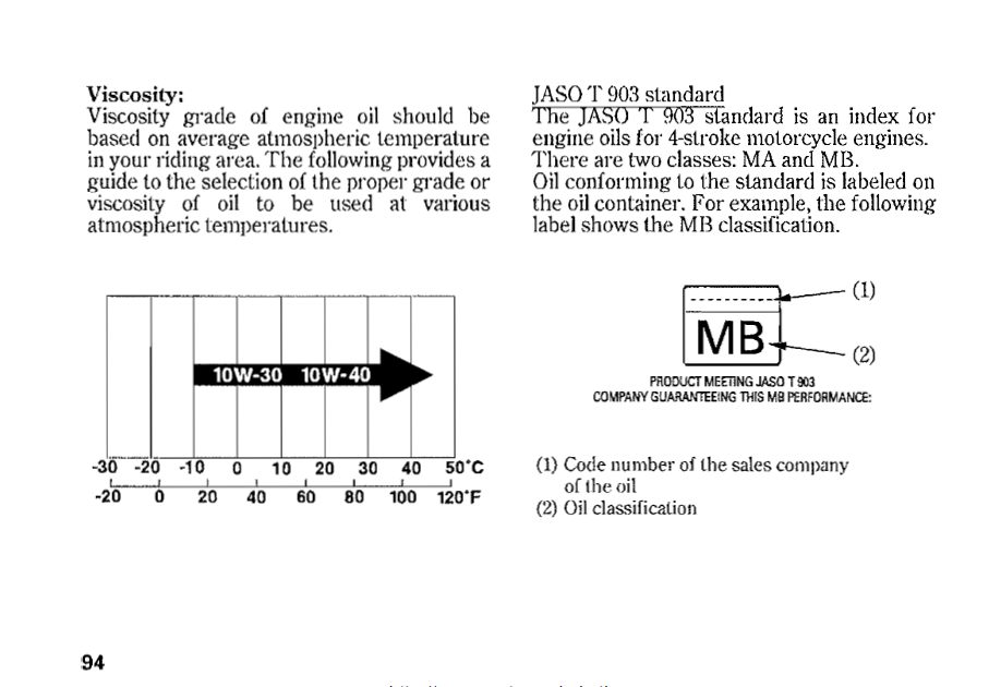

In the owners manual that comes with the bike on, page 94 shows both 10w-30 and 10w-40 in the same arrow, meaning both are appropriate for the entire temperature range of the bike. If there were two arrows, each type would only apply to a certain range.
For reference, here's the page I'm referring to...
And if you lost your manual, I attached a scanned version. Since it comes with the bike for free, I don't think uploading it here hurts anyone (and if it does, please PM me and I'll remove this immediately). Here's a direct link to the manual:

Well I've got some 10w30 now so I may as well use it. I change the oil half way between services so the engine'll have 10w40 back in in 1250ml or so.

10w30 vs 10w40 won't make a big difference, Honda recommends 10w30 anyway for temperate weather

I've just being trawling through the net for more info on this and I've come to the conclusion that what you do is put the oil in that honda recommends and forget about it :)
