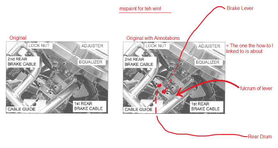

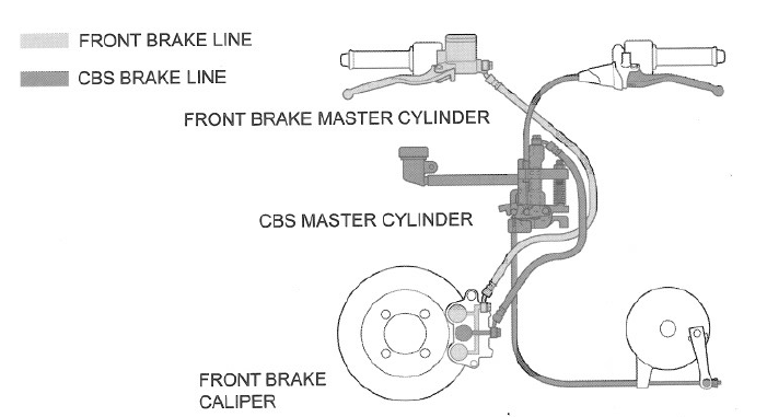

Re: CBS causing me problems
ewganhoff wrote:Cheers for the reply, Maddie, I've been lurking for about a year so I know some of the main protagonists on here.
I'll save GN2 the usual PM asking him to be nice then. ;) As usual, he has a bit of a point though. Regardless, that's unproductive to the issue we're discussing.
ewganhoff wrote:What would happen if I took the 3rd piston brake line off the calliper and blanked off the hose and the calliper? Would it effect the rear brake, or the front? I know I would lose the use of the third piston but the front brake is strong enough when only the front brake lever is applied.
I see no reason that wouldn't work. The CBS has a separate master cylinder, so I don't think the front brake would be adversely affected.
ewganhoff wrote:What determines the force applied to the 3rd piston's master cylinder and how does the cable interact with it? If, for example, I completely undid the cable down at the drum actuator, would the 3rd piston still work when the back brake lever is pulled?
In the CBS assembly, you pull on the lever from the handlebar and it simultaneously pulls the rear brake line and engages the brakes by pressurizing the master cylinder. I'm going off the microfiche (I don't have my bike disassembled), but from what I can tell, it doesn't look adjustable. It does appear as though undoing the drum actuator would still engage the front brake though.
I did notice the spring that actuates the piston in the master cylinder is referred to as a "delay spring," which is where I'm guessing you got the delay concept from. It's non-adjustable, whatever it is.
Here's a diagram from Honda showing the two systems are separate hydraulically, which should support the idea of blanking off the hose/caliper, although I don't think that's necessarily the path of least resistance.
I think your path of least resistance may be to just drain all the hydraulic fluid from the CBS. It'll effectively do the same thing. Note if you try this and I'm wrong -- which has happened before, you're doing experimentation here, you'll have to take apart at least your windshield and the meter cover below it to access the CBS master cylinder to rebleed that system. If that happens, I'll happily post up the pages outlining that procedure for you. That would be considered "fair use" and not violate copyright. My theory: Draining out the hydraulic fluid from the CBS bleed valve through the front caliper should completely disable the front brake on the combi brake lever, with absolutely no effect on the front brake lever's functionality.
Evidence to support my theory:
1. The service manual explicitly states two separate routines for bleeding the CBS and the main front brake. This implies the systems are discrete.
2. The line from the adjuster (in this how-to) has an almost-direct passthrough to the rear brake. There is a lever in the CBS assembly that appears to actually give greater mechanical advantage to the rear brake than you do at the lever. I've shown this below in a very professional-looking mspaint diagram:
Proceed at your own risk, and report back if you attempt this. :D
