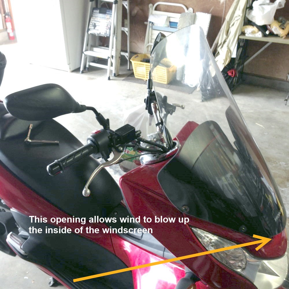

To answer your question, the first day I rode my PCX, I drove it 15 miles out and 15 miles back on the Interstate at 60. (My bike was used by 2 months, had 1400 miles on it.) There was what you would call buffeting that day. Its the only time it occurred. I think I was leaning to far forward towards the windscreen. I felt like I was in a wind tunnel, my helmet was vibrating on my head like crazy. See the attached photo.
After examining the bike I found that there is a huge opening at the bottom of the windscreen in the front, part of the design of the bike. It allows wind to rush straight up the inside of the screen. I believe this is what caused my helmet to vibrate. I haven't had the problem since that day. I changed the way I sit. I don't put my face close up to the windshield like I did that day.
Rob

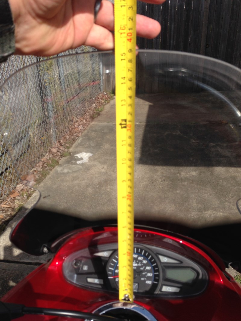

Thank you for all the info, especially the pictures! One last question---do you look through the screen or over it? Okay, one more last question--how tall are you? I'm only 5'3" and would like to be able to see over a screen rather than have to look through it. Maybe the better question would be, what is the length of the screen from top tip to bottom tip?

I look over it. I'm 6'1". If you look at the last few pictures, you will see that the screen is about 4 to 5 inches taller than the mirrors. If you wish, I can measure from the dash straight up to get the height and take a photo.

cfrobw wrote:I look over it. I'm 6'1". If you look at the last few pictures, you will see that the screen is about 4 to 5 inches taller than the mirrors. If you wish, I can measure from the dash straight up to get the height and take a photo.
Yes, thank you, that would help a lot. It's hard trying to figure out how high the screen is just by looking at the pictures.

According to my measurements its 15.35 inches tall from where the cover over the handlebar meets the dash.
See image below.

Thank you so much! That measurement is VERY helpful.

If I remember correctly, when I put our Givi windshield on, the holes on the windshield that line up with the windshield brackets was actually drilled through the Plexiglas itself, which means that the hole you had the problem with isn't as large with a Givi because it is closer to the body. My wife is only 5 ft tall but was getting buffeted when she had the smaller Givi windshield on, so we went up in size and now have the tall Givi windshield. She sees through it instead of over it, but the buffeting is gone.
Re: Honda's own windscreen upgrade - anyone?
Posted: Tue Mar 04, 2014 2:31 pm
by cfrobw
Mel46 wrote:If I remember correctly, when I put our Givi windshield on, the holes on the windshield that line up with the windshield brackets was actually drilled through the Plexiglas itself, which means that the hole you had the problem with isn't as large with a Givi because it is closer to the body. My wife is only 5 ft tall but was getting buffeted when she had the smaller Givi windshield on, so we went up in size and now have the tall Givi windshield. She sees through it instead of over it, but the buffeting is gone.
Are you referring to the spot where the holes aren't lined up in the photo above? If so that's just because I was showing them in the picture before I hooked it to the mounting points. It just hooks right in and you re install the bolts.
