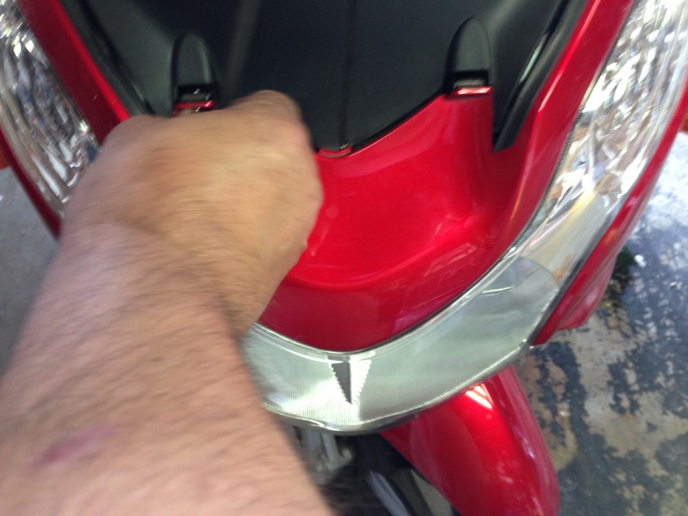

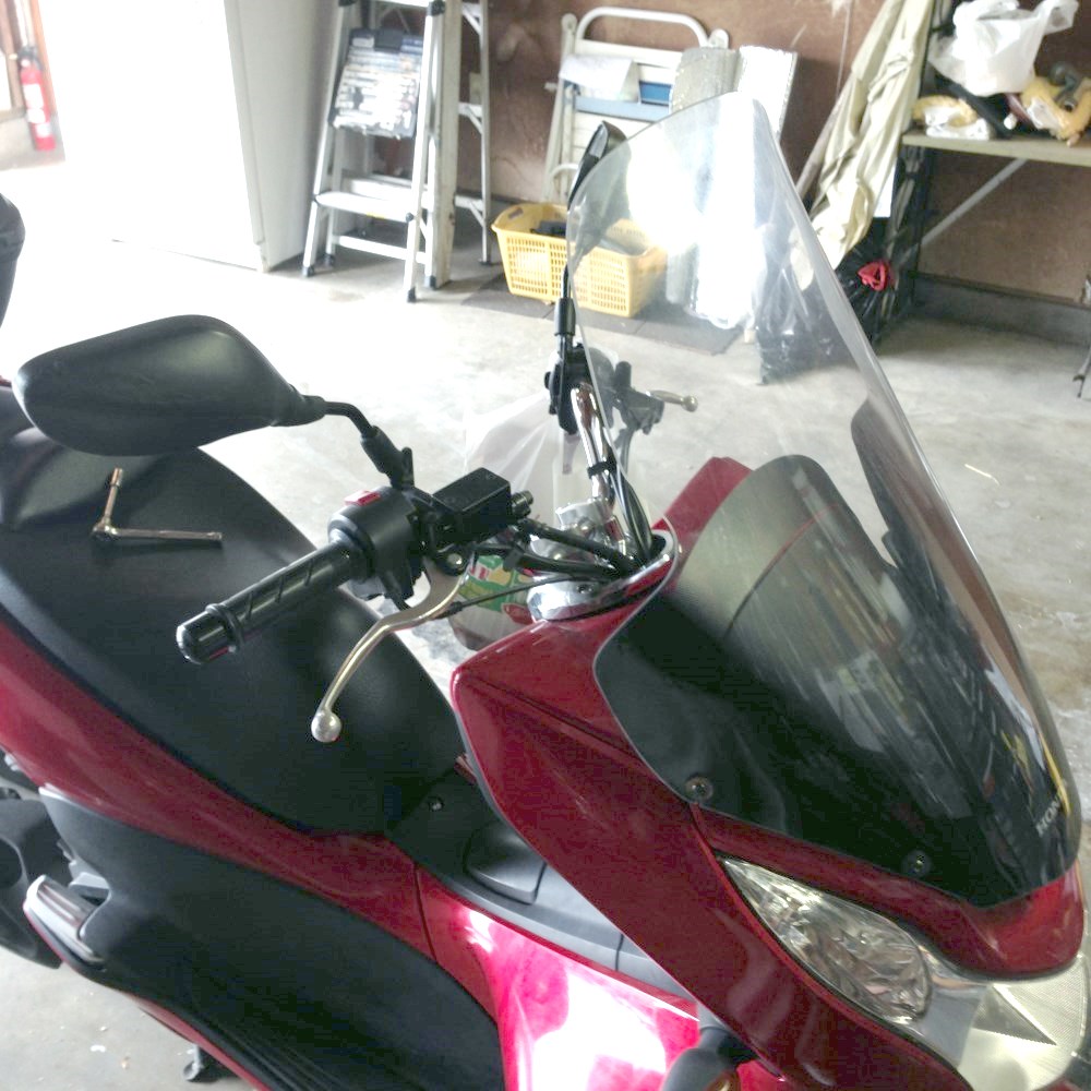

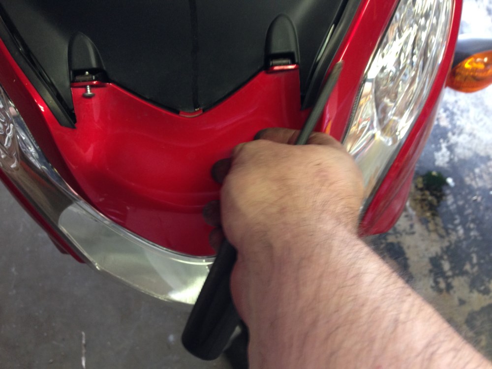

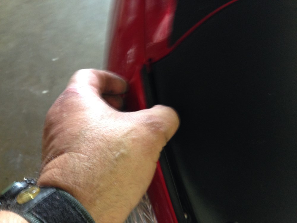

Here the windshield  is off, but the other parts were put back to show what has to be removed.

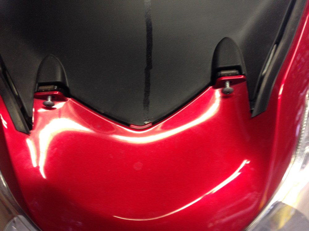

Remove the left side screw
Remove the right side screw

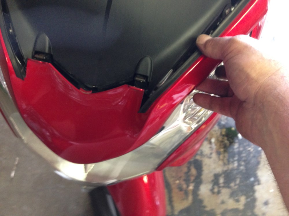

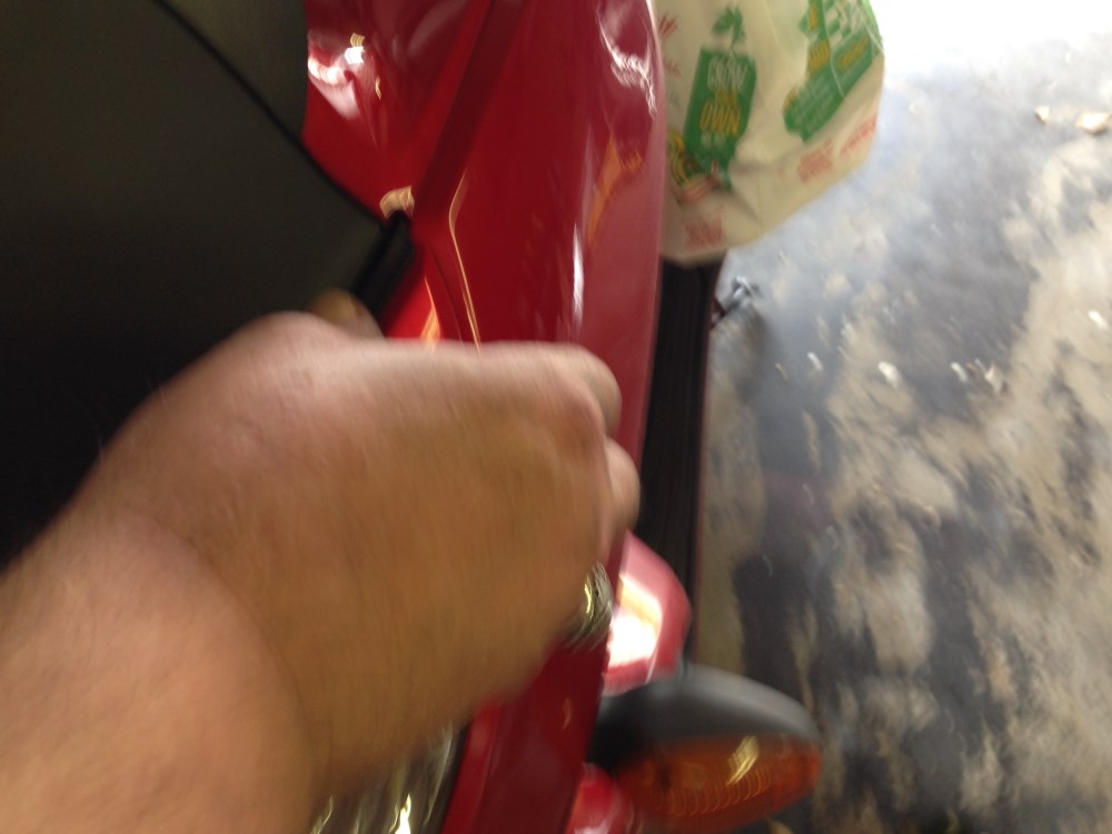

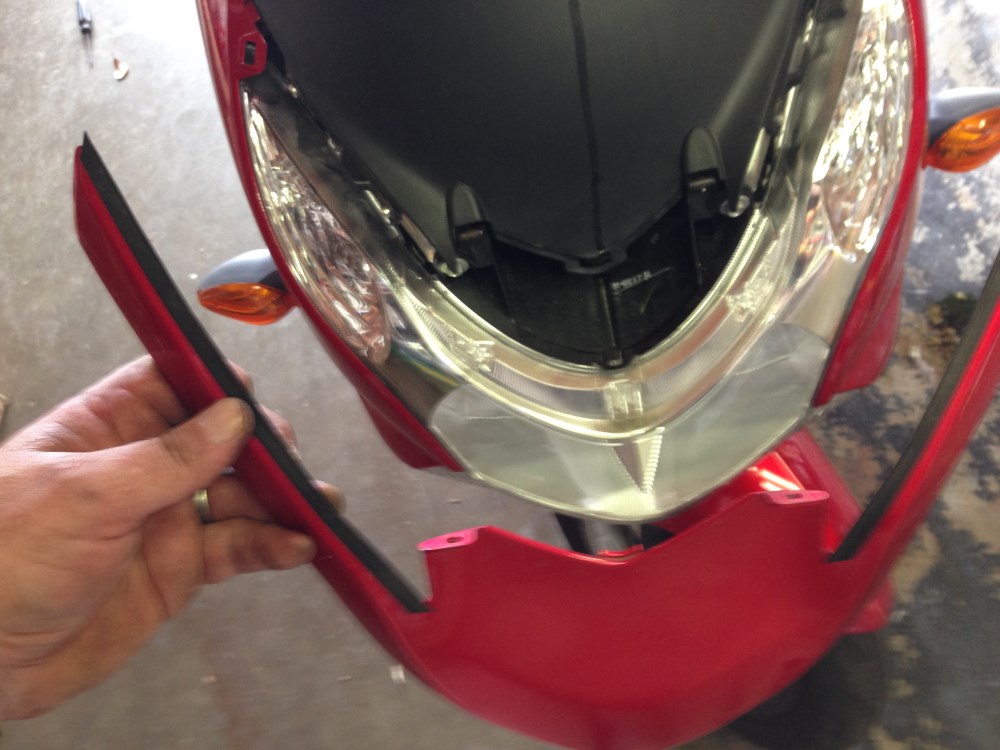

carefully unsnap the left side
carefully remove the left side
Carefully snap the left side clip out of its hole
Front cover removed
Front cover removed

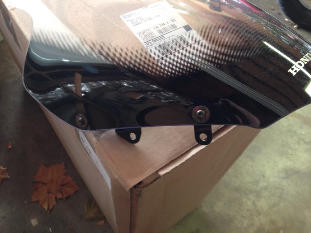

Frond of Honda PCX windscreen accessory
Right side of Honda PCX windscreen accessory
Left side of Honda PCX windscreen accessory
Rear side of Honda PCX windscreen accessory

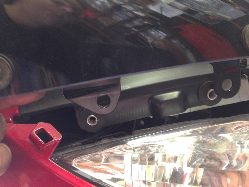

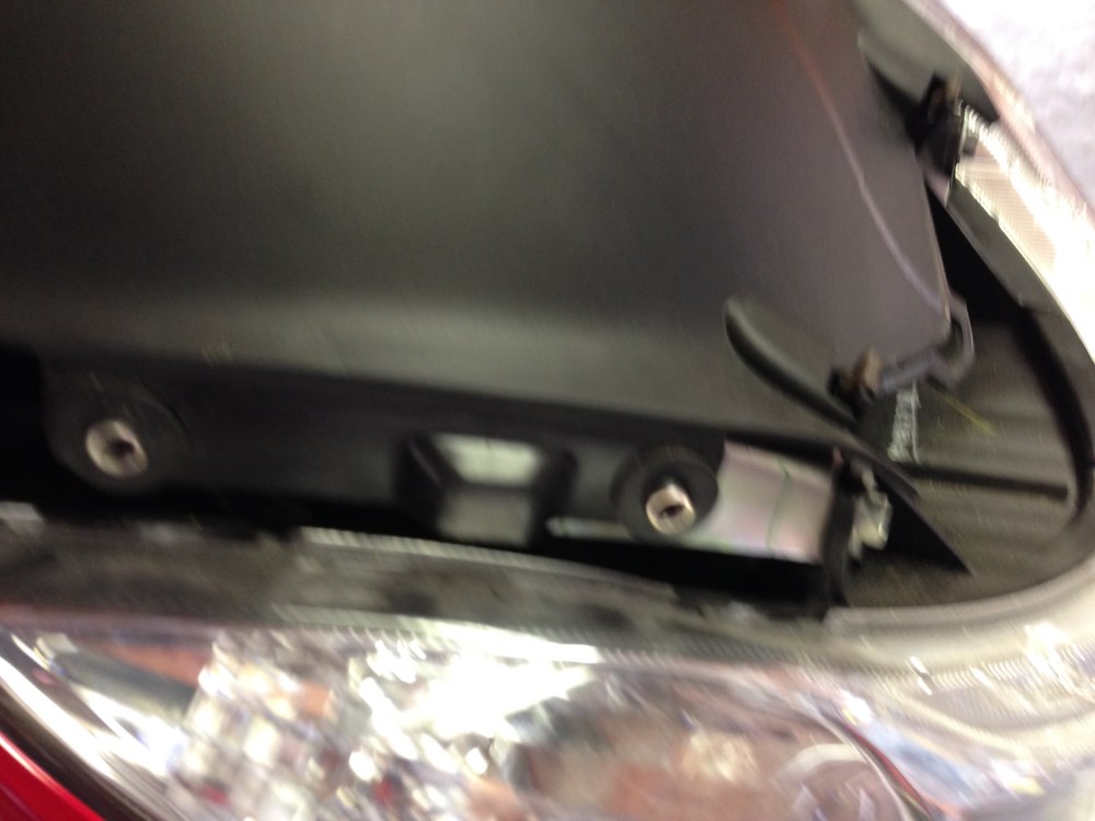

right side stock windscreen mounts
left side stock windscreen mounts

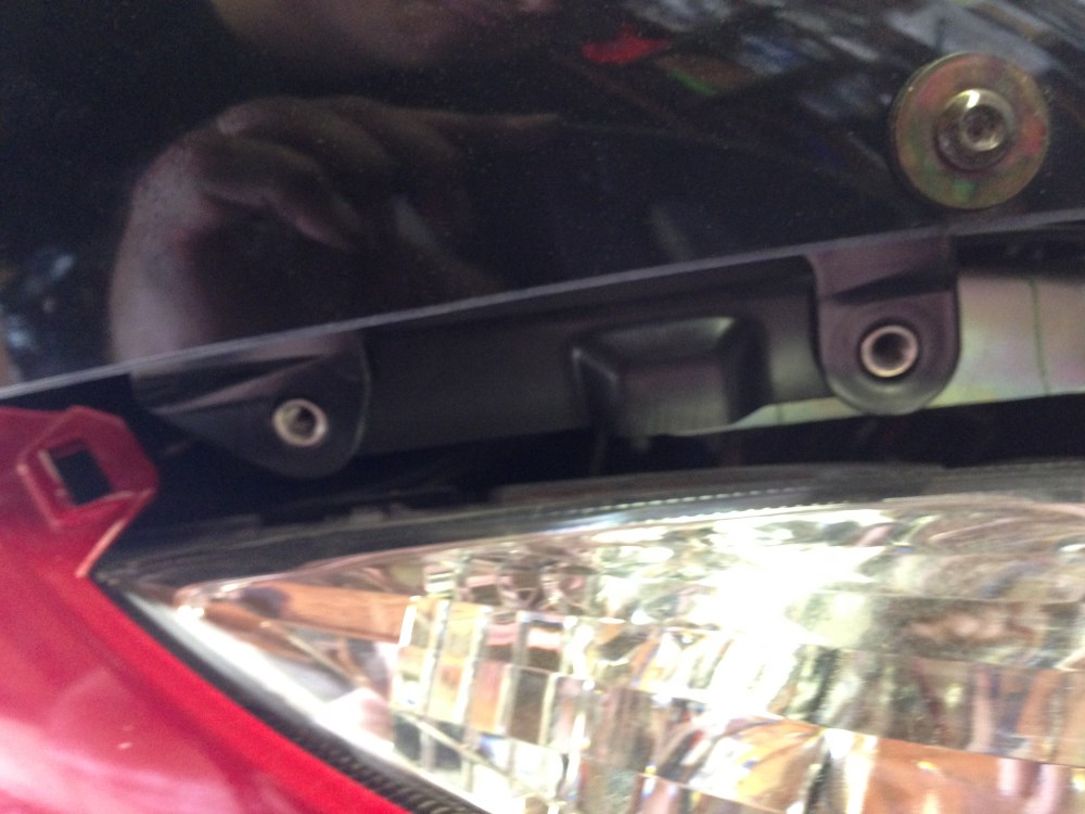

snap the windshield bracket in on the left and right sides
right side of mirror in place
left side of mirror in place

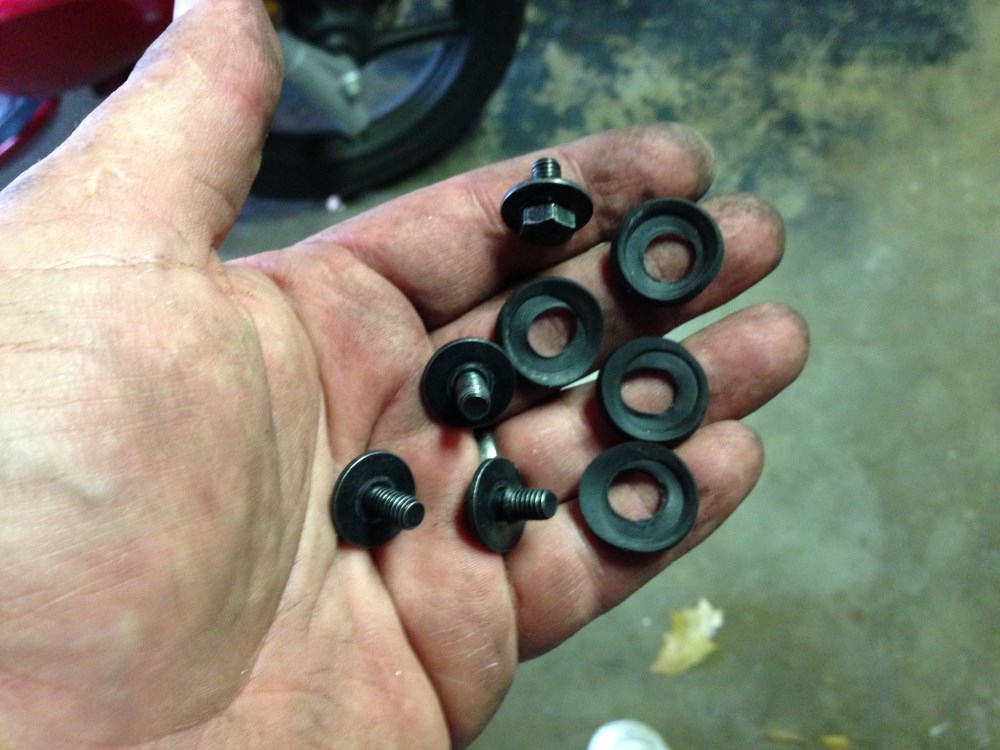

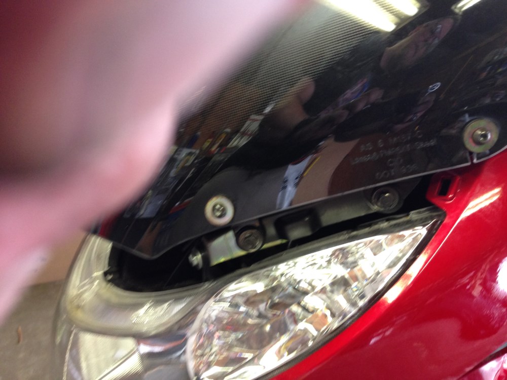

4 Bolts with rubber washers

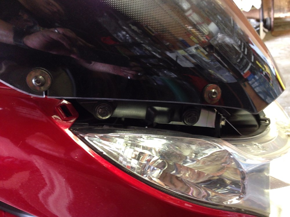

Bolt in the right side bolts
Bolt in the left side bolts
Snap in the right side of the cover
Snap in the left side of the cover and replace the two screws removed at the beginning.

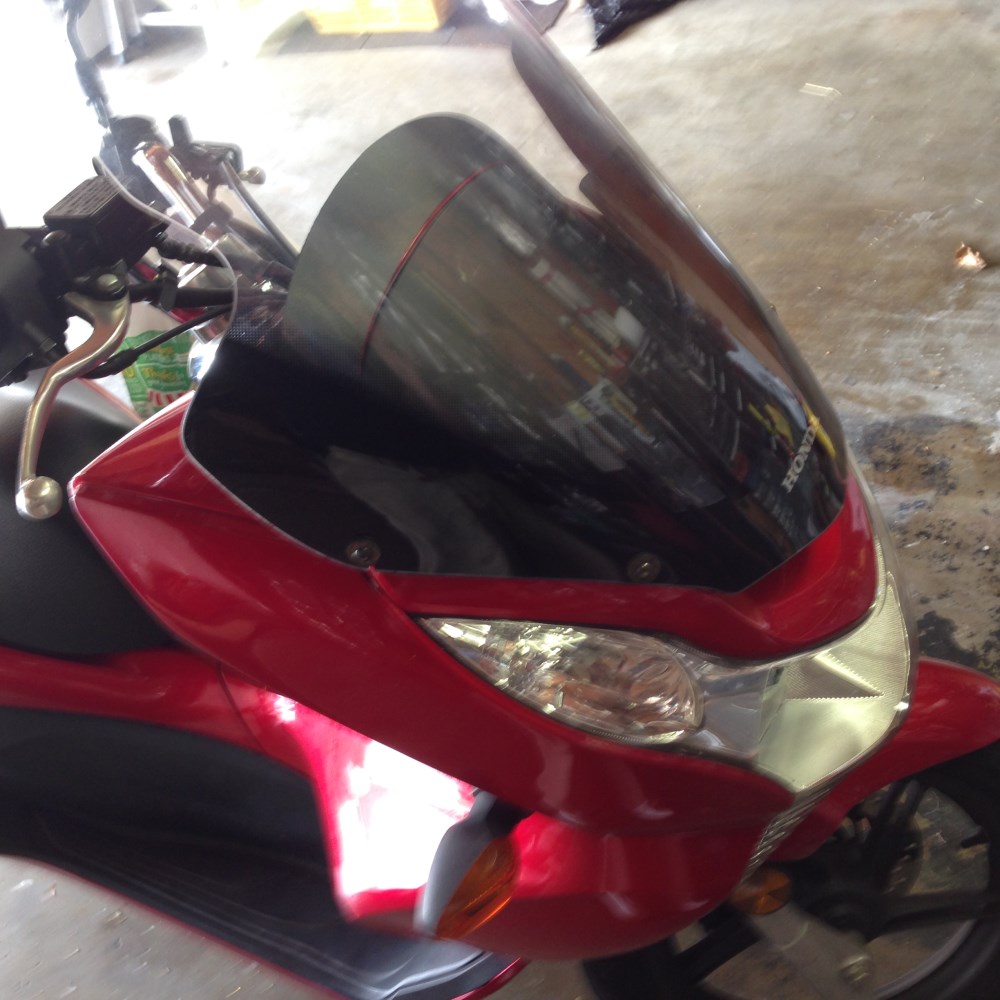

The installation is finished

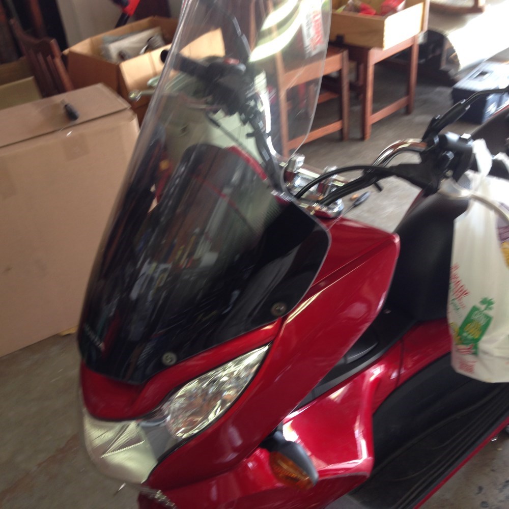

I look over it. I'm 6'1". If you look at the last few pictures, you will see that the screen is about 4 to 5 inches taller than the mirrors. If you wish, I can measure from the dash straight up to get the height and take a photo.

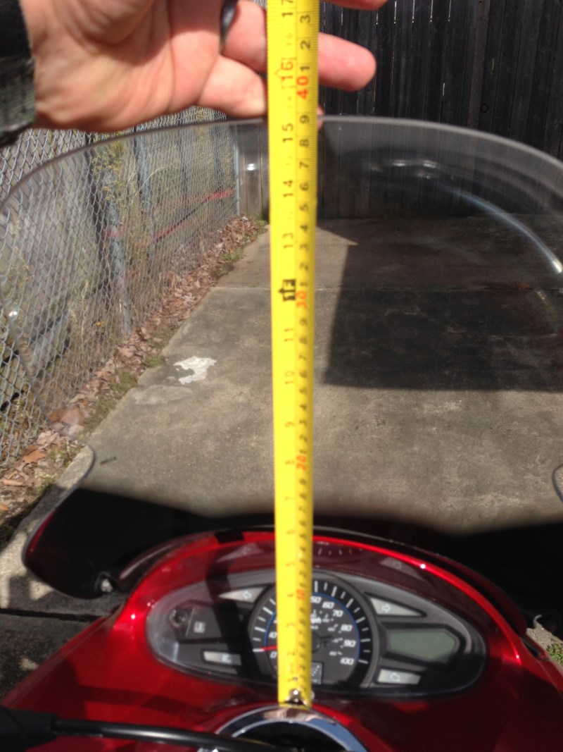

Indyglow wrote:
cfrobw wrote:I look over it. I'm 6'1". If you look at the last few pictures, you will see that the screen is about 4 to 5 inches taller than the mirrors. If you wish, I can measure from the dash straight up to get the height and take a photo.
Yes, thank you, that would help a lot. It's hard trying to figure out how high the screen is just by looking at the pictures.
According to my measurements its 15.35 inches tall from where the cover over the handlebar meets the dash.
See image below.
-Rob

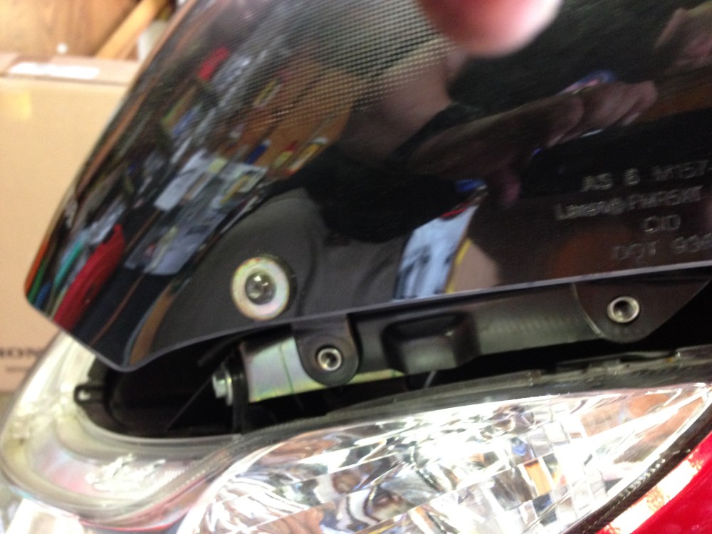

If I remember correctly, when I put our Givi windshield on, the holes on the windshield that line up with the windshield brackets was actually drilled through the Plexiglas itself, which means that the hole you had the problem with isn't as large with a Givi because it is closer to the body. My wife is only 5 ft tall but was getting buffeted when she had the smaller Givi windshield on, so we went up in size and now have the tall Givi windshield. She sees through it instead of over it, but the buffeting is gone.

Mel46 wrote:If I remember correctly, when I put our Givi windshield on, the holes on the windshield that line up with the windshield brackets was actually drilled through the Plexiglas itself, which means that the hole you had the problem with isn't as large with a Givi because it is closer to the body. My wife is only 5 ft tall but was getting buffeted when she had the smaller Givi windshield on, so we went up in size and now have the tall Givi windshield. She sees through it instead of over it, but the buffeting is gone.
Are you referring to the spot where the holes aren't lined up in the photo above? If so that's just because I was showing them in the picture before I hooked it to the mounting points. It just hooks right in and you re install the bolts.
