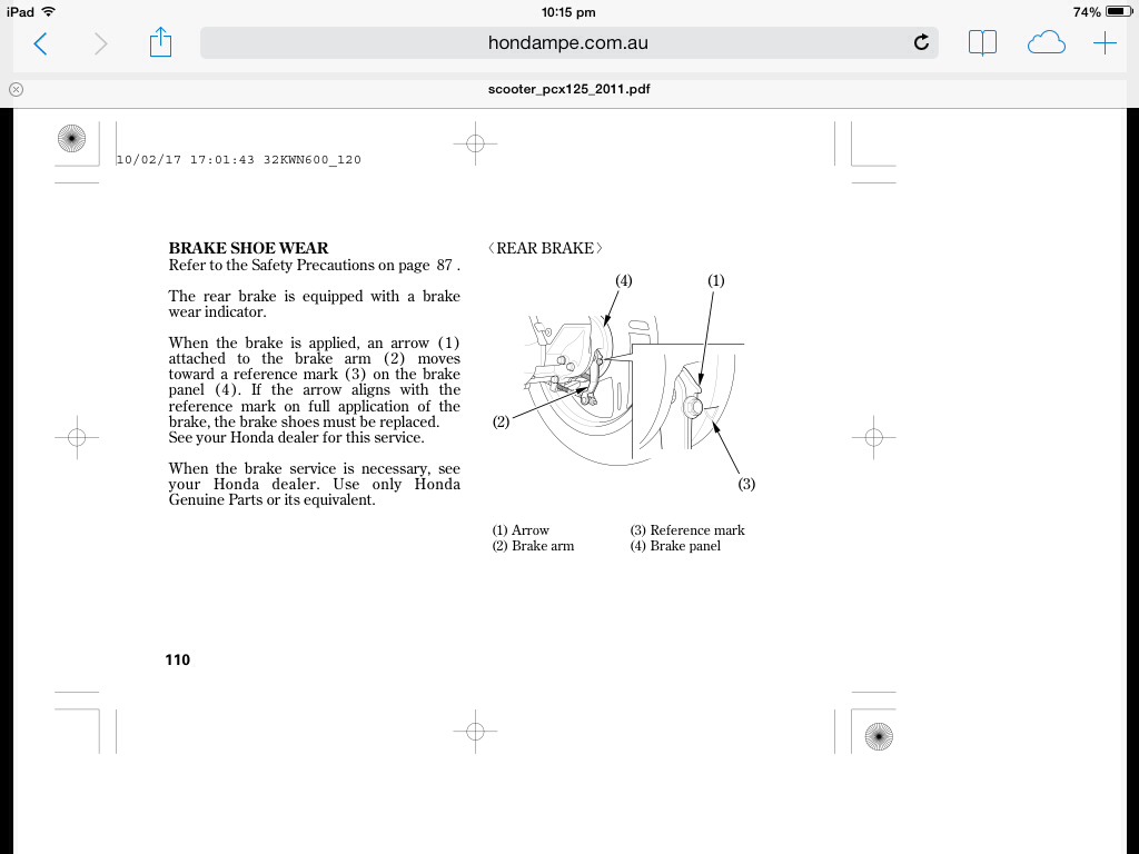

New to this forum. Couldnt find one on brakes. I was surprised. I think I could do it but it would be nice to have the imput of someone who has done it prior to starting. Im at 7700mi and its time for a change. Back brakes are getting squeaky. Any help and pics would be appreciated. Thanks

Is the wear indicator arrow on the rear brake lever pointing at the low brake lining indicator.
Re: request for a brake change how to
Squeaky is fine, brakey no worky isn't so good
Mine always squeaked when the weather was wet.
Post by Alibally »
Page from owners manual.
