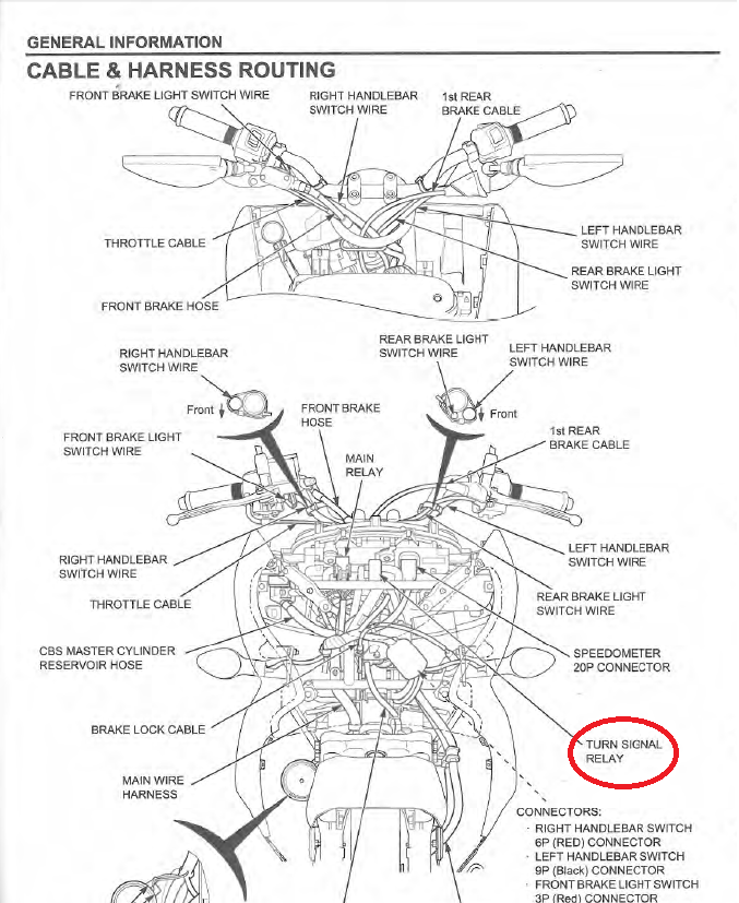

where is the flasher for the turn signals im looking at swapping to leds and i need to find what flasher i need
DISOBEDIENCE CREW
Re: flasher location
The proper term is relay. ;) It's up front, underneath the windshield cover.
A pic is worth a thousand words:

no clue on the hazard question but thanks so much for that and is it just a basic 2 prong

Hi Maddiedog. Yes, your picture is worth a thousand words. Bought a beeper flasher relay (guy at the shop said it should fit the PCX) when I was on holiday in Penang last month but had wondered where the relay was located on the bike. Hope to replace the relay this weekend.

I own a 2014 PCX. Does anyone know where the turn signal relay is located?
I tried to install an alarm and now the left turn signal is always blinking. I removed the alarm but the problem remains.
I imagine the relay needs to be replaced but I can't find it. Also, anyone know what is that "box" in the front (it has "k35a" printed)?
Thank you

ruidalves wrote:I own a 2014 PCX. Does anyone know where the turn signal relay is located?
Thank you
That "box" is the led control unit, the relay might be in that "box"? I don't have a led control unit, and I'm using a led relay 3 pin style for my 15 headlight.

Pretty sure now (thanks whitenoise for the pics and info) you will need a new led control unit for your flasher problem...
cheapcycleparts.com has it listed, but no price/availability :(

So the 2014 pcx doesn't have a stand-alone relay for the turn signal lights like the previous versions?
Thank you all for your help.

ruidalves wrote:So the 2014 pcx doesn't have a stand-alone relay for the turn signal lights like the previous versions?
Yes, No stand alone relay for the new model.
But maybe you can bypass it with older style relay, like I said my signals work fine with a led relay(they just stayed on with the stock 13 relay).
