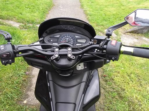

so i bought em and installed em they actually look way lower actually and reach is comfortable

Re: wanting to change out the bars
mikelx5 wrote:so i bought em and installed em they actually look way lower actually and reach is comfortable
Can you post a pic?

here not best pic but shows it well
bars 2.JPG (98.92 KiB) Viewed 4664 times

Which bars are those, they look lower than the 4"rise ones.
Like the carbon too 8)

Those are the ones lol im loving em

Did you change out the bar clamps, too? They look different.

What are the extra bits on the bottom of the handlebar clamps?

the extra bit is for a navi i think but not sure, im gonna mount my clock there i think
