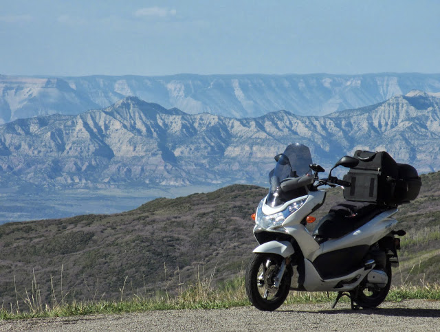

Thanks, folks. There are a number of photos I took, a few are included below. It was a truly an awesome adventure which I'll write more about soon. There were just so many states, beautiful landscapes, wonderful places, and people I met that I can't contain them to a single post, but I'm in the process of writing this down...
