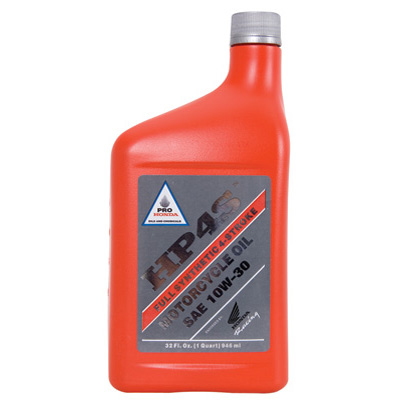

This is what I use...
- oil.jpg (29.52 KiB) Viewed 7681 times
