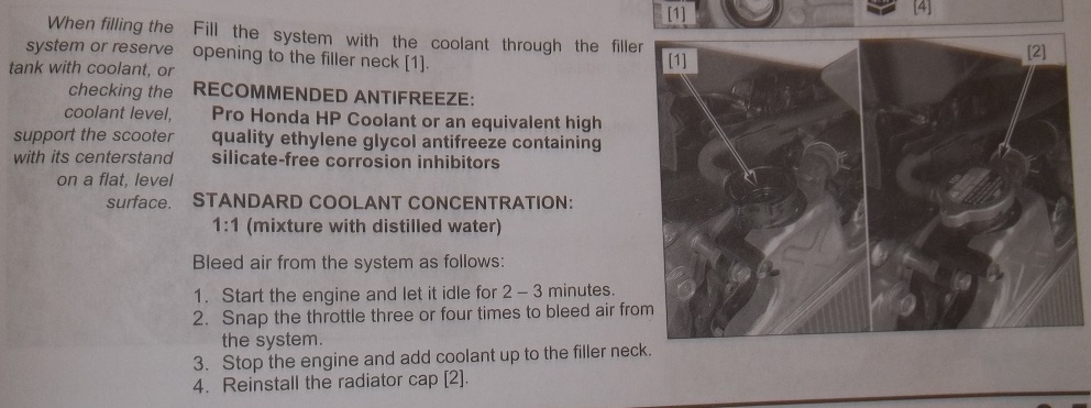

There is need to bleed the air from the coolant tank following this procedure. Not sure if failing to bleed air in the coolant system would trigger a temp light but do it by the book anyway. What it doesn't say is if you run engine and snap throttle with the cap on or off
The SM assumes some common sense.
- system bleed.JPG (198.94 KiB) Viewed 19442 times
