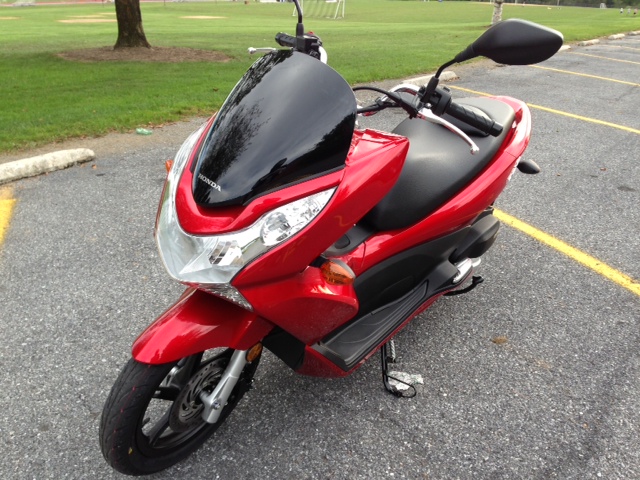

So I posted a few weeks ago about the best time to buy – well, I went ahead and did it on Friday! I didn’t get anything off on the MSRP, but I got a fair price on my trade (2006 Buddy 125). I am really enjoying the PCX- I already have 60 miles on it and I drove it to work today. I guess I am anxious to get past the 300 mile break in and perhaps get to the 600 mile service prior to putting it to sleep for the winter (my dealer quoted $136 for the first service). If I wait till the spring for the first service and it sits all winter before that, would that be ok? The PCX 150 is a step up from the Buddy I think – I really appreciate the design, and fit and finish (something as simple as the bigger mirrors makes it much nicer to drive). It’s also more stable on the rural roads where I live. Anyway, thanks everyone for their advice on the forum! The first issue I had was I couldn’t get the seat closed – I searched on the forum and discovered I was doing it wrong! I can't however figure out how to get the parking brake to engage - is there a trick to that?

The parking brake can be finicky, read the manual and try it a few times. My dealer showed it to me and struggled making it work before I purchased mine. I dont use it so I cant give you any of my experiences. If you want to save the $136.00 for the oil change, there is a section called "how to" in this forum that has pictures and a step by step guide showing you how to do it. Make sure you use the oil reccomended in the manual that is detergent free. Congrats on your new PCX :D
Oh, and at 600 miles, take a wrench or socket to all the bolts and make sure they are tight. I did not find any loose but one cant be too safe.

The parking brake is a joke.
I dont think it was designed to actually be useful. :lol:

The parking brake operation requires a properly adjusted rear brake. Spec is 10-20mm free travel. Mine was too loose so the p brake never worked. Have it set to about 15mm handle free play and parking brake works great!

Congrats from a (good) few miles away in NJ! As for the seat, I've found out I've ridden it with the seat unlatched (thinking it was), but never had an issue. As for the parking brake, I set the tightening bolt (left side of the rear wheel) so that the brake works, but haven't actually used it. Honestly, I'm not really sure of an instance where I would use it, since I park my 150 on the centerstand anyway.

Congrats :D , I didn't think you would get much off msrp...:x , if your rural roads are anything like mine, bigger tires make a huge difference in feel/stability. 8)
Oh yeah just get rid of the parking brake, kinda useless.
