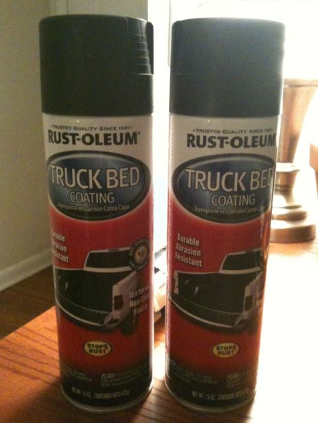

Rustolem makes a really good truck bedliner paint that looks great and is flat black.
Glad to finally see pictures. :D

I would love to paint the plastics with Bed Liner but it's pretty much a specialist coating and impossible to find in the UK for less than £25 for a small aerosol. :cry:

^ That's the stuff I used, it's about $7 a can over here from the hardware store. Give the bike a good wash, making sure to rinse an extra time to get all the soap off. Then, mask off anything you don't want painted and paint with the stuff. Two cans should give you more than enough coverage for ratty.
