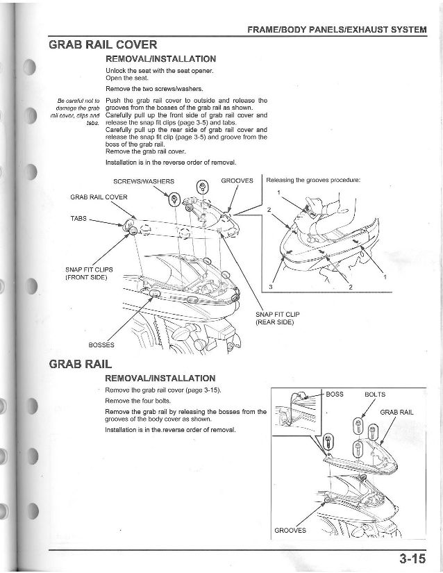

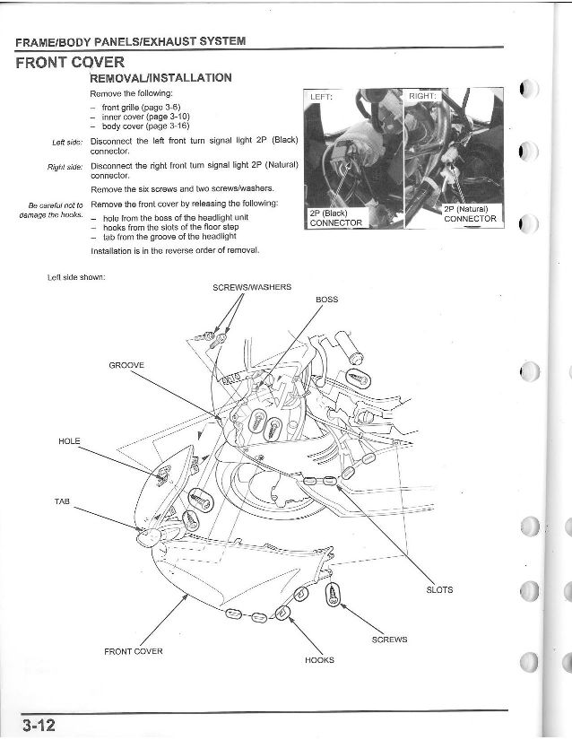

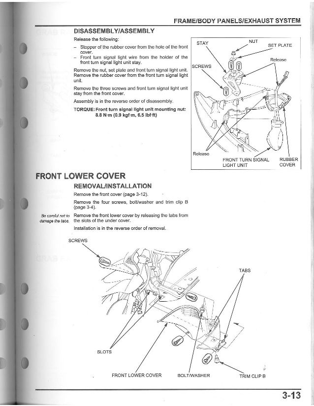

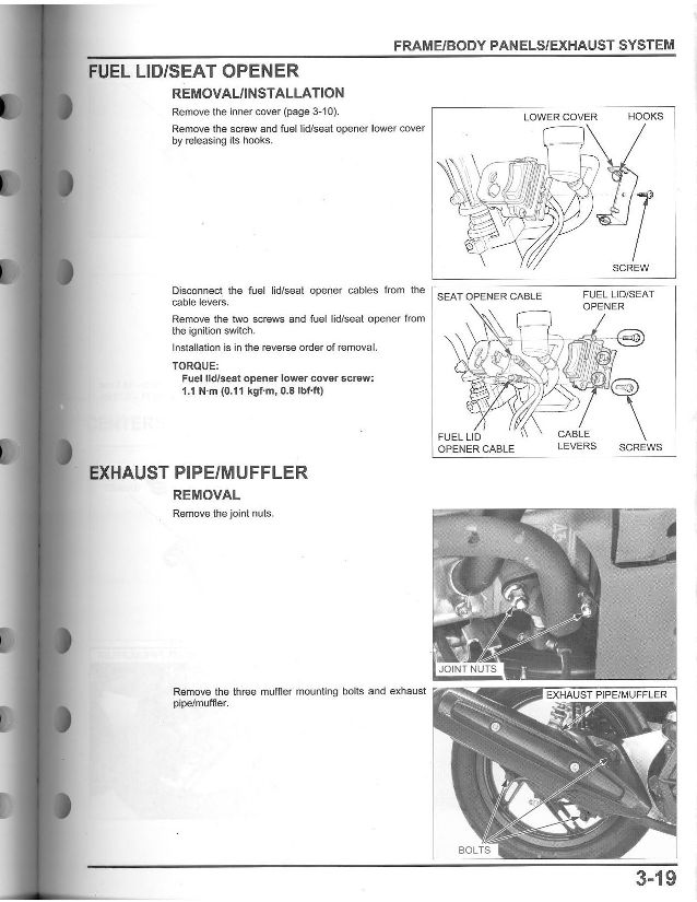

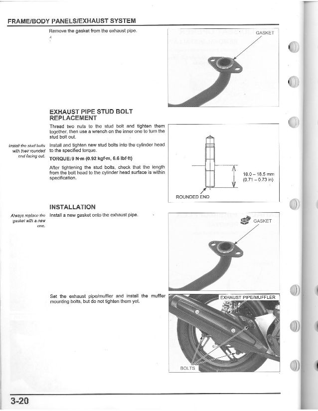

Hey Cookie! Thanks for the reply! I forgot about the minimum post count for PM's its either 5 or 15....
No problem on the file... I was asking on behalf of another member who is trying to do the same. Now that you mention back up... I might have the pictures in on my external hard drive.. I'll take a look when I get home and will post them here if found!
Given that I stand to gain no profit by posting these, and that these are posted for the sole purpose of educating the community, I think it is okay to post these here. If you are the owner of this work and have any objection, please contact me immediately and these pages will be removed.
Enjoy, and thanks to EddieC for providing the manual.
Currently ride: Nothing right now - mostly mountain biking with my boys until they're old enough to ride Previously rides: 2011 Honda PCX 125, 2005 V-Strom DL650, 1974 Vespa Ciao, 2011 Honda PCX 170 (tons of mods - takegawa 170cc big bore kit, gears, etc), 1996 Honda Nighthawk 250, 1987 Honda Spree, 2000 KTM 125SX, 2003 Honda Silverwing, 2007 Genuine Buddy 125, 1998 Honda PC800, 2008 Buddy 125 (white), 2008 Buddy 125 (red), 2001 Honda Reflex, 1987 Honda Elite, 1988 Honda Spree, 2007 Yamaha Vino, 2007 Honda Metro, 2x 125cc pure-chinesium dirt bikes
Service manual for the PCX. We have the whole thing, and can upload small portions as needed in low-resolution (like above) under fair use copyright rules. I encourage anyone to buy them so that you can have higher resolution images, you can get them through your Honda dealer or online through Helm, at helminc.com.The publication number is 61KWN00, 2011 PCX 125 Service Manual. The cost through Helm should be $36.
