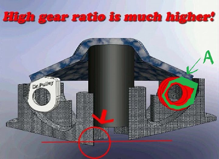

dasshreddar
Posts: 755
Year: forzaruckuspcx
Re: CVT mods for PCX 150?
Post by dasshreddar »
DOH! :oops: I did have them in wrong, I put them in this way . see A
not sure why they actually seemed to work for as long as they did??? :roll:
my belt is right around 21.5mm and I only have about 900miles.
I only did a stand test, but now i'm hitting the rev limiter at 73mph 8)
i'll post up a road test when I get a chance.
dr a.jpg (99.15 KiB) Viewed 12902 times

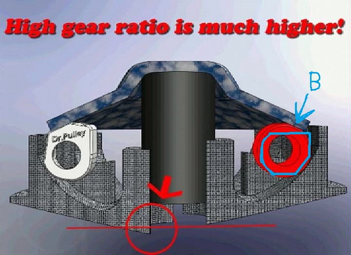

dasshreddar
Posts: 755
:ugeek: interesting side note, I put them in this way by accident. see B, and hit the rev limiter at 57mph.
I imagine you could put them in a bunch of different ways for different rev limits ;) :)
