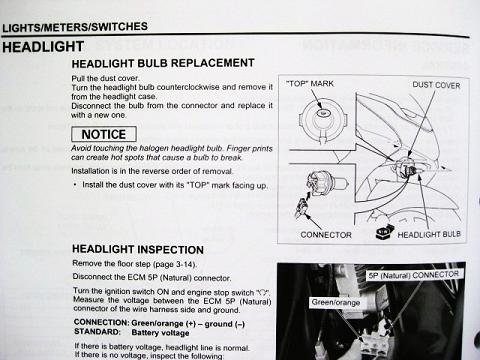

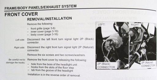

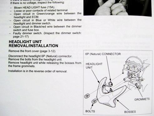

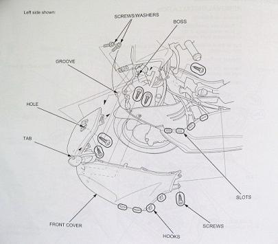

Here are a few manual snips that might help you (sorry, for the so-so quality)
Haven't done it myself, but in NY law states we are good to go with modulators, back and front. Good safety idea imo, and worth looking into before the mod (o;
- Front Cover 1.JPG (39.34 KiB) Viewed 8678 times
- Front Cover 2.JPG (33.22 KiB) Viewed 8678 times
- Headlight 1.JPG (51.51 KiB) Viewed 8678 times
- Headlight 2.JPG (45.73 KiB) Viewed 8678 times

I appreciate the feedback. They are legal in GA. It has a light sensor, so only works in daylight- not night, which would be illegal. It doesn't draw any more current, only oscillates from a bright to dim shine. I will put pics of the Modulator- it is from Signal Dynamics and I got the dual harness with it since the PCX has 2 bulbs. I can feel get the rubber boot off, but cannot turn the light assembly to pull bulb and all out, nor can I feel how to unclip the wires. I really don't want to pony up the money for a shop to do it- much less a dealership. I have no confidence in taking any of the panels off- when I was installing a break light modulator, I cracked the piece that has the passenger grips. I had to buy some JB Weld epoxy for ABS plastic to repair it...so really don't want to break anything else.
