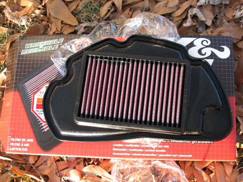

I opened up the box and took out the filter:
The air filter is designed to last the lifetime of the vehicle, or is guaranteed to last 1 million miles, whichever comes first.

Here's what the stock filter looks like next to the K&N filter. As you can see, the K&N filter has larger ribs and more surface area for air to pass through, theoretically increasing airflow, and therefore performance and/or efficiency.
The stock air filter's filter component's dimensions are 5.25" wide by 3.25" tall, or just over 17 square inches.
The K&N filter provides more cross-sectional area than the stock air filter -- about 5.5" wide by 3.5" tall, or just over 19 square inches.

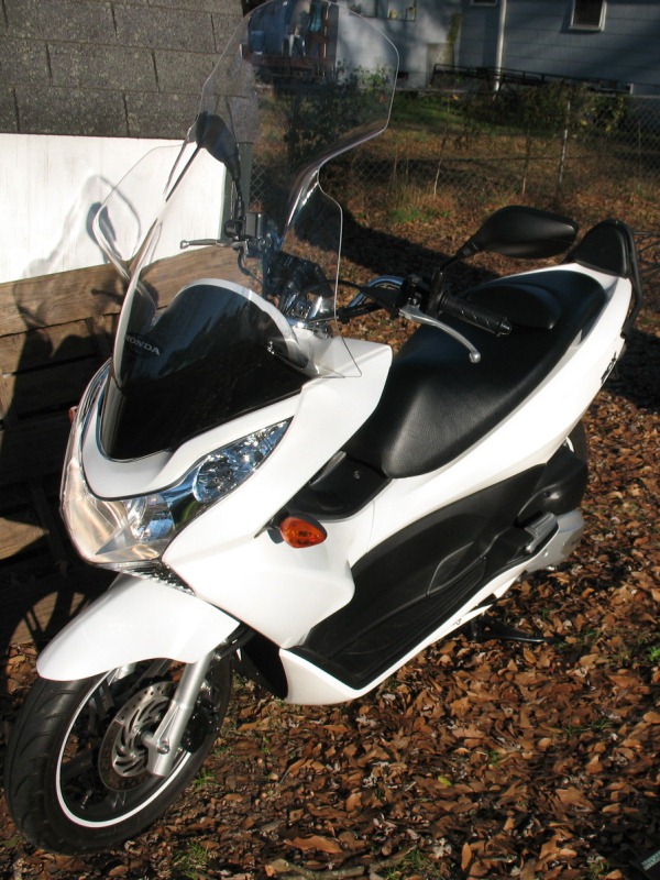

The test platform, my PCX:

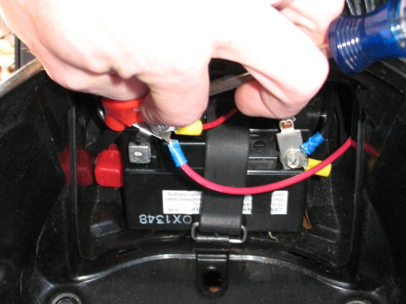

In addition, it has been mentioned before that, for the ECU to remap, the battery would have to be unplugged. To ensure fairness, I unplugged the battery for 5 minutes before the initial tests with the stock filter. Then, I ran the 6 tests with the stock filter, changed out the filter for the K&N filter, unplugged the battery for 5 minutes again, then ran the 6 tests with the K&N filter... Battery unplugged:
