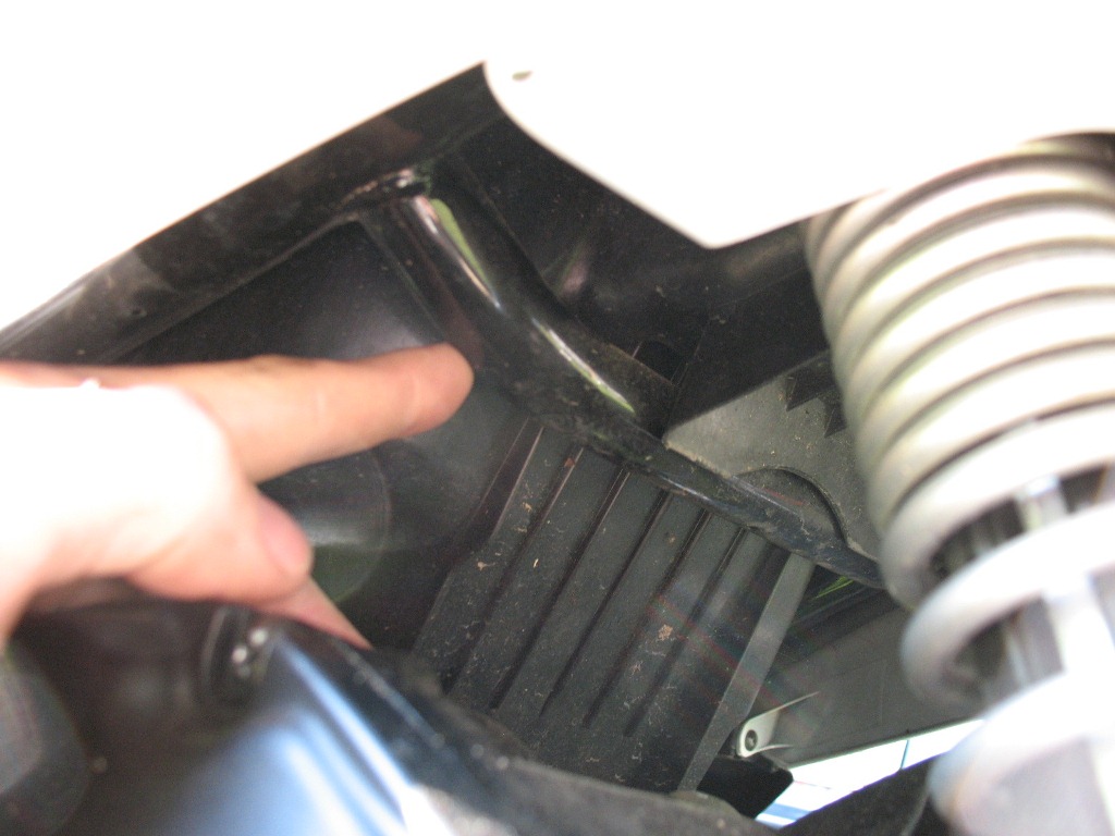

Good info on this in the how-to here: http://hondapcx.org/viewtopic.php?f=3&t=319
Kim is right, you should NEVER have the bike on the kickstand, and especially shouldn't have it on the centerstand. You probably will break the engine casing with regular hauling on the centerstand -- it is NOT designed to do that.
Secure the rear right here:
http://hondapcx.org/download/file.php?id=368
^ That's a strong frame component.
If you don't understand how to secure to a trailer without the stand, reply again and I'll make a video specifically for the PCX.
