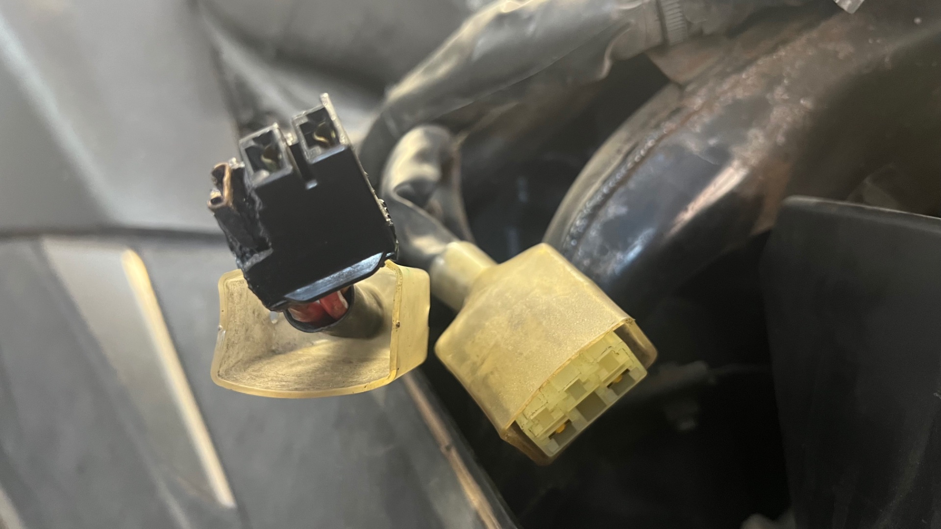

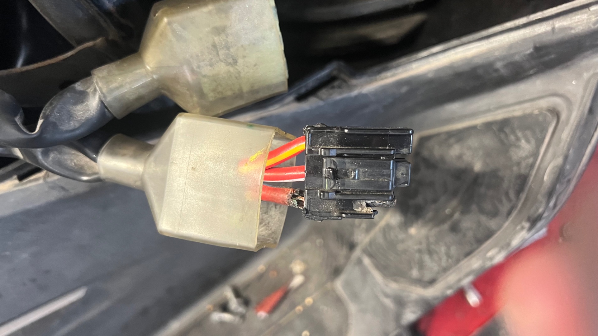

This is the problem it’s a frequently problem of pcx and forza
Can you help me watch is the name of connect and what is your opinion I change only the connector or all the stator
The stator is so expensive
