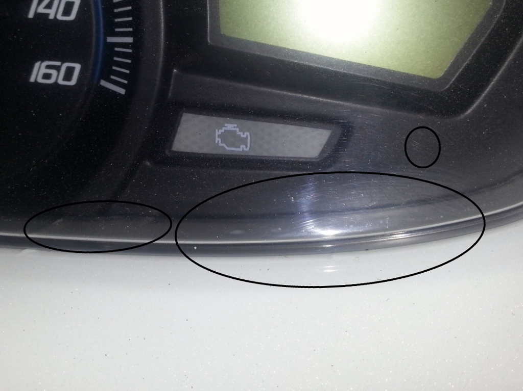

Here is a photo. teh most visible are those droplets like in the bigger oval
- Here is the photo. Not so clear but in direct sunlight very visible

Re: Condensation behing speedo glass.
Going for the replacement. After wondering that the problem would eventually persist and a removal would be the only choice i would be Better off with a new Speedo. Even the pcx willl be "new" since milage counter would come to 0 mles with the new replacement speedo.
