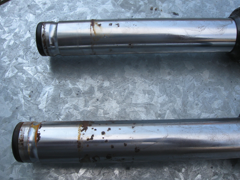

But... what exactly happened to your fork legs, GN2?. Are they bent, rusty or what's the problem?.
I'd like to see a photo of them, if you don't mind ;) .

Re: Forking hell...
They are rusty and leaking very badly.
Honda declined to replace them under warranty.
Will take pics tomorrow.
I know the type of protector you mean yy, but the rust is all round the fork and mostly at the top.
The yoke is totally brown with rust.
The brand new second hand ones look to be perfect and were a bit of a bargain at £70 delivered.

Here are my rusty old forks:
Rusty forks
Rusty forks
the horror... the horror...
