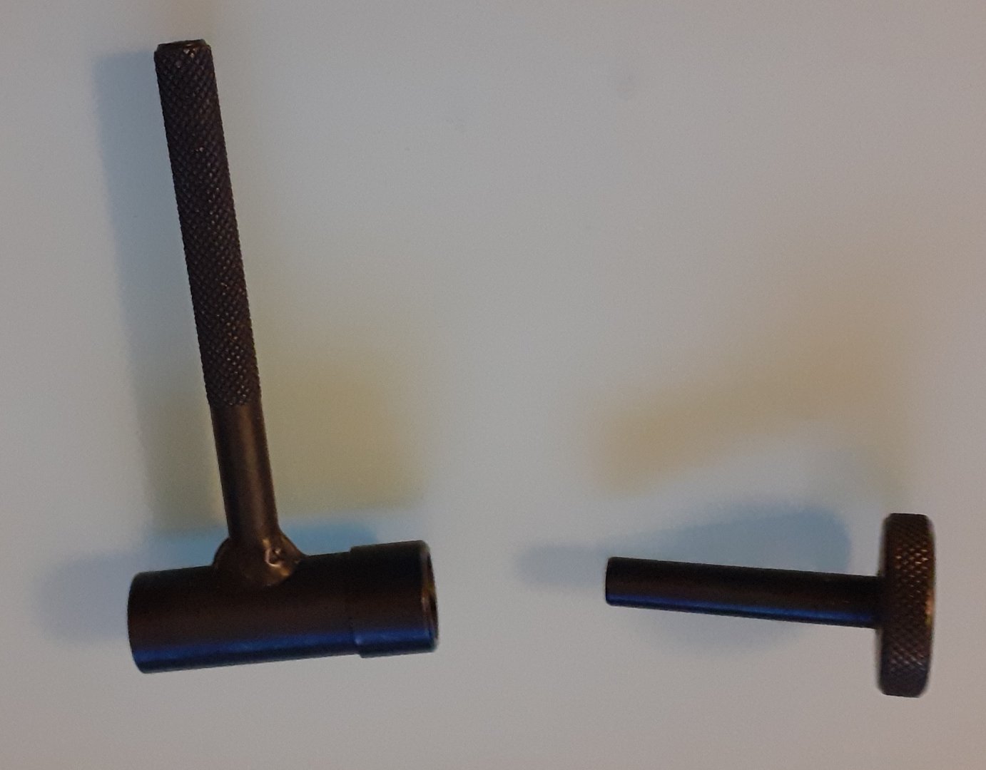

Can someone please advise on the locking nut and square adjuster size on the 2012 PCX150 inlet and exhaust valves. I want to order a tool from Amazon, some list a 9mm nut/3mm square and others 10mm/3.5mm.

Oh something like this? It took me only ~24hrs to fetch my valve adjustment tool out of my toolbox, take this picture, upload it and place it in this response.
valve adjust tool.jpg (119.37 KiB) Viewed 10373 times
Now let me go and look for my caliper :| Patience is a virtue - wait am I on 'insta' board ?!?
The official tool as per the service manual can be found at https://www.partzilla.com/product/honda/07908-KE90200
Wait for it...
one more teaser:
guess the size.png (14.18 KiB) Viewed 10372 times

I really cant find my caliper so anyhow;
The square part is 3 mm.
valve adjustment wrench.png (16.28 KiB) Viewed 10349 times
