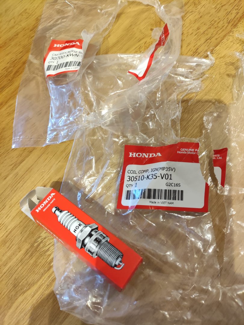

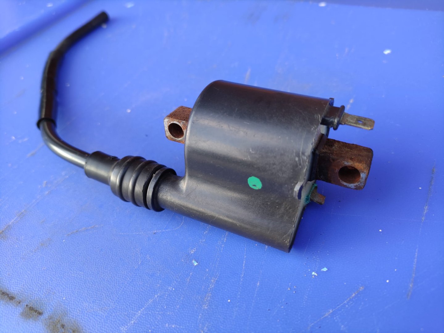

My 2014 JF57 with 82.00Km is experiencing the same behaviour you describe and after a deep inspection last weekend I have identified a broken pin on the ignition coil (it was just bent before) plus the spark plug top cap broken.
Parts has been ordered today and soon I could let you know the outcome if could be of same help here.

Re: Rain stops the 2015 PCX150 engine.
Parts arrived and installed, I doubt will show again the same issue experienced before but only a ride under rain will confirm, but I'm confident should be resolved.
- WhatsApp Image 2023-04-20 at 18.09.25.jpeg (151.96 KiB) Viewed 7879 times
- WhatsApp Image 2023-04-20 at 18.09.25 (1).jpeg (168.93 KiB) Viewed 7879 times
- TheDoors
- Posts: 43
- Joined: Tue Jan 28, 2020 6:11 pm
- Location: Ireland
Tested today under rain, no issue at all and has as expected a more fast response
