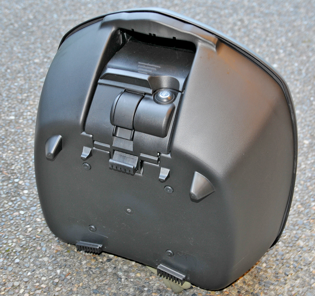

One more photo for clarity.
Honda SH300 rear rack and trunk base:
Trunk bottom:
Trunk bottom:

I may have mentioned in a different conversation about motorcycle training that my 16 year old daughter passed the safety course and now has a motorcycle endorsement on her driver license here in Washington State. She is already asking for the keys to the PCX. As part of her contribution to the family scooter she has surprised me with a Honda OEM trunk she ordered and purchased from our local Honda dealer. It is listed as 35 Liter, part number in the U.S. is 08L77-MGS-A50ZA. She said only all black was available.
Here is a picture of it mounted on the OEM rear trunk base: And here, khaosaming, is the bottom side view of the trunk that my daughter purchased - it indeed looks identical to yours:

---------------former50cc wrote:...she has surprised me with a Honda OEM trunk she ordered and purchased from our local Honda dealer. It is listed as 35 Liter, part number in the U.S. is 08L77-MGS-A50ZA. [...] ...it indeed looks identical to yours...
Thanks! Q.E.D. -- quod erat demonstrandum.
