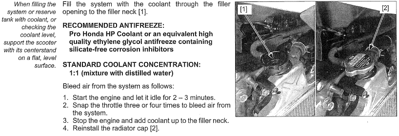

This is what my SM states:
bleeding air coolant.png (117.63 KiB) Viewed 2665 times
Last time I did it this way it worked out perfect. The first ride I took, I did carry some additional coolant under the seat - just in case. I had to add a little extra as the level went down again (so not fully bleeded by the SM procedure it seems).

Above SM is for 2013-2017 PCX version but I guess its the same for 2020 ;).

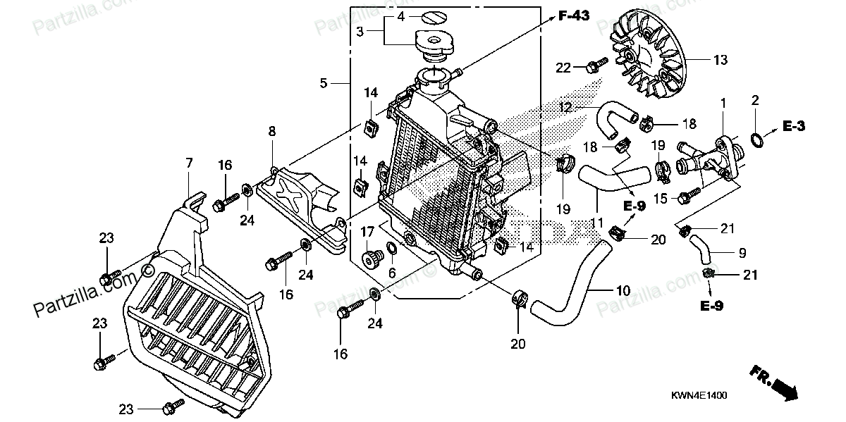

So, when watching Mitch’s Scooter stuff video on YouTube about this: https://m.youtube.com/watch?v=4oNMirMiJls he bleeds it out from the CYLINDER DRAIN BOLT at the bottom.
I also found a service manual online for PCX 2013 that shows this Image
Which I also notice at the top of the page on the old service manual
Butt,,, I guess you don’t really need to drain all of the old stuff out??
Good to see I can (probably) bleed with the radiator cap so thank you!
But I’m still not sure where to find the cylinder drain bolt on my 2020.
I thought I found it where it was shown, but I could NOT untighten it for my life and got too scared because I also don’t have the replacement O ring
I’ll go take a picture of MY scooter today so someone can see better.
He drains from the drain bolt. Bleeding is done trough radiator cap to expell any air bubbles within the radiator or other areas within the coolant system. Also do not worry about the o-ring it will probably still be fine, just like the ring on the exhaust which according to the SM should be replaced each time you take off the exhaust - I have taken mine off already 5 times without replacing it and all is still fine.
